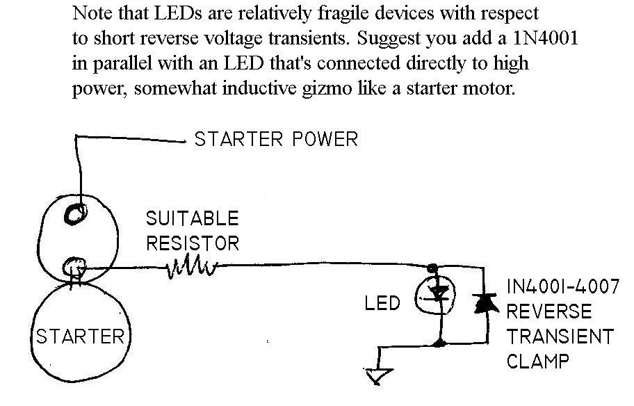

PostPosted: Fri May 02, 2014 3:40 pm    Post subject: Re: How do I prevent starter engaged LED from failing? Reply with quote
Bob et group,
In wiring a starter engaged annunciator, I am using an off-the-shelf LED fixture with an appropriate resistor already integrated into it. The resistor is actually soldered directly to the LED lead inside of the fixture.
The two attached diagrams from the archives differ in how the diode is added. (I put a 1A inline fuse where both of the attached drawings shows a resistor.) In either drawing, it won't be possible to place the legs of the resistor outside of the legs of a diode in my LED circuit with the integrated resistor. Is that going to be a problem?
Would one circuit drawing be preferred over the other?
Thank you,
Eric Schlanser
Z13/8 project
Lyc O320 with Skytec 12V HT Wound-Field starter and auto style starter contactor
I think I remember reading if an LED is used instead of a bulb for
starter engagement indication, that you best add a diode to prevent
the LED from getting hurt when power is removed from starter motor.
Where does the diode get placed, in series with the LED or in parallel?
Either would work . . . but parallel is preferred.
If answer is in parallel where would the dropping resistor for LED
get placed, between the legs of the protection diode, or outside?
Outside
Bob . . .[/quote]

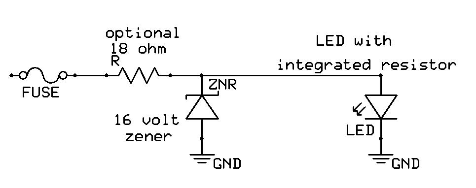

user9253
Joined: 28 Mar 2008
Posts: 1948
Location: Riley TWP Michigan
PostPosted: Sat May 03, 2014 6:31 am    Post subject: Re: How do I prevent starter engaged LED from failing? Reply with quote
If I understand correctly, you are asking if a protection diode has to be connected inside of the LED fixture at the junction of the LED and integrated resistor.
No it does not. It can be external as in the attached drawing.
Joe
 Filesize:  34.19 KB
 Viewed:  5624 Time(s)
LED.pdf
Download
 Filename:  LED.pdf
 Filesize:  7.17 KB
 Downloaded:  514 Time(s)

PostPosted: Sat May 03, 2014 1:02 pm    Post subject: Re: How do I prevent starter engaged LED from failing? Reply with quote
Eric,
I am not knowledgeable enough about the characteristics of a starter motor to answer. In my circuit, any diode, zener or not, will short out a negative voltage. A 16 volt zener will short out any positive voltage above 16. Attach your latest circuit idea for others to comment on.
It would be interesting to learn more about starters, any induced voltages during normal operations and also the voltage output and current capabilities of a starter that remains engaged with the engine after starting.
Joe
