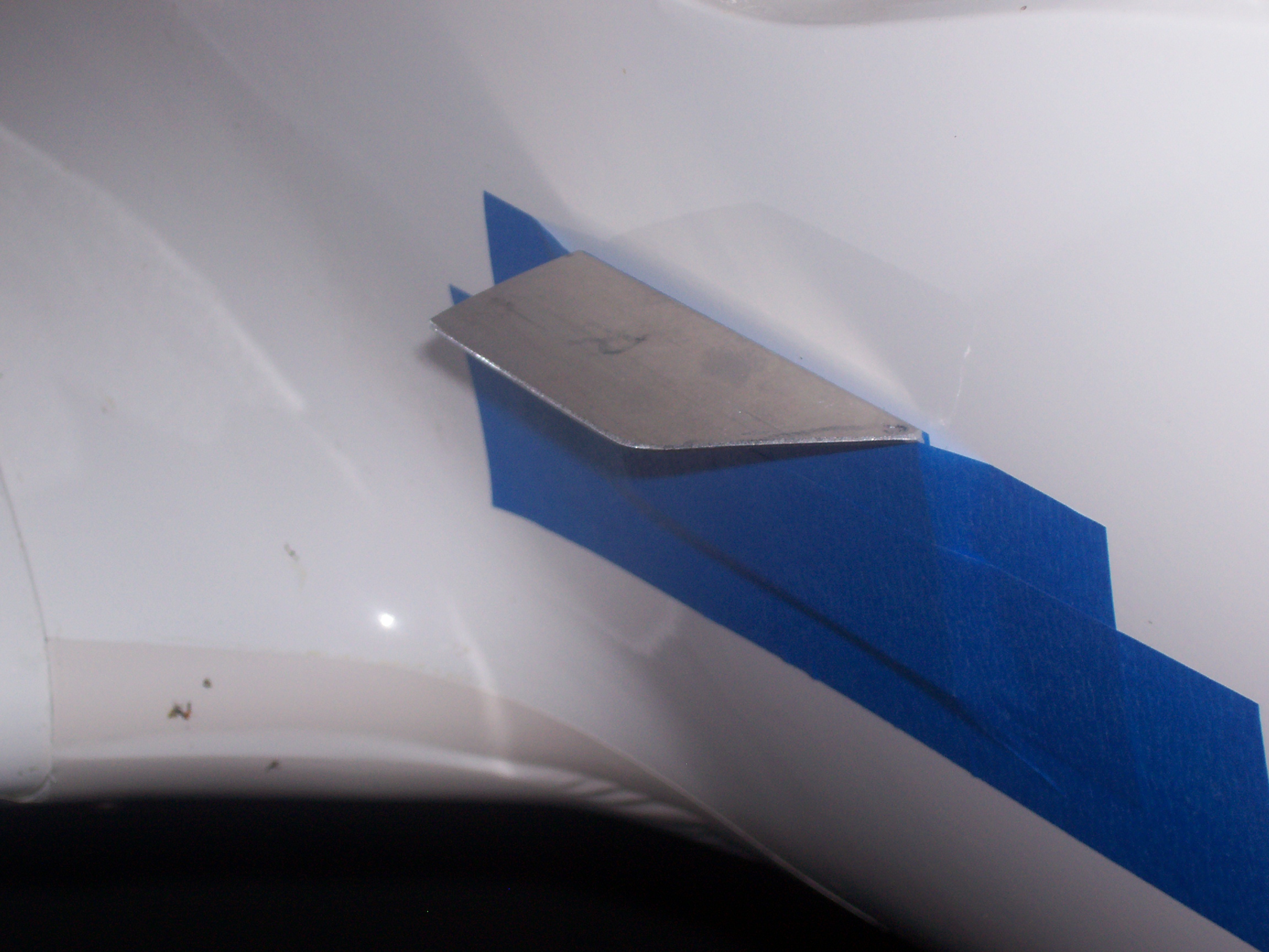

{Response} There are really two aspects to the problem of loss of / suddenly
reduced pitch authority in the KIS TR-1 landing flare. One is elevator
authority (as you write) and the other is the airflow burble generated by
intermittent airflow detachment in the pinched in area of the wing to
fuselage fairing.
The elevator authority situation can be approached (as you write) with
either extending the elevator trailing edge or several small vortex
generators installed on the bottom of the trailing edge of the horizontal
stabilizer.
The airflow detachment situation can be approached by either building and
installing larger wing to fuselage fairings as Julian Bone did or installing
a vortex generator on both sides of the fuselage just forward of the wing
leading edge as Cirrus -- and some RV-8 builders -- have done with their
later models. This would create some higher energy air in that pinched in
area.
I am playing around with imitations of the Cirrus approach -- see the
attached picture of a temporarily attached vortex generator. I think that in
order to refine / validate this fuselage installed vortex generator approach
one would have to install video cameras and do some airflow testing with
yarn tufts. That is a bit beyond my motivation.
