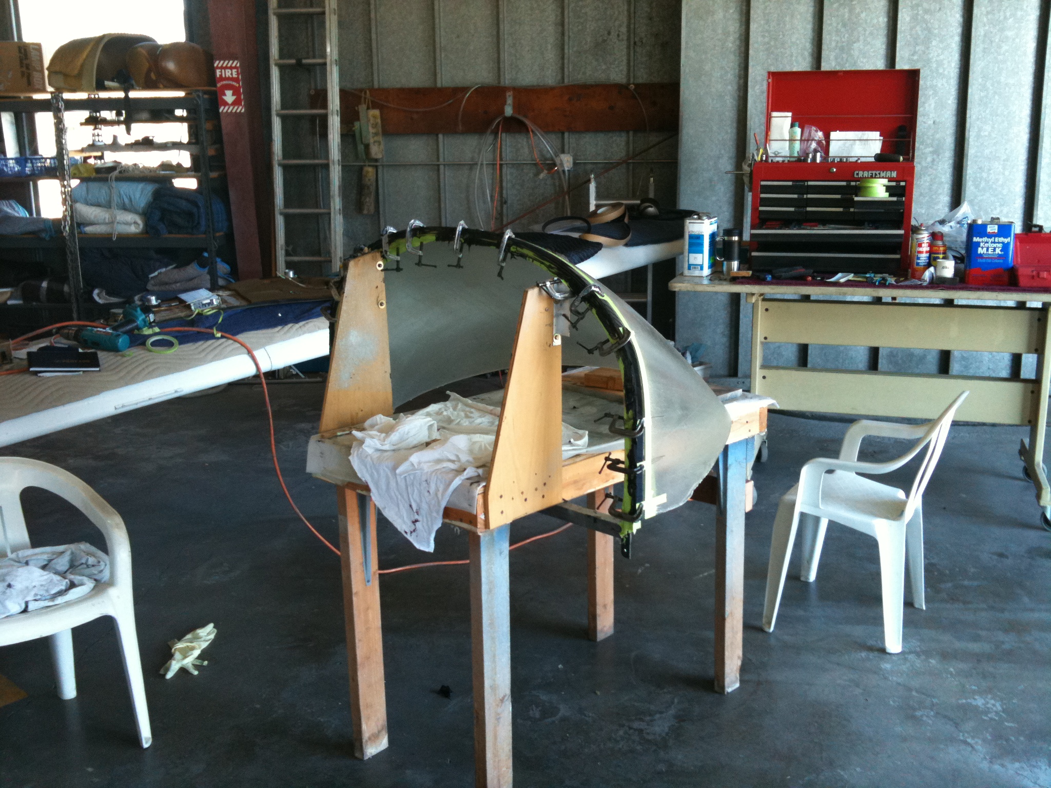

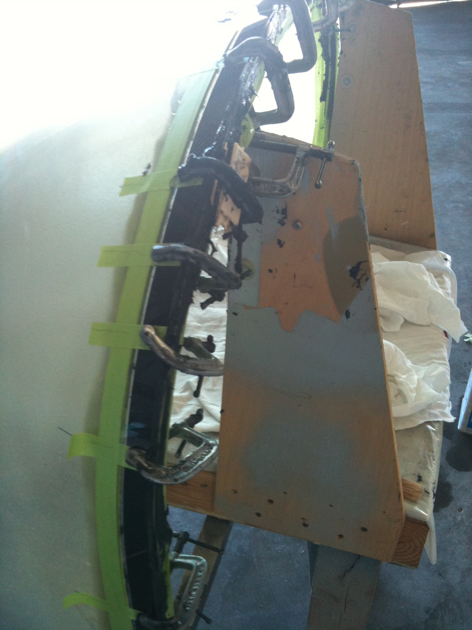

I've attached two pics of the jig after bonding the windshield. In the background you can see my work bench on wheels. I keep all the tools I regularly use on this bench. I also have safety wire, nylon ties, gloves, lube, and rulers on that table. In the upper left you can see a couple of wheel pants for testing.

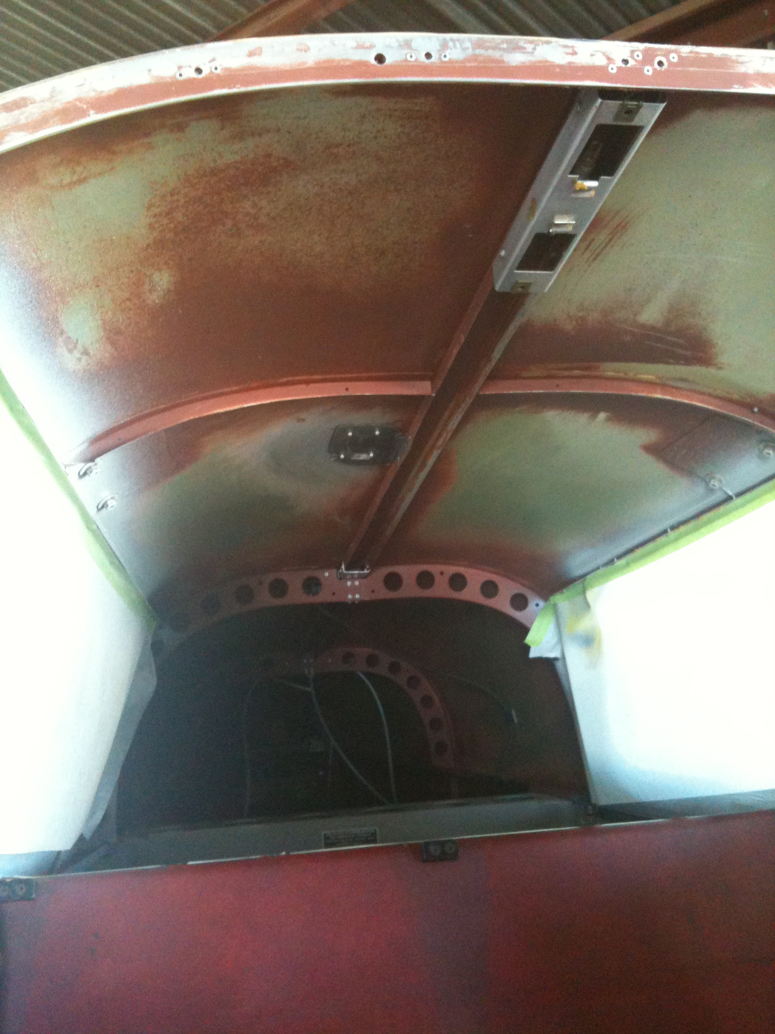

1348: cabin prepared for a new headliner

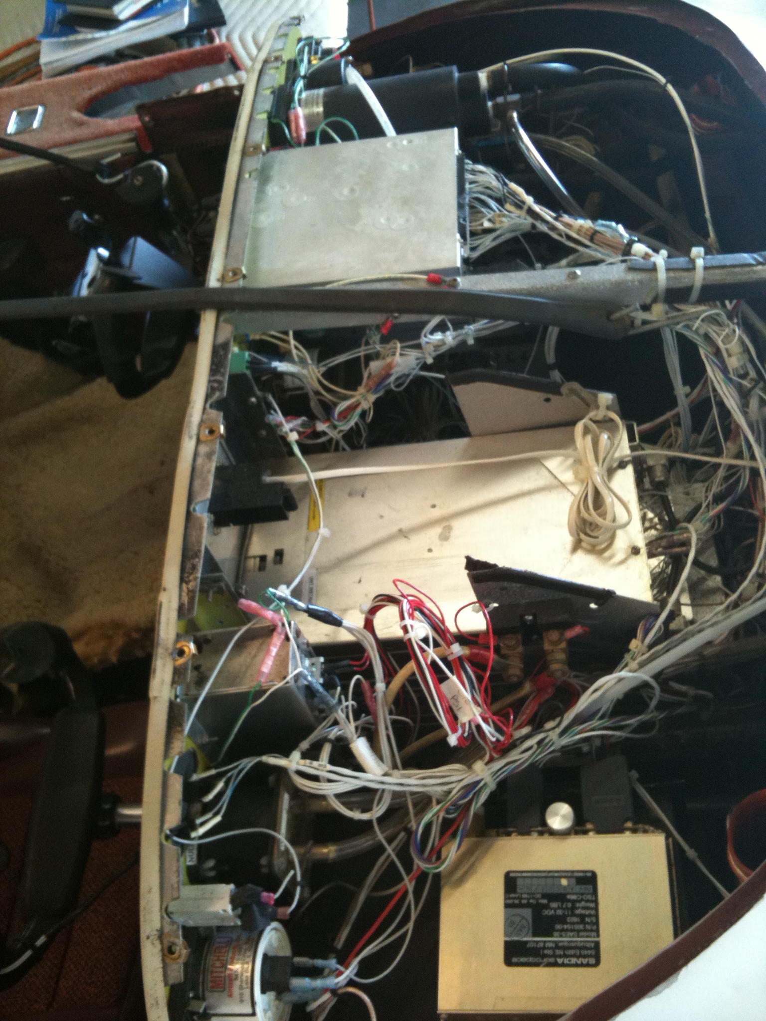

1334: typical avionics wiring. Nice huh. The glide slope receiver was mounted on the bottom of the glare shield.

the two holes on top drilled. It's at this point that I use a feeler gauge
the determine the gap between the windshield and bow. Where it's too tight
(meaning: places where the forward edge of the windshield bow would project
into the RTV making the RTV too thin, <.020, in that area), I mark the
windshield so that any clamps in that area are not over tightened. I use
two types of shims to space the windshield from the bow and maintain the
spacing during assembly.
Shims I've tried:
(1) self sticking foam that compresses to approx .025 inches. I punched
out dots using a hole punch. It worked, but left the dots showing. I did
one like this.
(2) .020 safety wire clips at the forward edge of the bow. It worked, but
left little holes when I removed the clips. The holes couldn't be filled
with RV. I did two like this.
(3) I made a spacer, .050 thick, the shape of the windshield bow, attached
to the bow through the holes used to hold the double bow seal on, that stuck
up .030 above the aft edge of the bow (same surface the seal uses).
The idea here was to hold the windshield .030 away from the bow
uniformly from one corner to the other. At first, this sounded like a great
idea (it wouldn't work with an LP Aero windshield because
there is no lip at the bow). The biggest problem was: the bows are
not all the same shape. I used this for 4 or 5 windshields before it became
obvious this was not practical. I kept filing and adjusting the shape to
get them to fit.
(4) Then, I made little "L" shaped shims that can be placed under the aft
edge of the windshield between the bow and windshield. The long side is
flush with the windshield bow face.
The long side is 1 inch long and is .063 inches thick. The short side
is .050 inches long and several thicknesses. I have 10 sets in sizes
from .025 to .040 inches.
These work pretty well. At first, I clamped them into place. Then,
screws through the holes that hold the double bead seal to the windshield
bow. Then tape. All work pretty well.
The gap can be filled with RTV after the shim is removed.
(5) My favorite is just too simple to believe. Again, using the holes that
attach the double bead seal to the windshield bow, I use a #6 screw onto
which I put a wide area #10 washer plus a wide area 5/16 washer.
I'd use just the wide area 5/16 washer but the hole is too big; the
#6 screw won't hold it by itself. With the windshield in place, I can
adjust the gap between the bow and windshield with the washers tightened
against the bow.
When bonding, I tighten the clamps, located at the shims, until the
washer just shows through the RTV and just touches the windshield. (NA
for LP Aero windshields)
After the RTV is applied to the windshield bonding area, the windshield can
then be set into place and located over the dowels on the bottom corners,
the holes line up on top for the top two screws and special washers. Clamps
are applied until I get either the "L" shim showing on the edge of the
windshield or the washer showing through the windshield. At this point, I
know the gap at the forward edge of the bow is about .020 inches. The gap
is kept as uniform as possible. After it's all done being bonded, I let the
windshield sit for a week before moving it. The maintenance manual says 3
days but I've found the RTV to not be totally cured at 3 days.

That's probably the worst wiring I have ever seen!
Cliff
