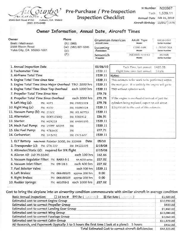

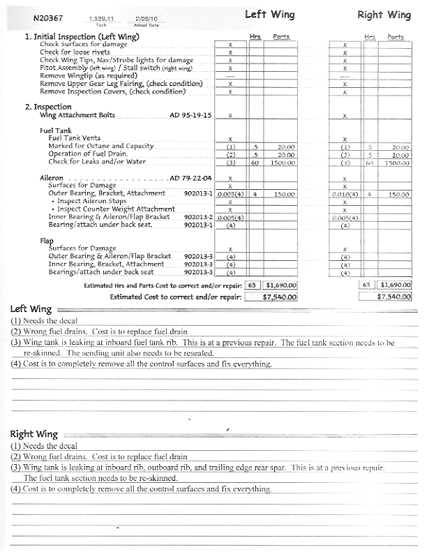

Very Good. You're right. It is the owner's call. I could offer something like different levels of inspection. For 8 hours you get this checked, for 12 hours you get this checked, . . .
My Pre-Purchase inspection covers all of the same items as my inspection checklist without going into so much detail. For example, I only pull the rear wing access covers adjacent to the fuel tank to look for leaks. The cowling doesn't come off unless I suspect something. What it does cover is how much everything is going to cost to fix.
I have attached two pages of a Pre-buy I did. I was giving Fletchair the benefit of the doubt when I picked the number of hours to fix. I really don't have any idea how much it would cost to fix the fuel leaks. They are pretty bad. Wings are really AFU. This plane has a lot of issues. I padded the costs a bit to cover the unforseen.

.ExternalClass DIV {;} Very Good.  You're right.  It is the owner's call.  I could offer something like different levels of inspection.  For 8 hours you get this checked, for 12 hours you get this checked, . . .
