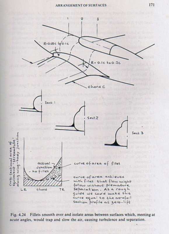

1) "I wonder if there is a formula for computing the location of the vortex
generator like there is for
the wing fairing."
What wing fairing formula are you referring to? I suspect that the location
of the vortex generators on the fuselage sides in front of the wing is based
on the TLAR formula followed by lots of inflight testing -- that is the
formula that I am using.
2) "It looks like a step. I wonder how many times someone will step on it by
mistake."
It does have words like "NO STEP" painted on it. Haven't seen any broken off
stubs yet.

PostPosted: Wed Jun 30, 2010 9:44 am    Post subject: KIS IT-1 Aerodynamics Reply with quote
Julian Bone, as part of his research and testing, came up with a book by Stinton. Page 171 really told the story about our problem and gave the formula for the correct wing fairing curve ,, 8 inch radius as I recall. The title and ISBN are: The Design of the Airplane (9781563475146) by Stinton, Darrol.
I bought a copy and loaned it to a fellow with a Glassair so he could design his wing fairing. Julian did some really good work on the low speed stability problem. Pictures of his plane with the new wing fairing are on Bob's web site as I recall.
Larry [quote] ---

Hello Larry, Thanks for the book info -- I'll try to check it out through
our local library inter-library lending system.

PostPosted: Thu Jul 01, 2010 1:09 pm    Post subject: KIS IT-1 Aerodynamics Reply with quote
Hi OC,
Good to hear you are not crashing that often anymore.
I very much like Stinton's book but it is a bit empirical at times with not a lot of data to back it up. In any case here is page 171. With a quick scan I did not see more on this subject. I would still check out the book if you can find it.
I am not convinced there is an elevator problem being caused by separation in this area with my aircraft. I have never had a problem with elevator authority up to stall both in and out of ground effect. I have not seen the video and am waiting on getting it from Scott. The one picture I have seen did show some turbulence (but it would be guessing to call it separation) at the aft wing root. But the flow over the tail and aft part of the fuselage still looks good. Maybe this turbulence is really just the very start of the stall? If that is the case the small root faring may start the stall. If so maybe this is not all a bad thing since at the root is the best place for the stall to start.
Of course I do want to reduce drag since I NEED to be faster than Scott.
Mark Kettering
if you can find it.

> Hi OC,
> if you can find it.
> Mark Kettering

Hello Mark, Thanks for your reply, the good wishes, and the page from
Stinton's book. You wrote:
1) "I am not convinced there is an elevator problem being caused by
elevator authority up to stall both in and out of ground effect."
We may not understand completely what is going on pitch wise in the landing
flare and ground effect with the KIS TR-1, but it would seem that enough
pilots have reported enough surprises / problems in this arena that we:
A) Don't have a firm grasp on the nature of what is happening in this arena;
B) Don't have agreement on the existence or extent of the surprises /
problems in this arena; and C) Don't have agreement on whether a solution is
required or what that solution should be.
I do agree with Rich that the problem is not dangerous, but I am still a bit
annoyed that after flying 50 years plus, 5,000 hours plus over all, and
almost 300 hours in this plane that I can't do a consistent flare and
touchdown on every landing. Further the nose wheel touches down immediately
after the main gear touches down almost every time. On a few rare occasions
I have kept the nose wheel from touching down, but when I make a determined
attempt to keep the nose wheel from touching down I am likely to do a little
re airborne skip.
2) "I have not seen the video and am waiting on getting it from Scott."
If my DVD copy efforts have been successful I am willing to make more copies
and send them to interested KIS TR-1 pilots -- this is what Julian had in
mind in sending me the DVD. You will see video of yarn tufts flowing forward
against the direction of travel in the wing to fuselage fillet area. Don't
know what this is doing to the air flow back at the horizontal tail
surfaces, but it can't be all good.
