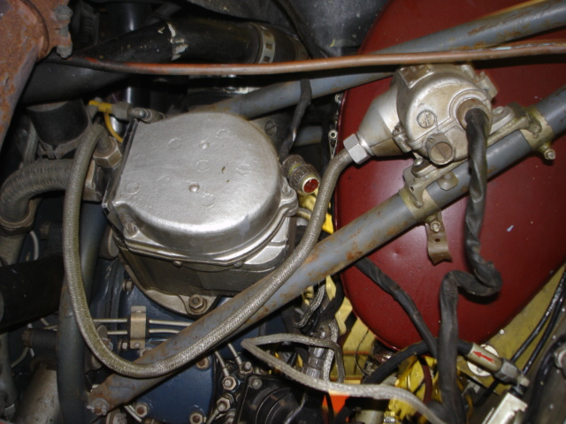

Mark, where is the shower of sparks unit located?  I assume it's close to the mags? I have 5 chinese manuals, but none of them show it.
Paul

PostPosted: Mon Jul 26, 2010 2:58 pm    Post subject: CJ6 Hot Starts Reply with quote
Paul,
Normally on the left hand top motor mount leg, has a shielded plug wire lead coming out of it.  Have also seen them mounted on the fire wall, but always on the left hand side.

PostPosted: Mon Jul 26, 2010 3:44 pm    Post subject: CJ6 Hot Starts Reply with quote
It is mounted on the upper engine mount on the left side (from the cockpit). There is a shielded wire coming from the unit to the front cover plate of the left magneto. Look at the right mag and you will see there is no shielded wire going to the front cover plate.

Paul
Look in your manual Figure 11-12
 Filesize:  151.15 KB
 Viewed:  15843 Time(s)
