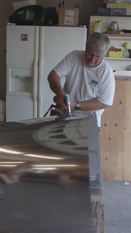

We are making good progress on the first kit. This was the 8th day and we finished the tail cone today. So now all that is left from the first shipment is the emp attach and the emp fairings. It goes together fast and everything has fit very well. Here's a pio of Bob pulling the last tail cone rivet. We were looking for that one all day. Fuse kit arrived this afternoon.Albert GardnerRV-10 N991RVYuma, AZ
