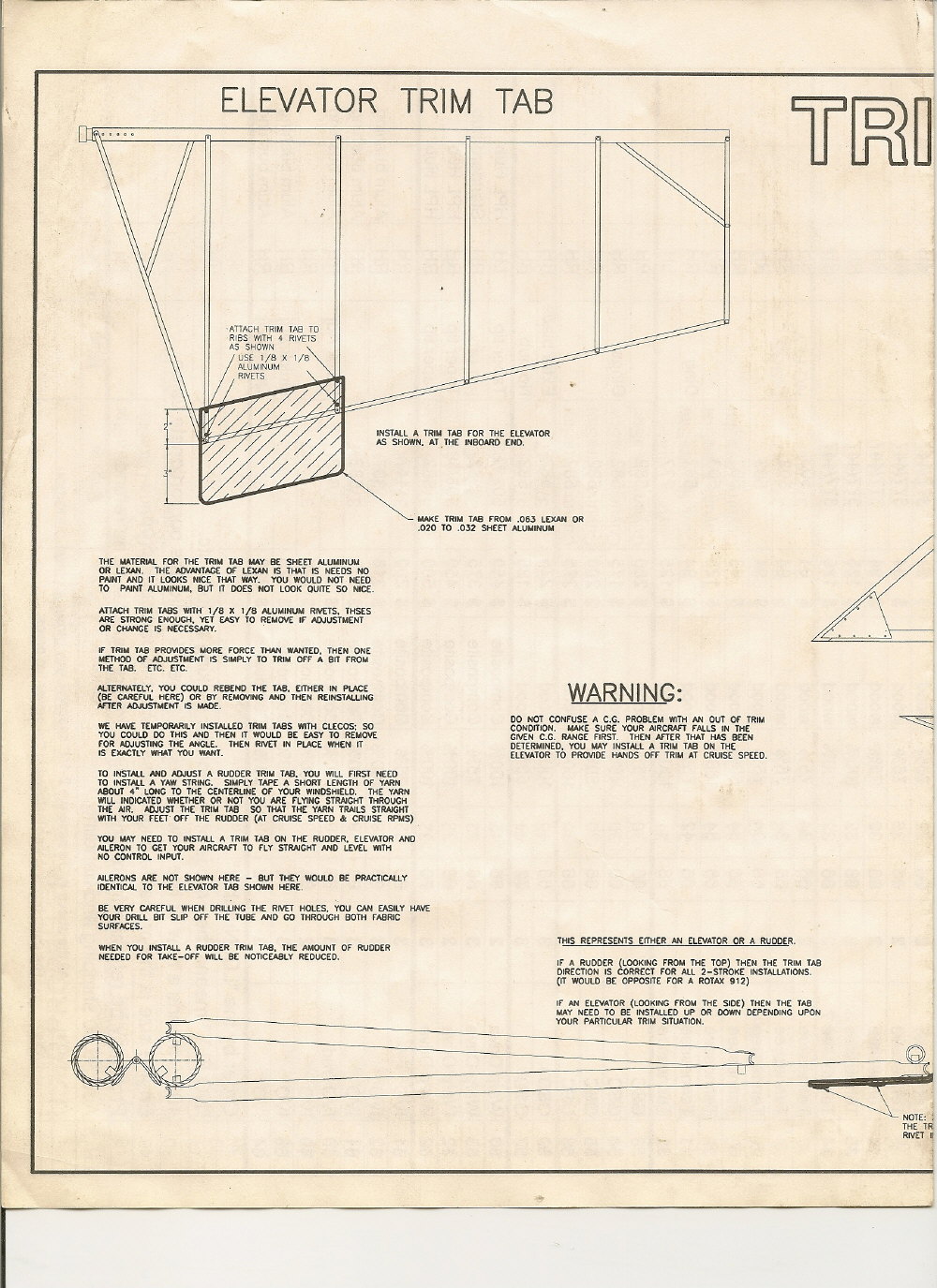

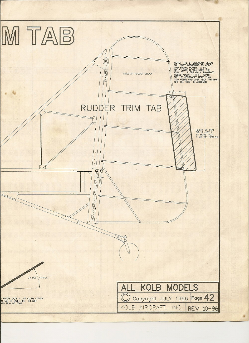

Here are the factory paper for trim tabs.

Larry, thank you very much for sending the factory plans for a trim tab. Would it be possible for you to send another one, this time with a better view of the rudder trim tab. Mine was cut off and I couldn't see it or read the printing for the rudder.

Disregard may last msg Larry. When I printed it out I received all of it.
