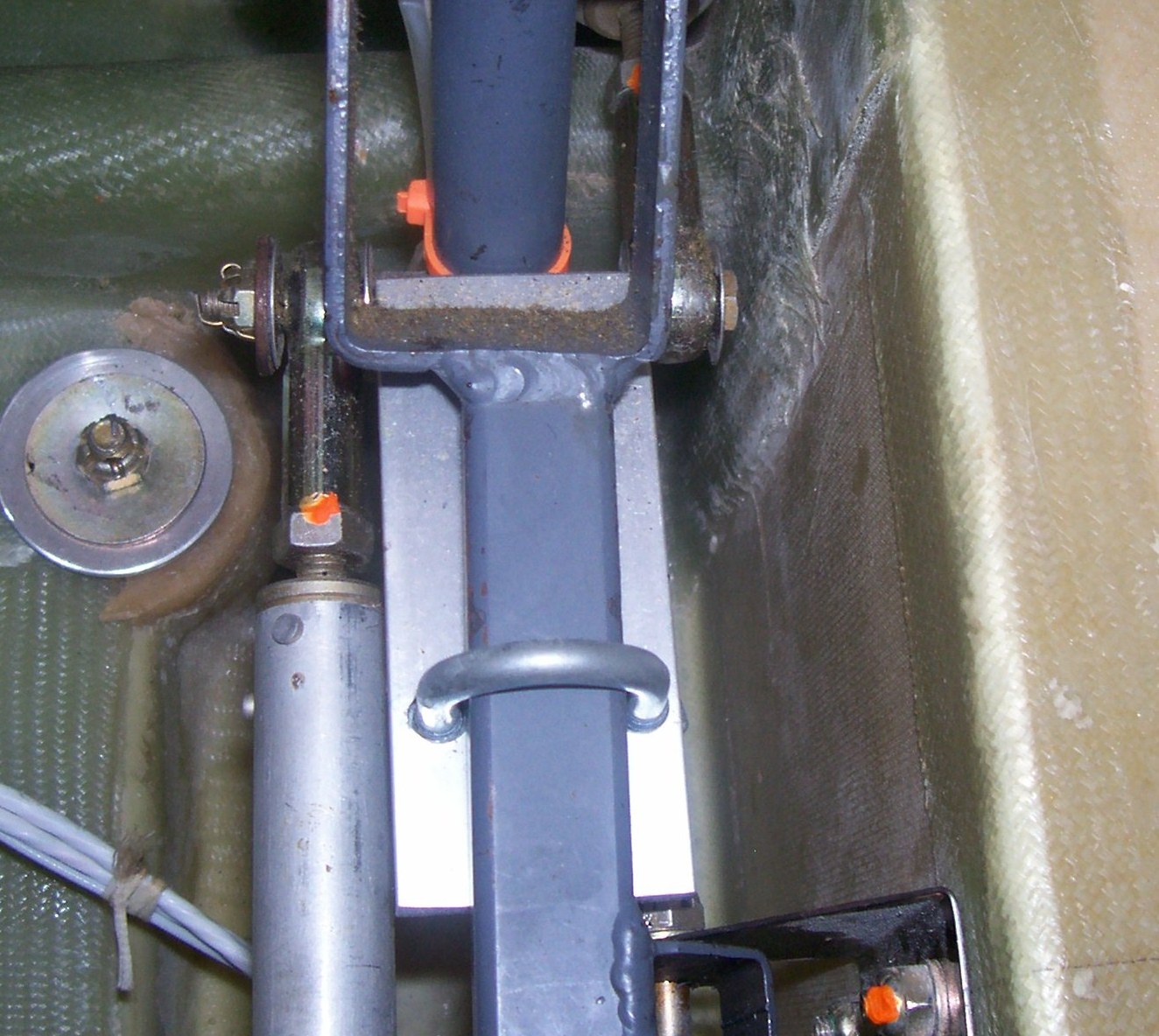

3) "The crontrol stop was emitted off the new one and the ¨C¨ was modified
to act as the control stop by allowing the stick to hit the edge."
You can see in the attached photo number 0371 that I used the control stick
hitting the edge of an adjustable U clamped aluminum bar as an aileron
control stop -- one was required for each stick to provide for a stop in
both directions.
