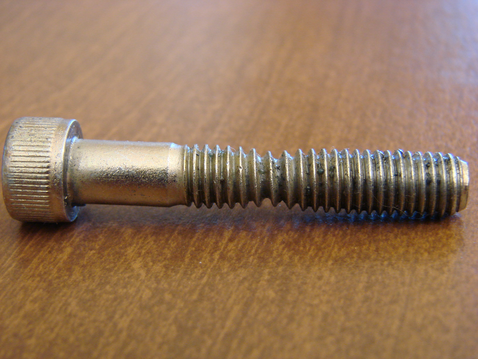

Here is a bolt from the gear box of a 912ULS...factory new engine. Bolt was removed for box inspection and never re-installed. Looks like severe over torque or bad manufacturing, but Rotax could not have properly torqued the bolt because when I tried it the bolt would go in a certain distance and then just spin without ever tightening.[img]cid:EADEEEE63413438FAA2D41165432DCB2(at)John320gbPC[/img]

Are you sure that it did not get that way when it was removed. Did you check the installed thread engagement length against where the distortion occurred?

Spins without ever tightening? Sounds like stripped threads, which would be the other symptom of this having been put in and over torqued. What happened when you put in a new bolt? Did it spin, too?

John:
This is real crazy and not in a good way.
The bolt - Allen Head Cap Screw - looks like it is plated.  Either Nickel or Chrome.  And in my plating days I have seen the same mis-shaped threads
Happen because of poor electrical contact where the wire was attached to the screw.
Notice the shape of the threads in the reduced area.  They profile the original. right down to the crown.  Just that the MAX Diameter is not correct.
This can happen during plating, since in the cleaning process they use reverse current.  Add that to a poor wire contact and that is what you will see.
NEXT - Possibility - I can not tell from the picture very well, but, measure the distance over the thread crests.  See if they get wider.
This would be a good indication that the screw was over torqued and stretched.
Barry

No, a replacement bolt went in and torqued up properly...I don't understand it either, but it seems OK now....just some weird thing I though folks might be interested in and perhaps know the reason...it came out readily without any excessive force - same as its mate on the other side of the gear box.

Is the eroded part of the bolt at a place where two parts join or is in a place open to internals of gear box ? if so could be caused by corrosion.
You say it only went in part way & spun so the threads down to this point must be stripped, did the protruding part have sufficient length left that sufficient thread are left for new bolt to hold safely?.
