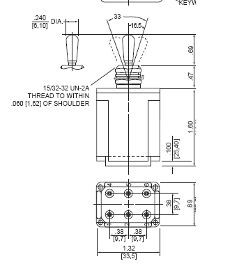

These are one of many examples of devices crafted for
the IWTS (integrated wire termination systems) used
in many military, aerospace and high-end industrial
applications. Here's a toggle switch fitted with
IWTS
[img]cid:.0[/img]
The idea behind it is to make as many of the system's
wire terminations with standard crimp tools as possible.
The terminal blocks you've found are just commoning points
for multiple branches of a circuit. Rather than crimp
on terminals and then attache with screws (ugh!) one
simple crimps on a pin (usually female) and stuffs
the pin into an environmentally sealed cavity to mate
with a captive pin therein.
Some of the earliest patents on this idea go back to
the 70's. Other products using this technology . . .
