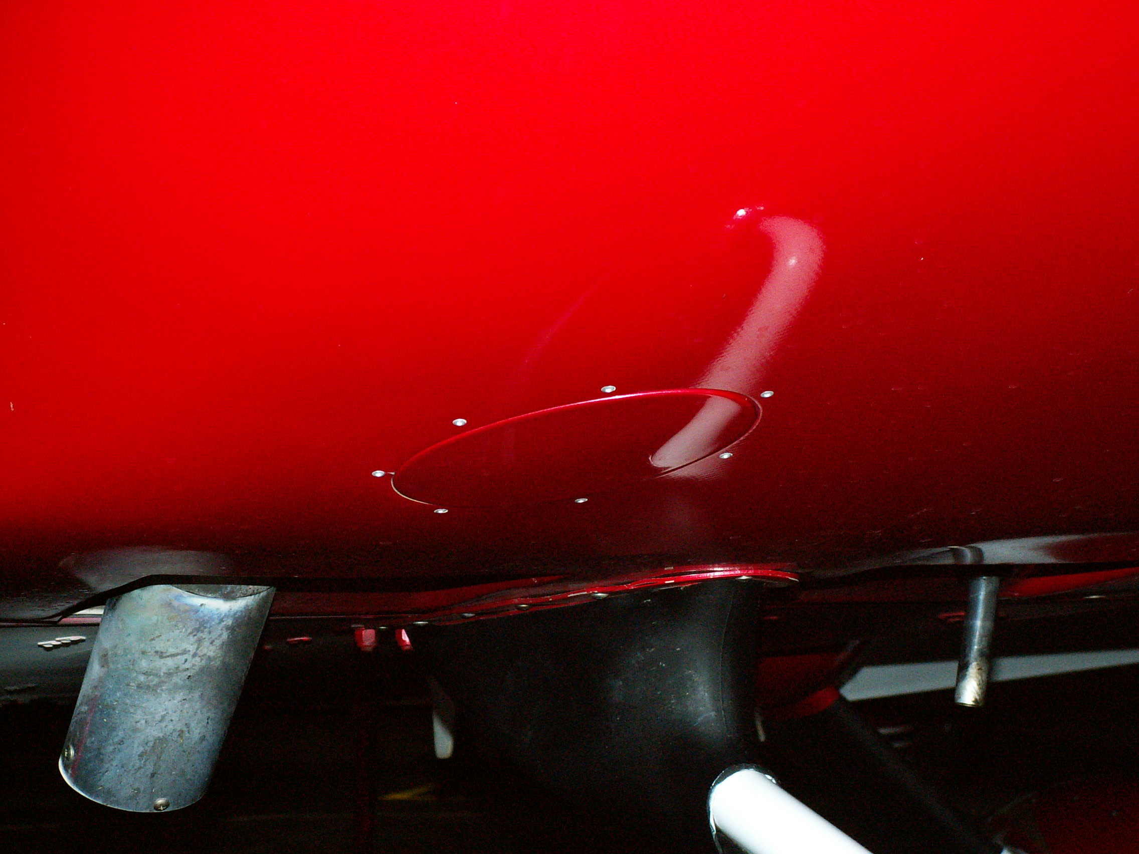

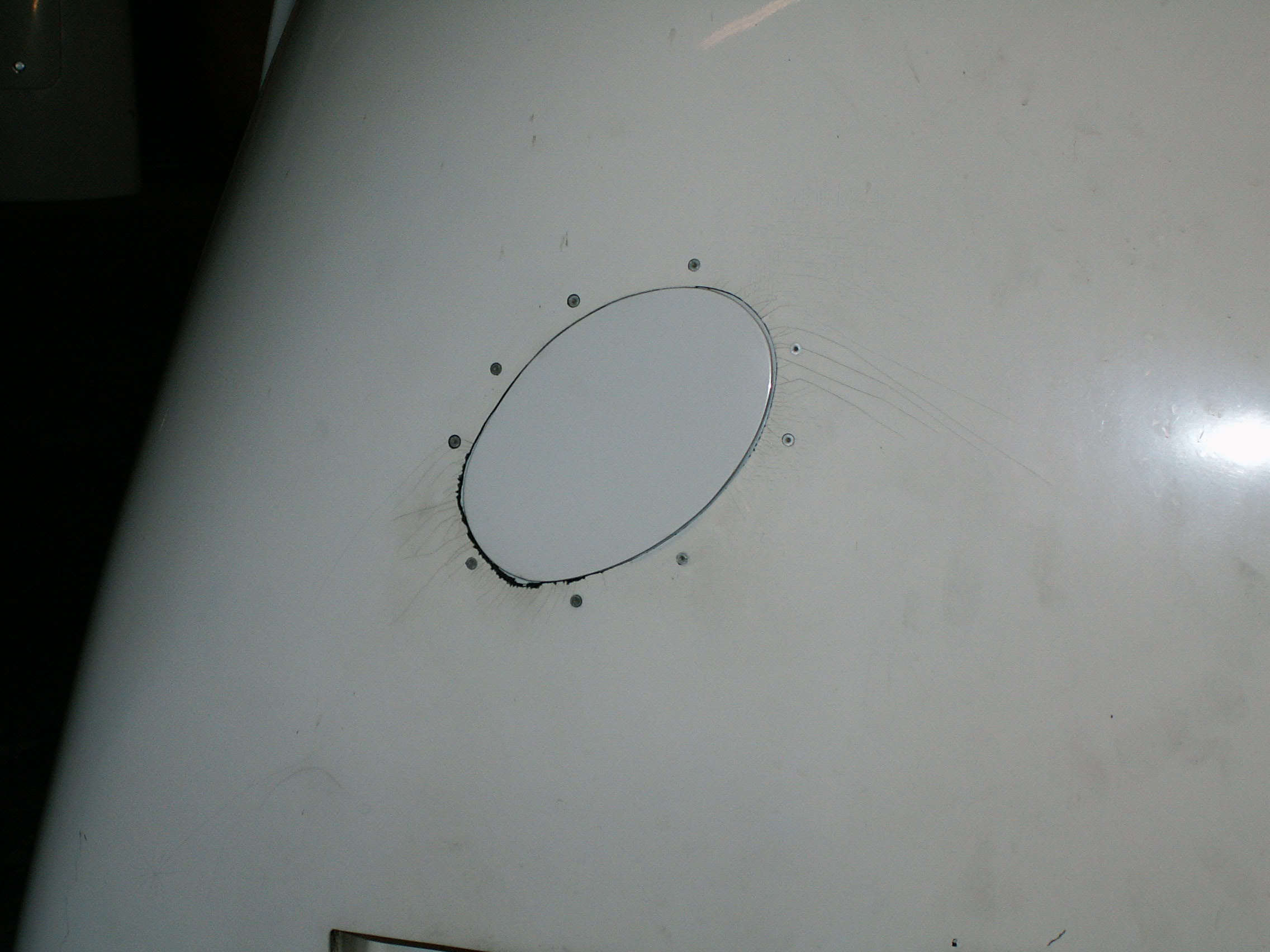

I see a lot of scabbed on pieces of aluminum to fill in the hole where the old tail pipe came out. Very amateur. These are fiberglass hole covers that are contoured to the shape of the cowling.

Gary, I see that this is a picture of the old cowling ( original ) but with the exhaust exiting out the exhaust ramp and not the hole in the cowling. Is this an exhaust STC?

Both are Tigers with the internal Power Flow Exhaust system.
