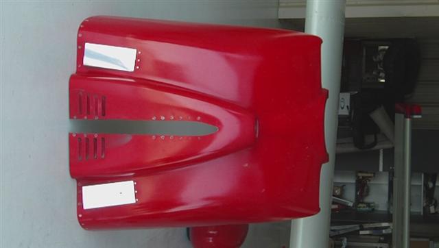

I did the same thing initially, it was to allow for ease of removal w/ 3 bld prop.
http://deemsrv10.com/album/Sec%2047%20Spinner%20and%20Cowling/slides/DSC04249.html (click forward for 8-9 pictures).
But when working on cooling issues I modified the original removable plate to one which included louvers, in the hope that it would allow for more exit air and better cooling.
http://deemsrv10.com/album/Phase1/slides/DSC07558.html (several pics)
As you can see from the pictures, I enclosed the slot with a cover aft of the landing gear leg.
RESULTS : I can't say as any of this made a significant difference in cooling.

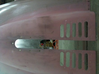

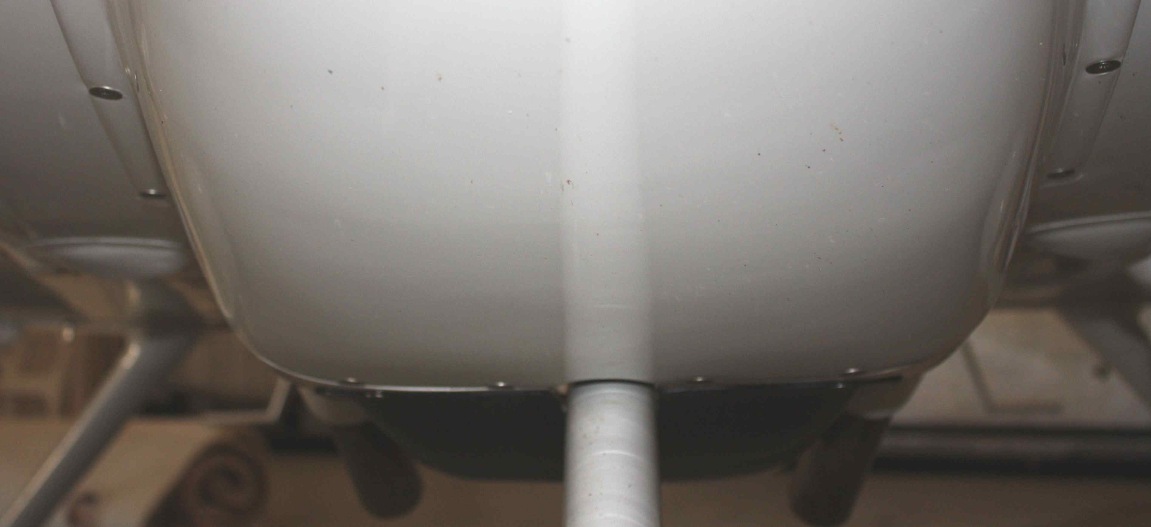

PostPosted: Mon Sep 13, 2010 7:11 pm    Post subject: Re: Lower cowling slot Reply with quote

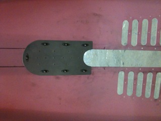

Thanks for the replies. I made this today. Hopefully this makes it a little easier to take off the cowl. It is 7 more screws on the lower cowl but I will have the screwdriver out anyway.

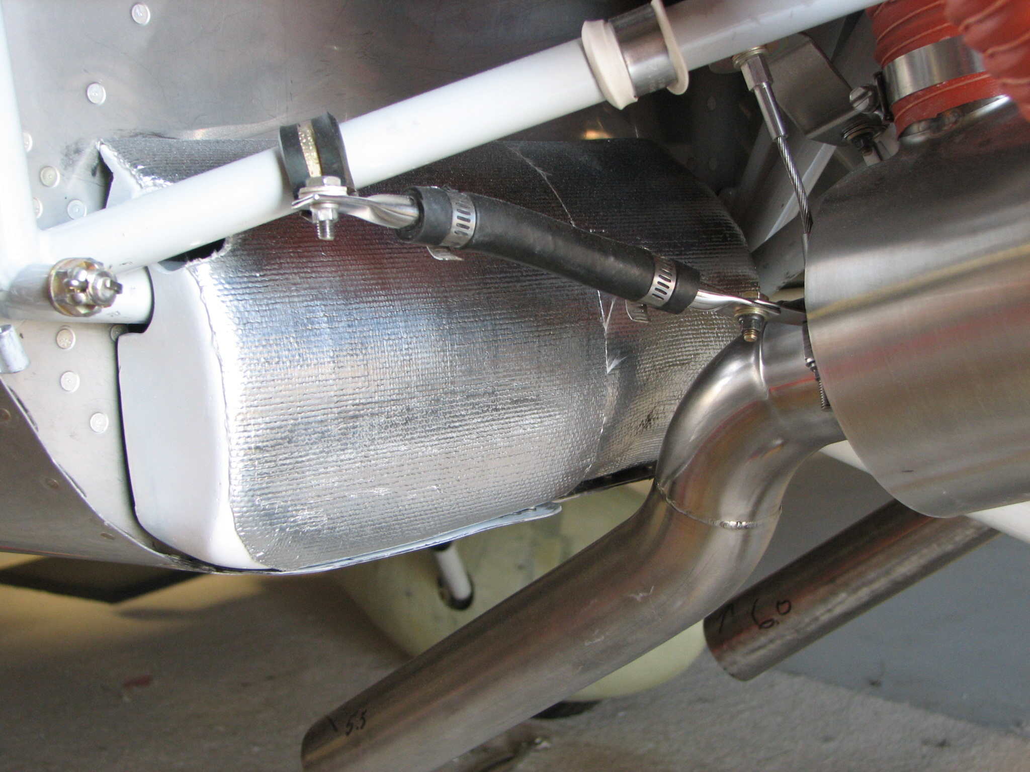

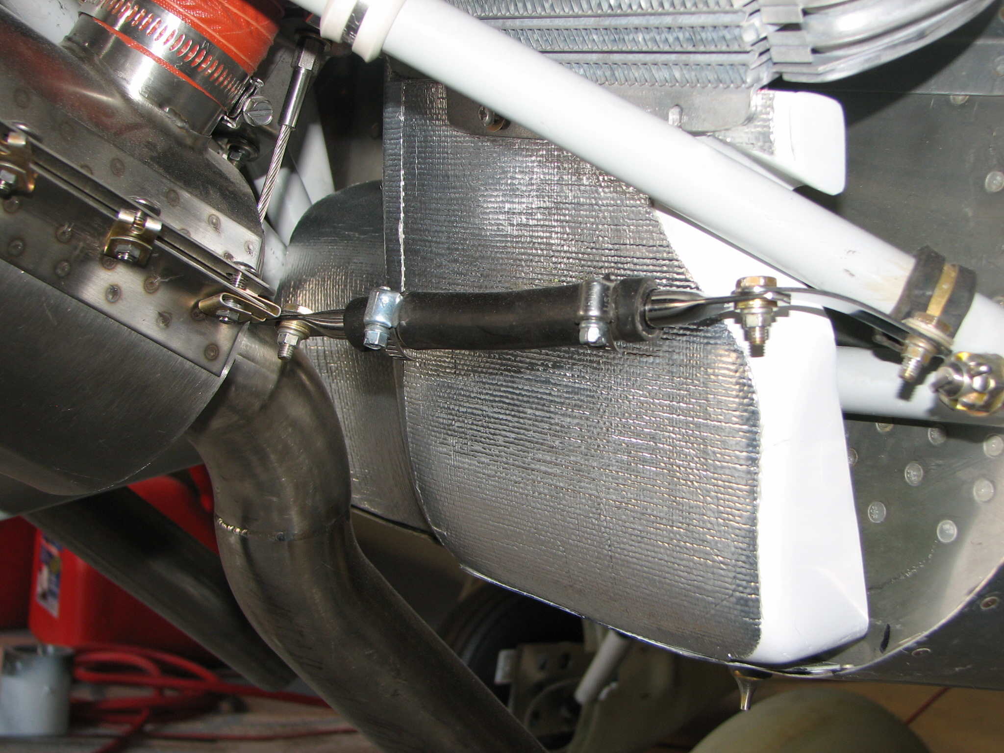

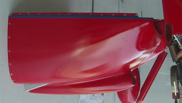

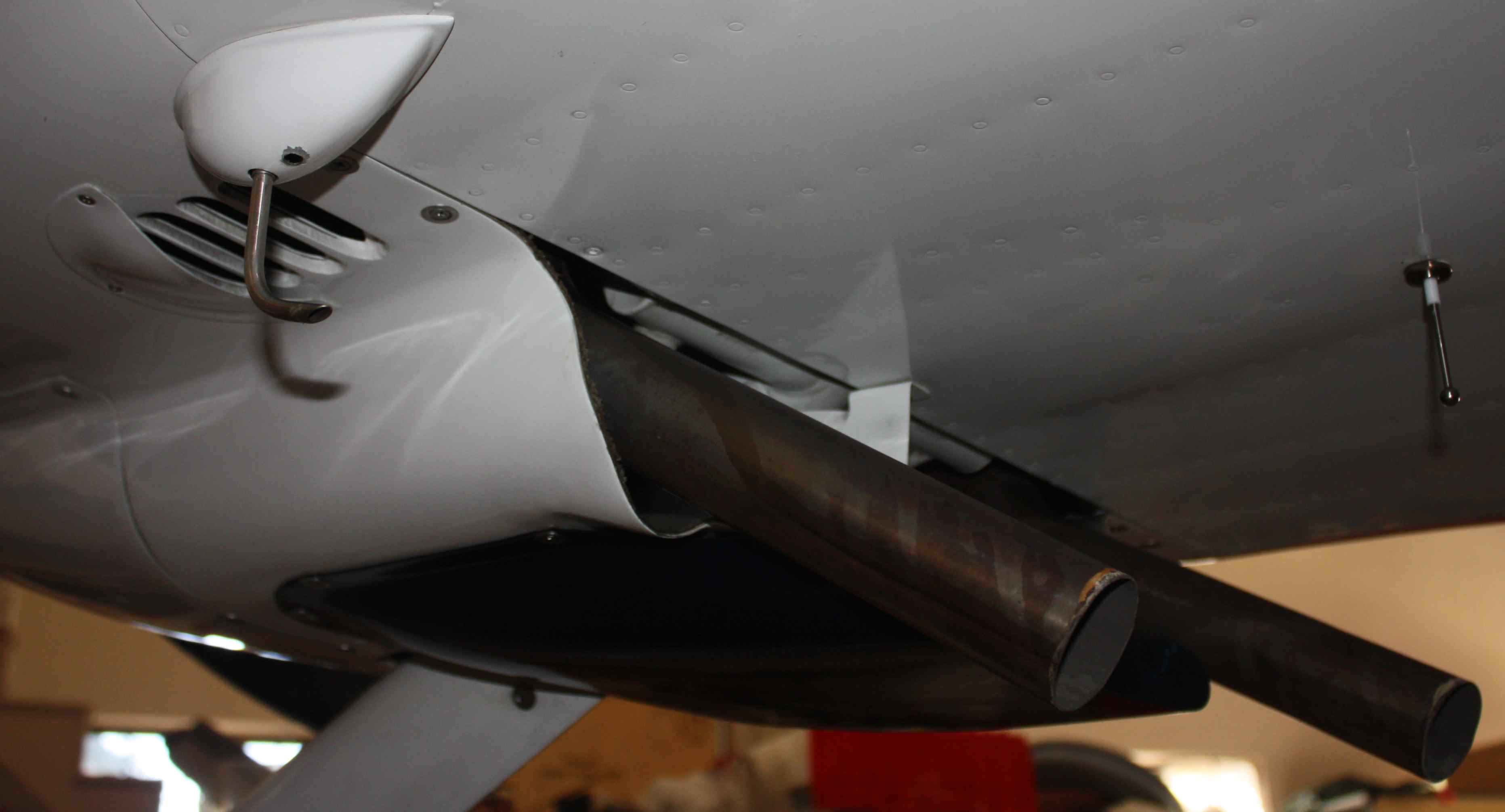

I fought high oil temps and installed a second oil cooler on the right side.
Final part of the solution was cowl flaps as these pics show. Before I put
the non-adjustable flaps in I had louvers in those locations but they didn't
do enough. Still have to be careful of extended ground operation in 100+
days though.

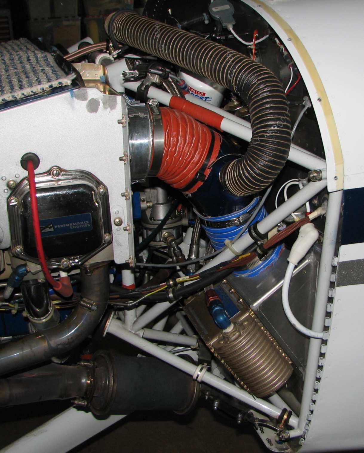

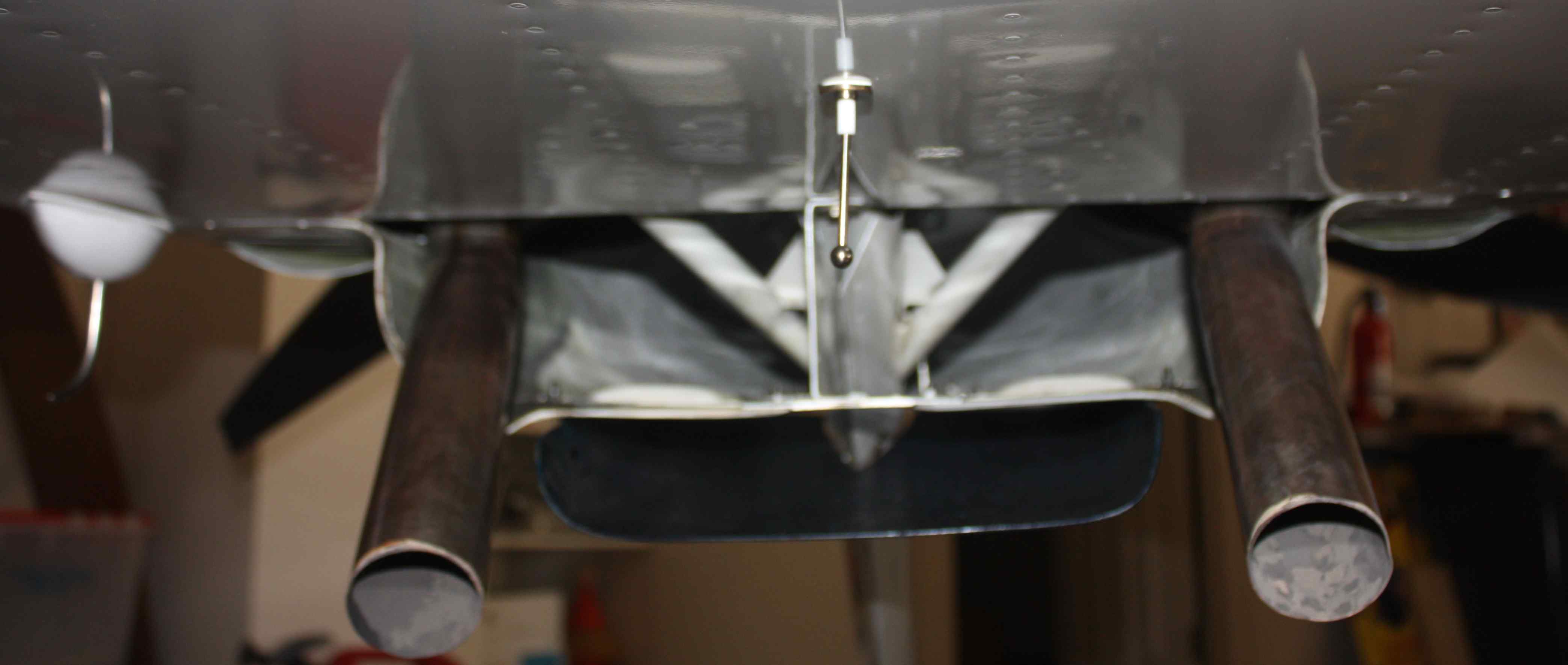

First we must all be talking apples and apples. Deems not lonly doesn't have a stock engine, but he lives in AZ. So all of us with cold air induction, and/or higher compression, and/or are living in a hot climate, need to do things different than Van's stock setup.
There's already a baffle out that inserts into the oil cooler box.  I believe most of us with heating problems, including Deems, has already installed this. I did a number of things and I seem to have the heat issue managaeable. I have 8ea. 3" louvers on each side of the bottom cowl (Van's has 5ea. 4"), then I have 4 additional louvers on each bottom outside edge of the cowl. 4 of these are directly below the oil cooler. All of these louvers have a reverse scoop to allow the air to escape without having to compete with the relative wind. The last thing I did was something I just thought up. I used the 2nd 2" scat coming off the back of cyl #5 (both of my heater scats come off the back of #5), routed it over to a fabricated fiberglass "Y" and input it, along with the 4" from #6, into the oil cooler. #6 was my hottest cyl, and the difference between #5 and #6 was around 20 degrees. After installing the mod, the temperature difference is usually between 5 and 10 degrees and
on a hot Texas day, after going to lunch, on the way back at 3,000' I ran 3 120 degree different course headings at 25sq. My TAS calculated out to 199mph, and my oil temp never exceeded 197 degrees.
I attached a few pics of what I've done..... no engineer here, just trying stuff that I thought might work.
