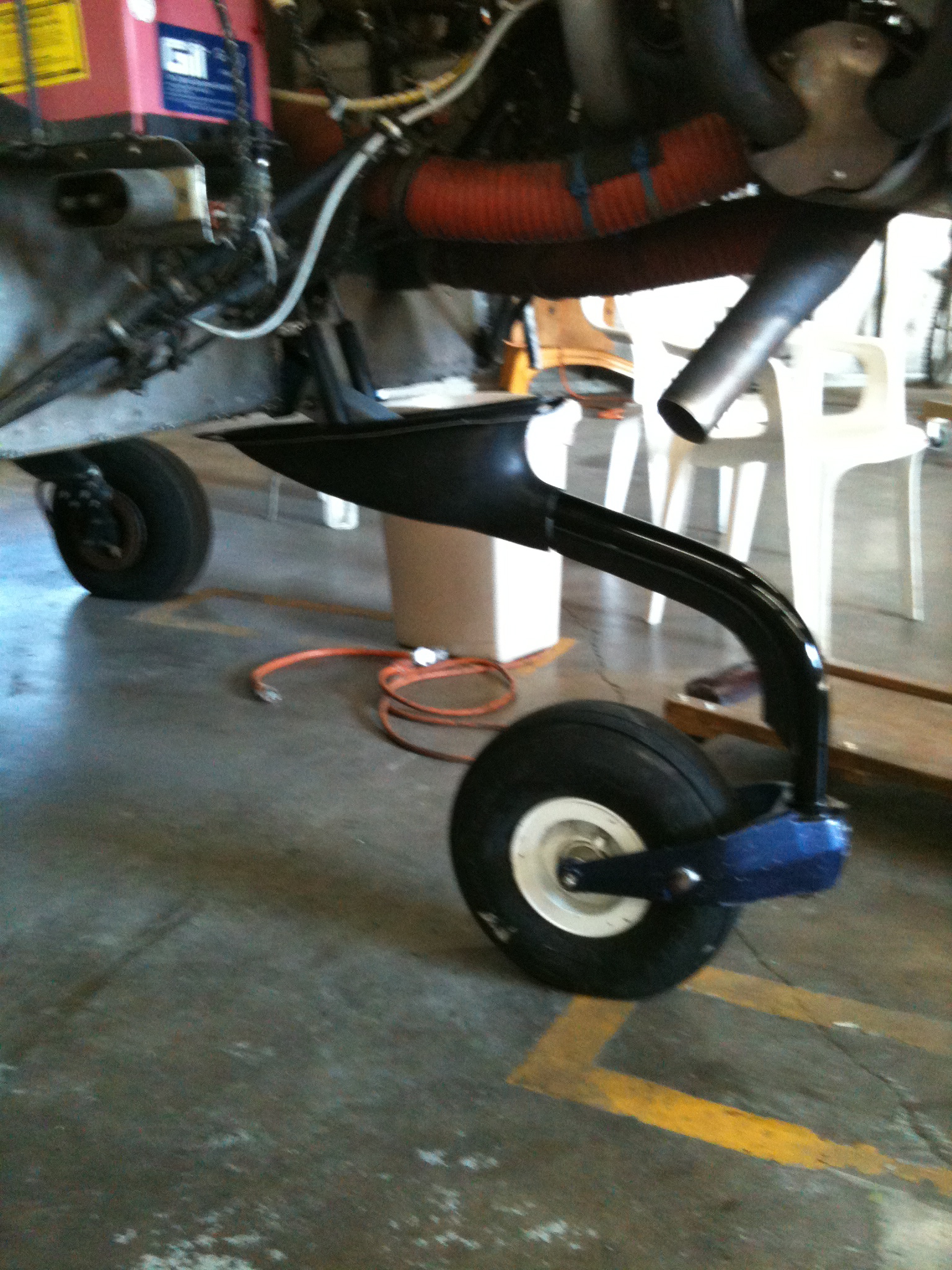

Yes, you're right Garner. No one will ever see it.

PostPosted: Tue Sep 14, 2010 4:37 am    Post subject: Project X plane Reply with quote

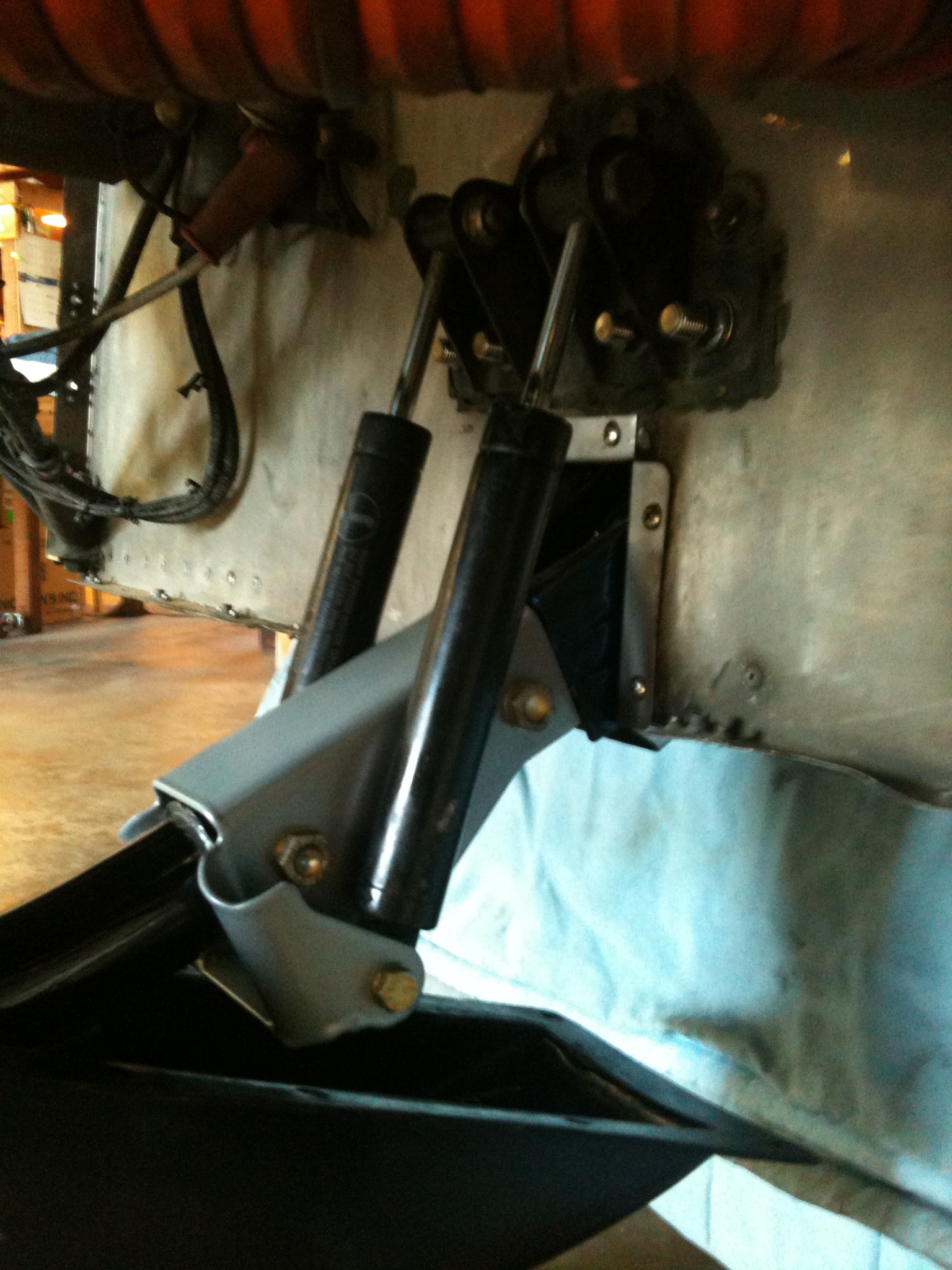

Not sure what no one would ever see,  if I cant see it. What is it. I did notice the shock absorbers that are for the AA and not the AG. And cant see clearly enough what is behind the shock mount. Is that an inprovised seal or somthing?

PostPosted: Tue Sep 14, 2010 9:08 am    Post subject: Project X plane Reply with quote
Don't know about the shocks. They have 2004 dates on them. and they aren't broken. they both work. that's rare. If they are the wrong shocks, it came in that way.

PostPosted: Tue Sep 14, 2010 10:25 am    Post subject: Project X plane Reply with quote
 Not sure how the 2004 dates since Stabilus hasn't supplied them since the 70's. If that is an early AG then all bets are off. I had been trying to get them produced since way before 2004. Countless calls to them over in Germany and finally gave up in 2006 on ever getting them reproduced.

PostPosted: Tue Sep 14, 2010 7:35 pm    Post subject: Project X plane Reply with quote
it's a 1991
