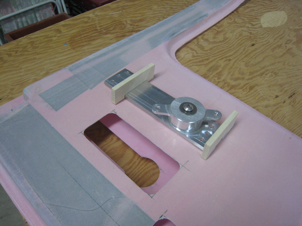

Both my flush door handle bases have come out during door fit as well. These were originally epoxied using flocked cotton and west systems. I am redoing both with a base of the above plus reinforcing glass cross pieces... and am adding a screw to the aft lip as it gets the most torque.
I'd suggest that the manufacturer add several lips in the handle base to allow screws to be added where desired... Like this maybe:

I agree that flush handles from iflyrv10.com need to have additional support to be more securely attached to the structure of the door. here is a picture of what did to achieve that. Also, I agree that some lubrication of the pins is in order, I used Bolube and after the doors have sat closed for a while and now almost 70 hours of flight time the doors open and close easily and the flush handles have stayed in place.
These saddles were made out of 1/4" hard balsa wood sheet and epoxied in place
