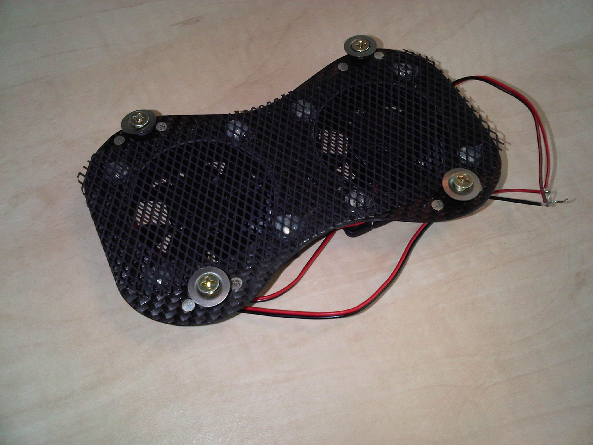

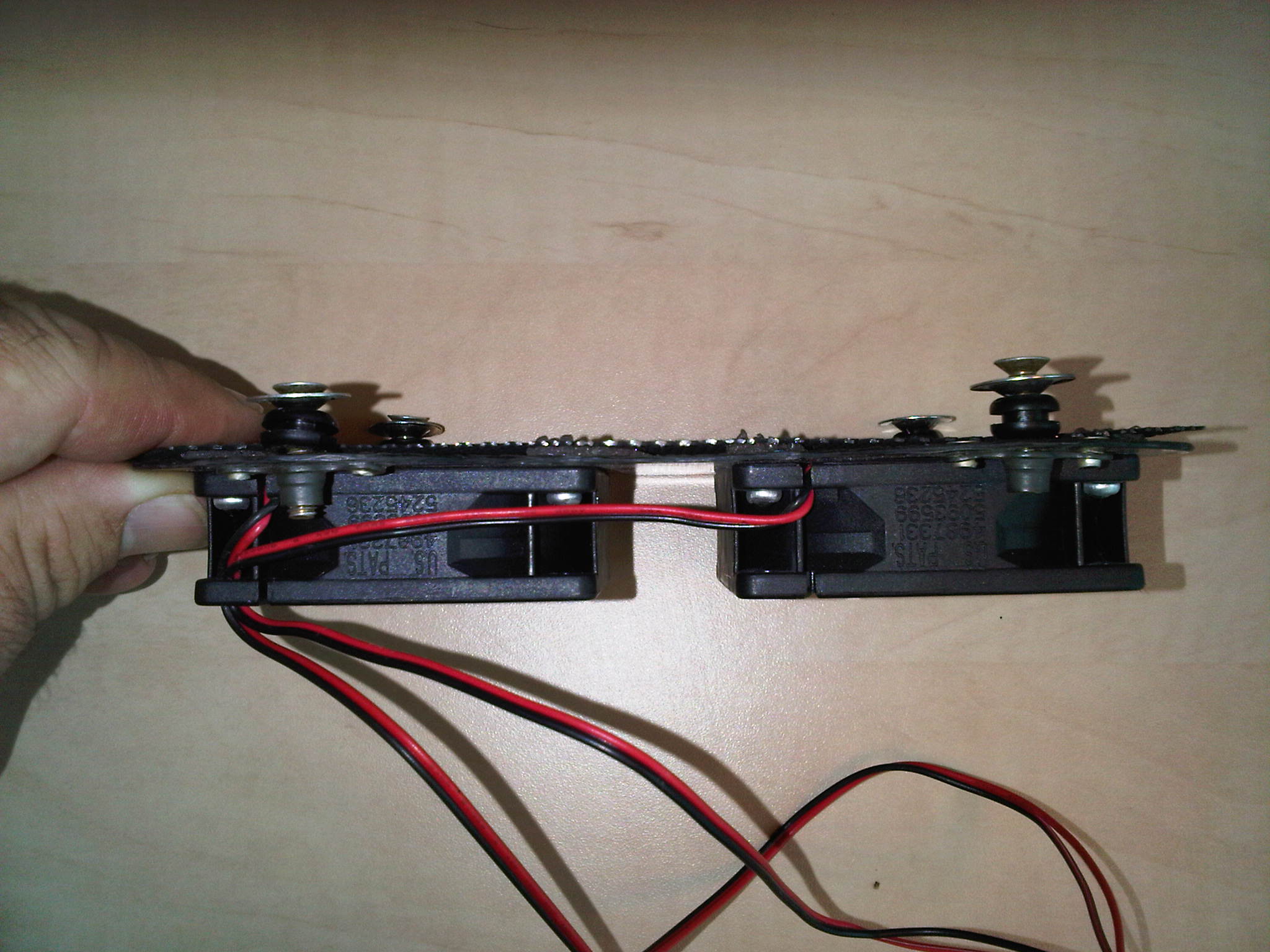

Mark has recently done some work on GIPOD, l made up a fan module which helps with demisting and also pulls heat from behind panel onto the screen, see attached pictures. Mark installed it.
John
Base is flexible enough to follow panel upper contour when installed. Mesh is to prevent fans jambing with FOD.

Carbon PPS (4 plies) tray with 2" fan units.
