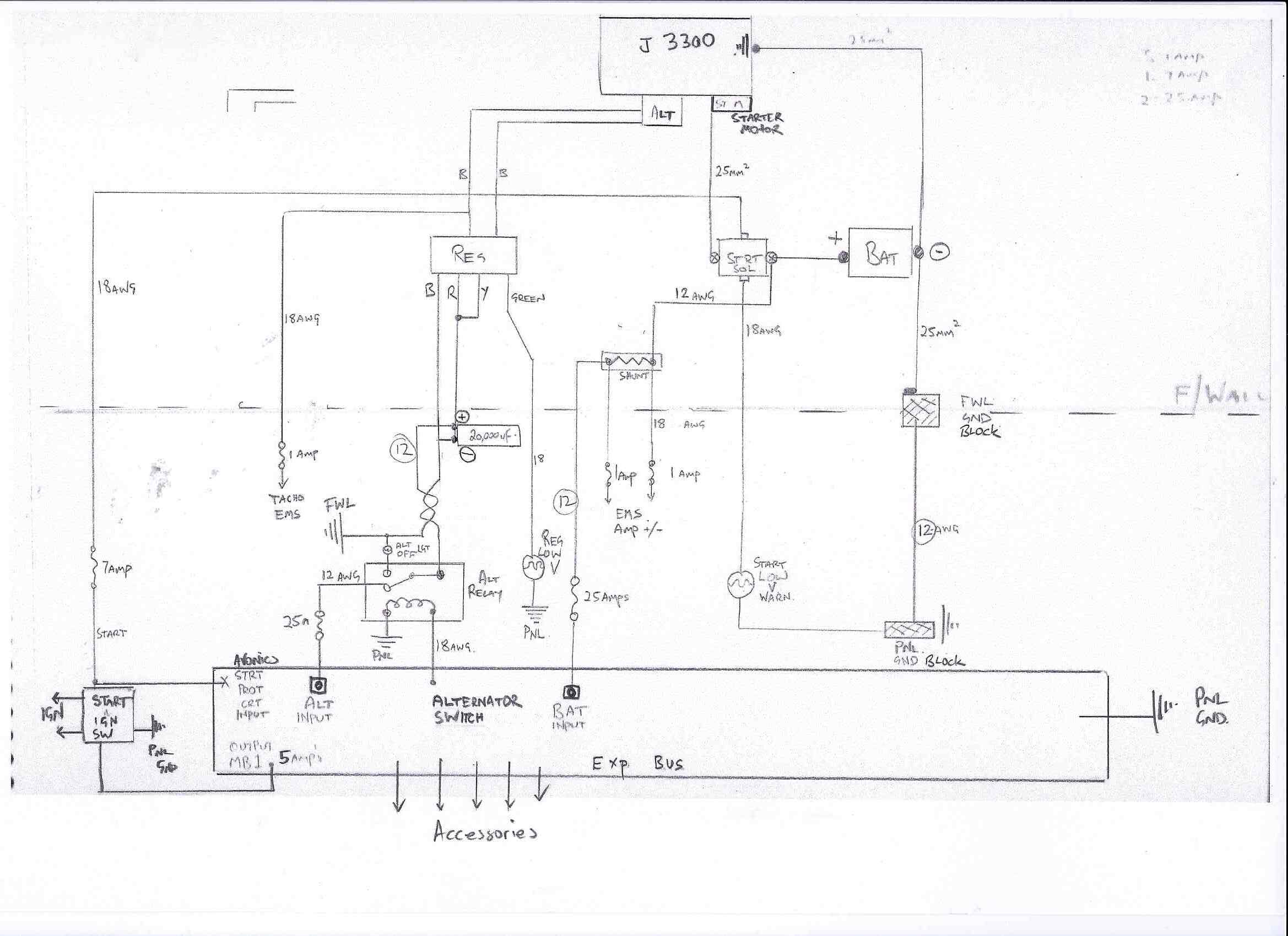

Please comment on my Wiring diagram J3300 and Exp Bus
ple190
Joined: 03 Sep 2010
Posts: 23
Location: Australia
PostPosted: Tue Sep 28, 2010 3:37 pm    Post subject: Please comment on my Wiring diagram J3300 and Exp Bus Reply with quote
Any comment or suggestions appreciated, this is draft 3
