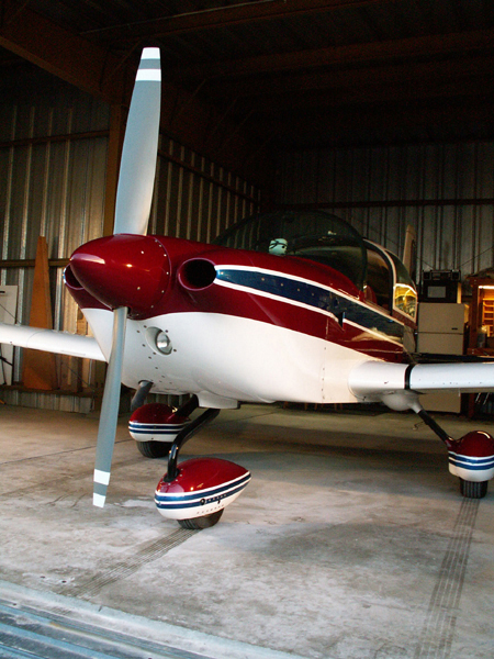

The first question the FAA will ask (through the DER) is, "Is the cowling exactly the same as it was with the exhaust system previously tested and approved?"
The answer is, "No."
The next question is, "Is the pressure drop across the cylinders exactly the same as it was with the cowling/muffler combination previously tested and approved?"
The answer is, "I don't know."
The next question is, "Does the possible change in pressure in the area under the cowling near where the carb heat gets its air affect the carb heat rise temperature?"
The next question is, "Does the possible change in pressure and air flow paths in the area under the cowling affect the temperature of the accessories (mags, vacuum pump, etc.)?"
The next question is, "Does the exhaust pipe hanging out further forward and coming through the affect climb performance?"
The next question is, "Do you have approved drawings for the proposed changes?"
So, without approved data, tests will need to be performed to determine just what the answers are.
It seems like it would be easy to certify the cowling with the stock muffler, doesn't it. I mean, hey, the stock Tiger has one. What many of you fail to grasp is just what changing a small thing like the muffler would entail. There is absolutely nothing 'logical' about getting an STC. It's all about examining every possible affect a change makes and then investigating that possibility and how it MIGHT affect the safety of the airplane.
Case in point: The carb heat rise with the Power Flow Exhaust System (PFES) was approved for the stock cowling. The Jaguar cowling, in no way, has any affect on the ability of the PFES to generate enough heat to pass the carb heat rise test. I created a company test report, with pictures, explaining how the cowling does not affect carb heat rise tests. Yet, someone in the FAA felt like it may be possible that the change in pressure drop across the cylinders could 'possibly' cause the pressure at the inlet into the PFES carb heat portion of the muffler/collector to reduce the ability to achieve the required 90 degree temperature rise at the carb inlet. Those tests, alone, took 3 months and thousands of dollars.
Case in point: It's fairly obvious that the Jaguar cowling creates less drag. I had to complete 5 climb performance tests at gross weight to show I met or exceeded the performance of the POH. Those 5 flight tests took 2 months to complete.
If you've seen any of the initial pictures of my plane with the Jaguar cowling on it, you'll see it had the stock muffler. Less than a year after those pics were taken, the entire side of the stock muffler blew out and cooked the inside of the cowling. I'm a hot rodder at heart and I know the benefits of the PFES. I ordered a Power Flow the next day. It wasn't a question I needed to ponder for very long.
