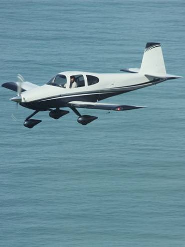

Robin, first time I actually went out to your site. Nice job, GREAT write-up... and I'm flattered that you used one of the shots as the background that I took of your plane while we were touring Hearst Castle, Morrow Bay, and Pismo with both our 10's.  Now that was fun! Flying back to Calif in the next few days for a visit. Hope to see you soon on a visit to Pecan.

Yes this photo is on my phone, iPad and website. I occasionally get comments about flying over all that water but you and I know we were on the shoreline shooting west.
