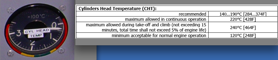

was awhile ago, but anyway it tends to show that the Russians had a
good idea what they were doing when they stuck the probe where they
did.
Lastly, Richard Goode mentioned that the cylinder head temperature
gages we use are far from being dead nuts calibrated units. I've
found that to be true as well (using a calibrated IR unit by Raytec
and also a Thermal IR video unit). What I found from a sampling of
5 spare probes was fairly consistent readings between probes, but a
big difference between gages. I did not even try to calibrate
mine, but instead just recorded where max temp REALLY was and put a
mark on the gage. We tend to put faith in what a gage is telling
us, but that is really far from true. Comparing cylinder head temps
from one aircraft to another (without first running a calibration
check on the instruments you are using) ends up being very much like
comparing apples to oranges.

I had what I considered to be somewhat high CHT on a VERY LOW TIME first run factory engine. This was with factory settings which I was loathe to touch. I'm in Western NY state, so you'd think average settings would cover me. I have checked and tightened various things, including cylinder and supercharger case gland nuts. The temps seem to have crept down. Maybe some of it is break-in, although Jill G. would say break-in is done on a test stand before it sees an airplane. Maybe I've gotten better at managing climb angle, etc.
Rick Volker has been around this plane and felt there was an issue compared with the Sukhois he owned. He also feels spinner and cowl play a big part. as you've read.
I did ring up Vladamir Yastremski (sp?), and he said my temps were well within acceptable limits, and to worry more about low temps. Dennis S. has said about the same thing in the past. Rick suggested test where I climb-out at Vy to 5000 ft. I tried that, and I kept it under 210 C, and then leveled off at max cruise, after which time it stayed in the high green. So that wasn't bad. Now keep in mind this was at 63 degrees ambient at the departure airport (KBQR 752').
About all of these jets: Richard Goode says they all need adjusting, and I think it was Sergei Prolegiev who suggested that I get it out of my head that it left the factory perfectly adjusted. I do have a slight hesitation when I feed power back in on final, but it's not scary. I have all of the different jets, if only I knew what I was doing. I was hoping one or two clockwise clicks on the cruise mixture adjustment would enrichen the mixture enough to make my plane and I happy. I do have great fuel economy, so maybe I'm lean.
Here's my gage and the Yak-UK translated DOSAAF manual I usually go by. Remarks, anyone? -Eric

1. I have seen where adjusting the accelerator pump jet will cure hesitation on throttle advancement versus just plugging the darn thing, which was the initial cure until smart people figured out you could buy a jet kit and adjust it accordingly. I am VERY familiar with this kind of thing because you run into it a lot adjusting a Holley carb where there are many MANY adjustments for the amount of fuel you dump in when you move the throttle plates.
2. The main jet or "Compensation Jet" has the ability to dramatically change fuel mixture in the mid to high range of engine RPM.
I would very much love to hear Richard Goode go into more detail on how he determines how much change to make based on engine indications. He obviously has way more experience than I do. I have seen it done ONCE... but it worked, in a big way.
