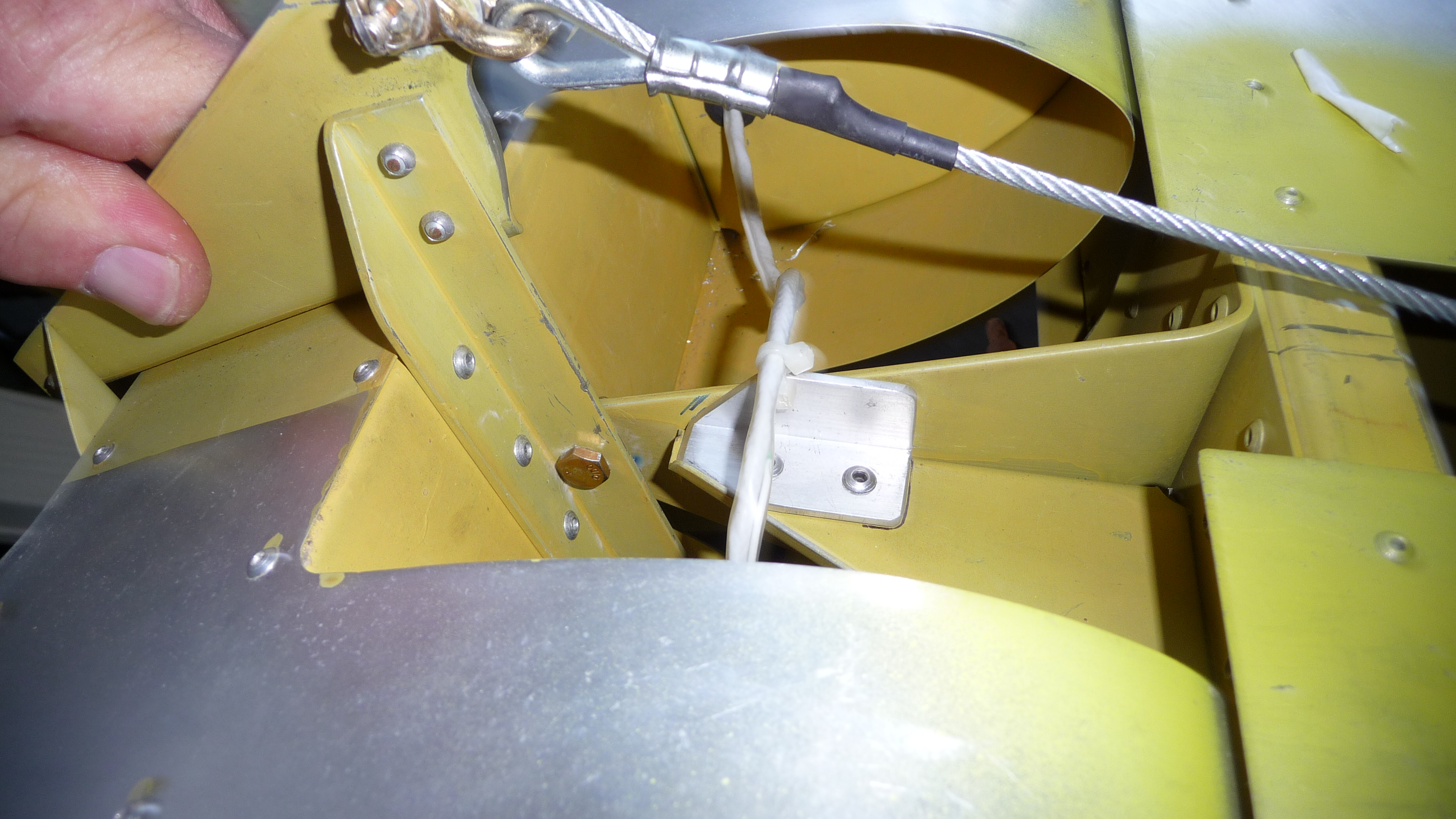

ruruny(at)aol.com
PostPosted: Wed Oct 13, 2010 3:30 pm    Post subject: Lower Elevator cable rub Reply with quote
For the belcrank hitting the back seat I made a stop at the elevator itself and then when installing the control cables
adjusted them so the belcrank stops about a 1/4" from the seat back. For the cable hitting the baggage area, had the
same thing the bungee pulls it down and to the side to keep it from rubbing.

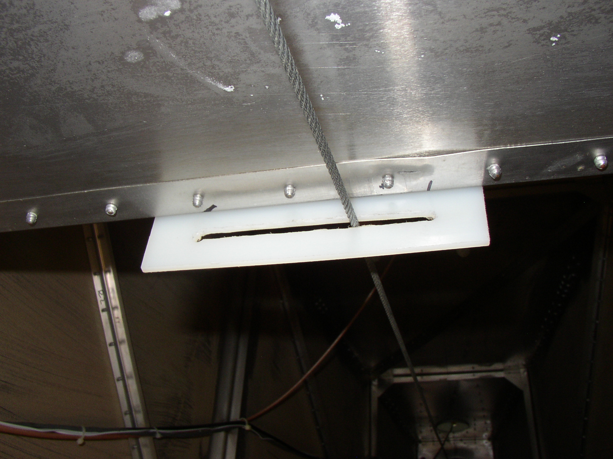

PostPosted: Sat Oct 16, 2010 8:18 pm    Post subject: Re: Lower Elevator cable rub Reply with quote
Stan,
I had the exact same issue regarding the elevator cable rubbing against the baggage compartment aft edge. I contacted Roger at Zenith and he says this is common. In fact, it happened on their demo plane.
The solution Roger recommended was attaching a nylon bearing on the bottom of the baggage compartment. This is acceptable if the cable deflection is less than 3 degrees. If it's greater than 3 degrees (unlikely for this problem), the solution gets tougher because a pulley is required. See the attached photo for my solution.
Regarding the seat back channel interference, could you consider installing a slightly smaller pitch control rod? The elevator bellcrank should be just a hair away from the seat back channel when the stick is full forward. Adjustments to the elevator full forward position can be done by adjusting your turnbuckles so the elevator is full down at 28 to 30 degrees with the bellcrank almost contacting the seat back channel.
Best Regards,
Dan Ginty
N787DG
