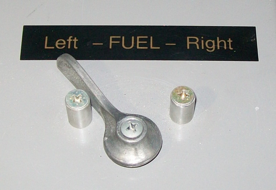

Here is my solution to the "hard to feel detent" on the Vans fuel selector.  I made two stops using tubing and countersunk screws.  Now the fuel is easily positioned from one fuel tank to the other even in the dark.
Jim Combs - N312F
 Filesize:  116.12 KB

If the fuel line ruptures up in the engine area, how do you turn the fuel off? Try to feel between the detents?
As many do not know, starting about 2 and a half years ago, Vans began sending a different fuel valve arrangement out with kits. There is now a spring loaded, lift-to-turn, handle with positive detents. IMHO it also looks a whole lot nicer than the old handle.
Bob Turner

Jim, how do you turn off the fuel in an emergency?
