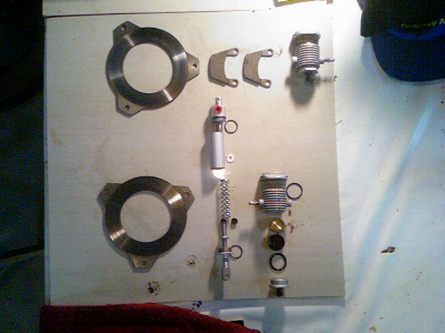

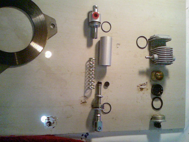

The brake system on our 4 year old plane was stripped down for inspection and to renew all the seals and O rings.
This is a straightforward task. One caliper needed honing due to minor corrosion. The other was done last year.
I attach a cellphone photo of the components and another photo showing the seals and their respective positions.

I did notice in your photos that you also disassembled the little master
cylinder. Why did you do that? Was there a problem with it? I do have a

I replaced all the seals possible. I think the plunger seal in the master cylinder is important as Brian suggests.
I had to pump the brake 3 times before startup to ensure I have sufficient pressure which suggests the fluid is slipping past the plunger seal. Then it would hold the 100 hp engine at 4,000 rpm for the mag check.

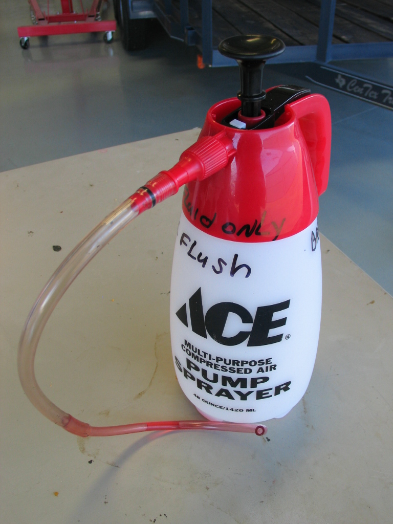

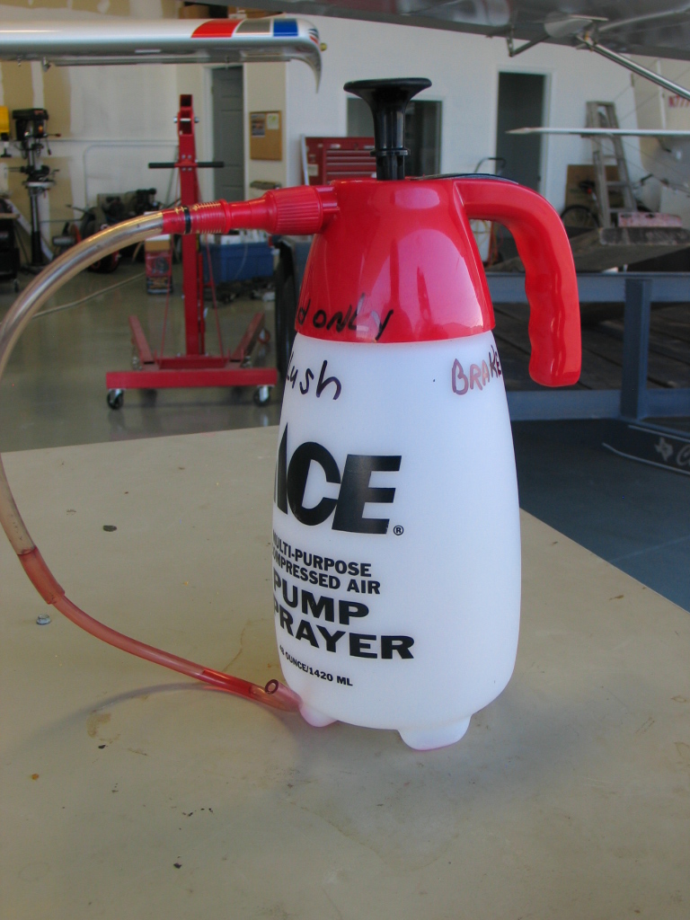

You should absolutely fill your system from the bottom up to float out the air in the system. You can use that little oil can and I did many years ago, but found a much better mousetrap so to speak for about $10. The oil can works, but is slow and doesn't always get the job done well. Here is an Ace Hardware one gallon bug sprayer. Just unscrew the tip and replace it with some clear tubing. Pour in the brake fluid which should be the 5600 aircraft brake fluid and never auto DOT fluid. Then pump up the sprayer with pressure with the little knob on top. Slightly squeeze the trigger and bleed any air out of the sprayer tubing. Attach it to the bottom break bleed valve on the bottom of the caliper, open the bleeder valve some and press the trigger. The system flushes so easily and fast that it sweeps all the air with it. I take a little water bottle with a piece of tubing taped in it and place it up at the reservoir and as the fluid flushes up and out with the air the bottle catches the overflow. I do both sides then get in and pump the brake handle or toe brakes about 10-15 times fast and fairly hard to move any trapped bubbles around. Then a quick second flush. Works perfect every time and never a any air left in the system. The fluid waste is only about 2-3 oz. The auto DOT fluid will eat your "O" rings and cause leaks in the tubing of your brake system. If you are having any issues with the brakes and seals and use the DOT fluids now you know why. This is one of my best tools in my shop for $10 and it takes no time and no hassle to bleed a brake system.
