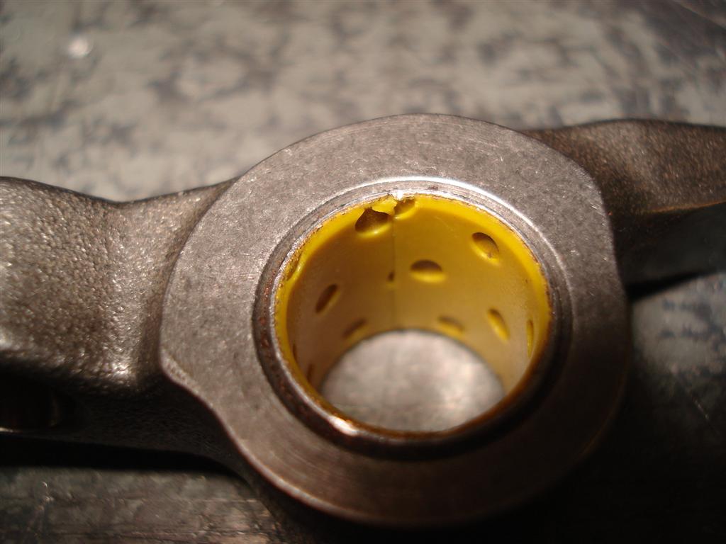

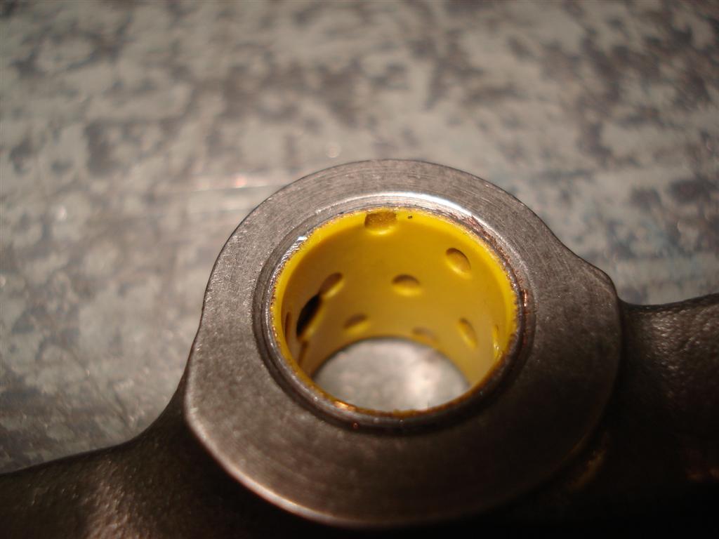

Received from Jabiru recently, this is news that they changed the bearing material for the rockers. However, some are reporting issues when this new material is used on the 'old' rocker lubrication system. Here's it is, for general information and awareness (if in doubt, call your Jabiru dealer):
Dear Jabiru Dealers and Maintenance Organisations,
We have recently introduced a new type of valve rocker bush material, as shown in the attached photos. This material has been used in South Africa for some time with no problems but we have found several cases in Australia where the yellow bush material degraded very quickly in service – within the first hours of operation. All the issues so far have been in hydraulic lifter type engines using the old rocker lubrication system – i.e. hydraulic lifter engines with an external oil feed pipe from the crankcase to the cylinder head and solid lifter types.
Engines where the oil feed for the rockers is carried by hollow pushrods are not affected.
There are no production engines of this configuration so at the moment this alert does not affect new production engines.
If you have fitted any of these type bushes to any engine with an external oil feed pipe please have the engine inspected and let us know if there are any issues. The inspection can be carried out by removing the rocker covers and checking the rockers for slop or for any yellow residue. We are also interested to hear if everything is fine, so please tell us how many engines you have checked and what the inspections found.
While the investigation is happening these bushes must not be fitted to any engine with an external oil feed pipe. If you need any of the old type bushes in a hurry in the meantime please let us know.

The pics attached show the new material (I admit to looking at my calendar to see if it was April 1st). I know I'm 'old-school', but what's wrong with sintered bronze (oilite) for this job? Swiss cheese, anyone?
C'mon Lynn, I bet you have a comment.....!
Cheers, Andy

I typed the above before I looked at the pictures. After seeing the
pictures, I can only say....What the (bleep)???
I guess this proves that the Australian mice/rats are bigger than the
African mice/rats. Smile
Yeah, Andy, my (home-serviced) replacement bushings have been working
just fine for over 800 hours now, in my antiquated external oil feed
and solid-lifter engine. There are times when engineers should just
use what has worked for years and years (plain old metal bushing
material) and NOT try space-age materials that perhaps haven't been
proven in the application.
cheese, anyone?
Cheers, Andy

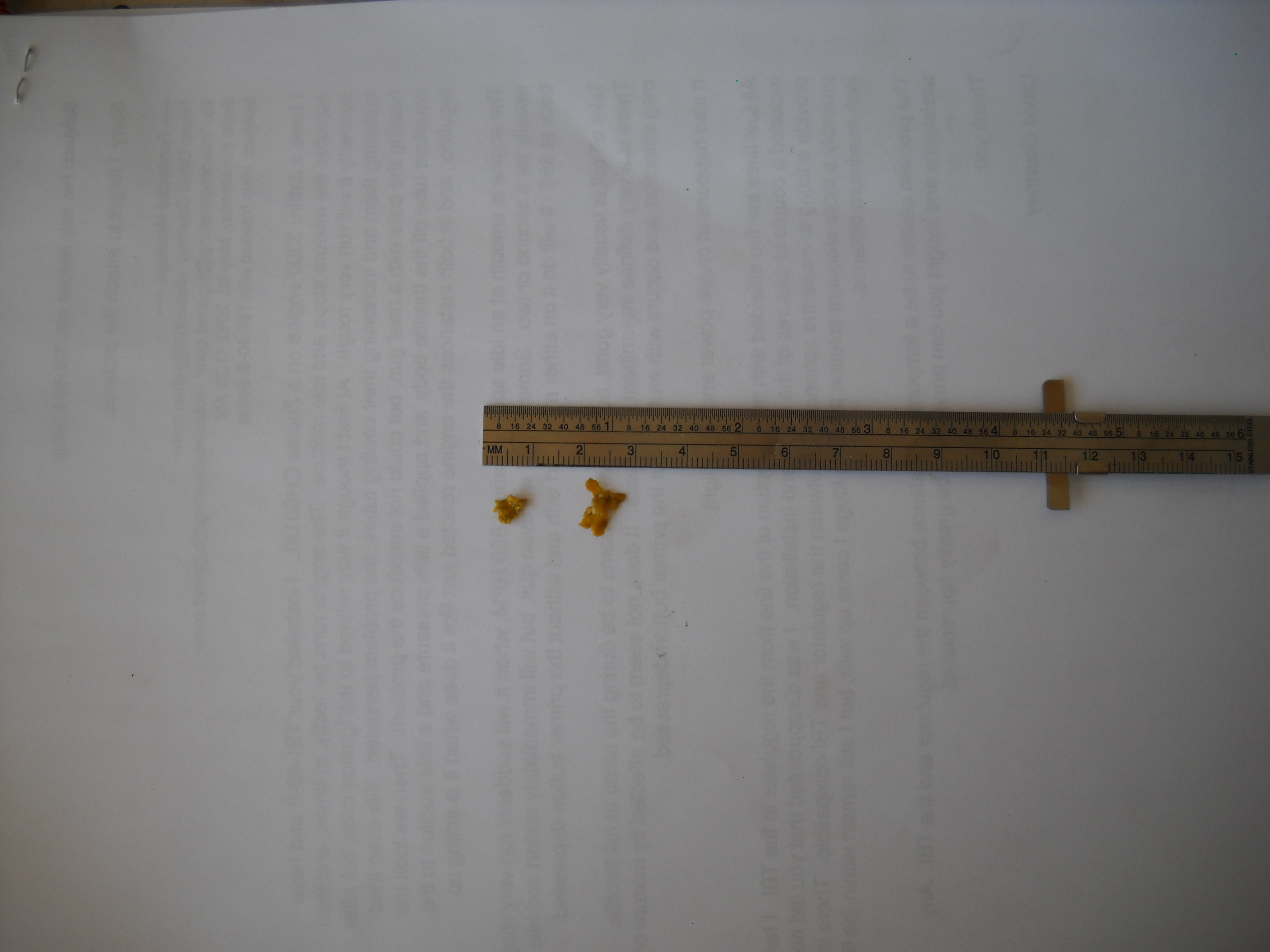

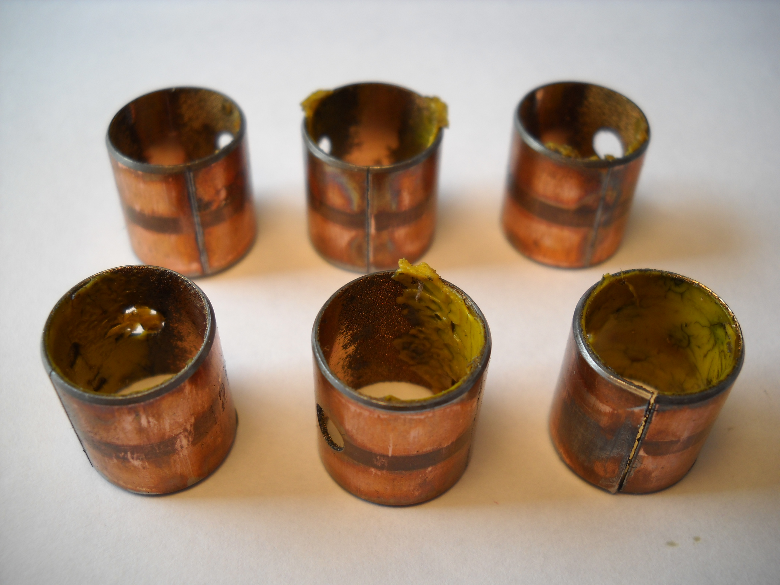

Jabiru's disclaimer that this has only occurred on external oiler engines is not true. I have a Jabiru 3300, Serial Number 33A1687. As part of a warranty repair to the heads which included replacing the slow-bleed lifters with quick-bleed lifters, Pete recommended that I also convert to the internal oiler upgrade, which I did. All head work was performed by Jabiru USA. After about six hours of run time I pulled the rocker covers to re-torque the heads and found a lot of bright yellow debris in the heads and oil filter. I called Pete and he told me it was just the ends of the rocker bushings, that that was "NORMAL" and "Wasn't a problem".
Although a little hard to see, this shows the multiple pieces in the oil filter.
 Filesize:  1.36 MB
 Viewed:  16446 Time(s)
These are two of the larger pieces behind the rocker cover.
 Filesize:  1.2 MB

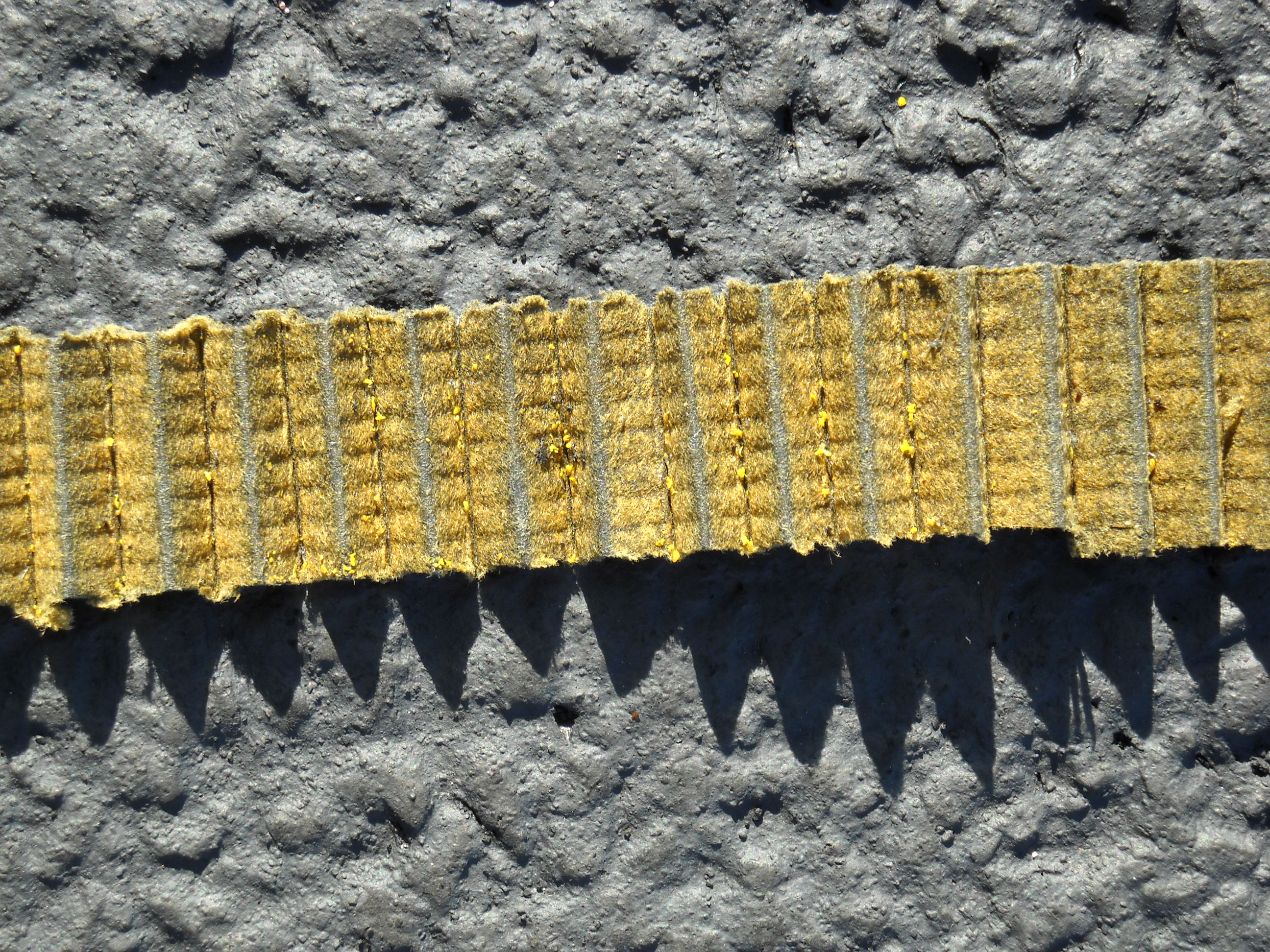

http://forums.matronics.com/viewtopic.php?p=390988#390988
http://forums.matronics.com//files/2_from_oil_filter_987.jpg
http://forums.matronics.com//files/1_from_rocker_cover_549.jpg

On Wed, Dec 26, 2012 at 3:38 PM, dacourtn <dacourtn(at)yahoo.com (dacourtn(at)yahoo.com)> wrote:
[quote]--> JabiruEngine-List message posted by: "dacourtn" <dacourtn(at)yahoo.com (dacourtn(at)yahoo.com)>

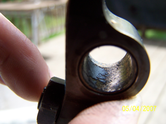

Because this topic is being posted on Matronics, I can add a photo to
this text (if anybody's interested) to show what the "Fox" had for a
rocker bushing problem back in 2007. I replaced the teflon-coated
original bushing material with store-bought bronze bushings, and
haven't had a lick of problems in that area for the last 5 years and
1100+ hours.
In this picture, the teflon coating has been worn away, and the brass/
bronze material underneath is starting to flake away, leaving the
flakes of brassy-colored material to be found in the rocker cavities.
Lynn Matteson
Jabiru 2200, #2062
Prince prop 64 x 30, P-tip
Rotec TBI-40 injection (sleeved to 36mm)
Status: flying with 1406 hrs... (since 3-27-2006)

Here is a picture of some of my rocker bushings (all 12 look the same) after only 10 hours of operation. These were installed as part of the internal oiler modification by Jabiru US.
Rocker Bushings With 10 Hours.
