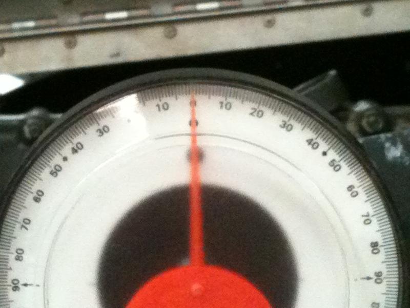

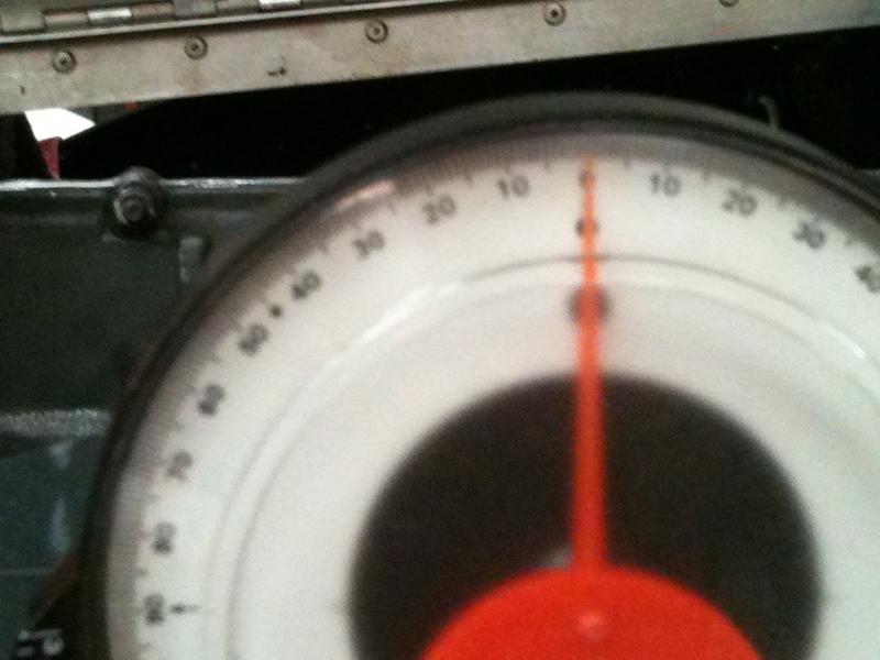

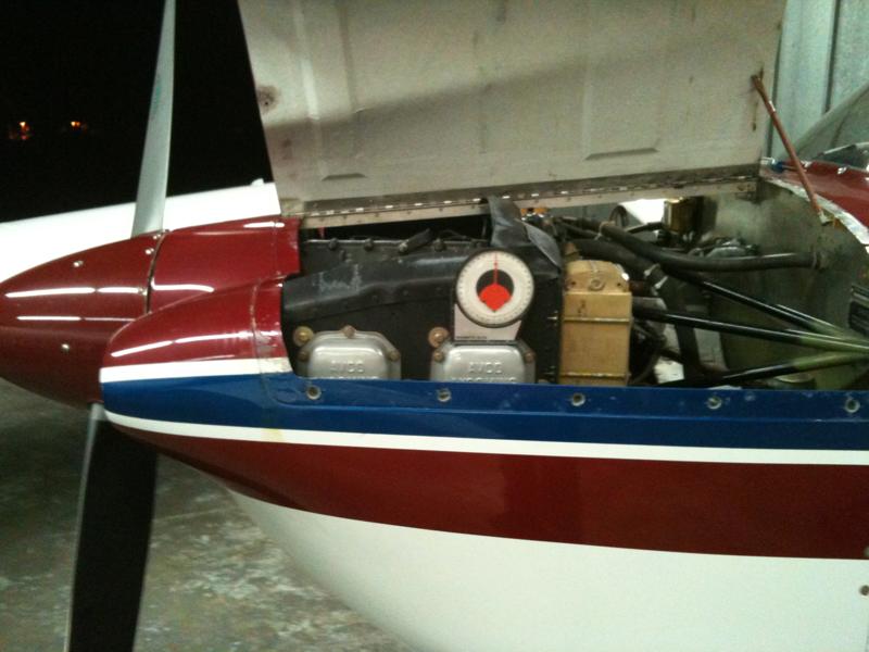

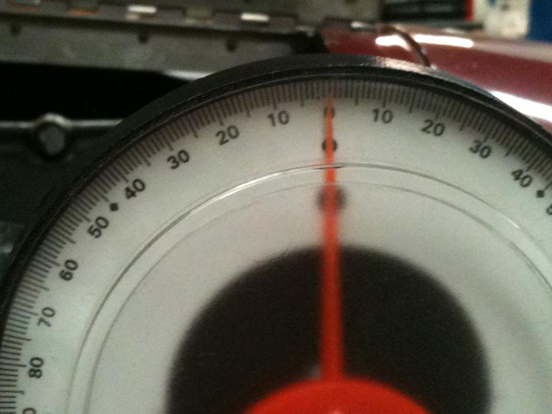

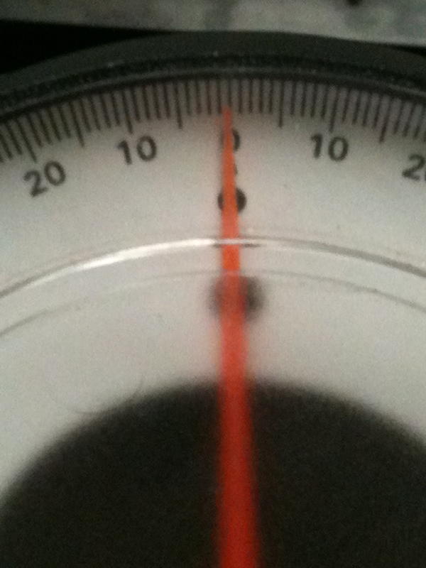

After spending something like 2 hours trying to figure out how to level the plane, now it was time to check the level of the engine.
I first set the magnetic angle finder on the #4 cylinder rocker cover.
Then #2 rocker
Then #3 rocker
Then #1 rocker.
For all practical purposes, the engine appeared to be aligned with the airframe. Mind you, I have 2 spacers on each of the top two engine mounts. Looking closely, the engine does appear to be negative thrust angle by less than 1/2 degree. The resolution is not great. I would have to say the needle was just a shade toward 1/2 degree down on all 4 rocker covers.
You draw your own conclusions.
