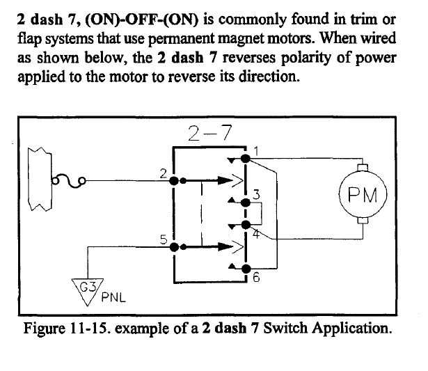

Does any one have a diagram of the new flap actuator switch wiring positions.
The plans only show the old type with the limit switches attached.
Thank you

Just wire it as a polarity reversing switch. Use a DPDT switch with a center
off position. The up and down positions should be non-latching (momentary).
Sometimes denoted as (on)-off-(on). Wiring here:
http://www.1728.com/dpdt.gif from http://www.1728.com/project2.htm
The right switch from B&C would be an S700-2-7.
I've attached an image from the AeroElectric book but you may only be able
to see it if you go to the Matronics web version of the list.
-- Craig

Thank Craig. It works very well. Very Happy
