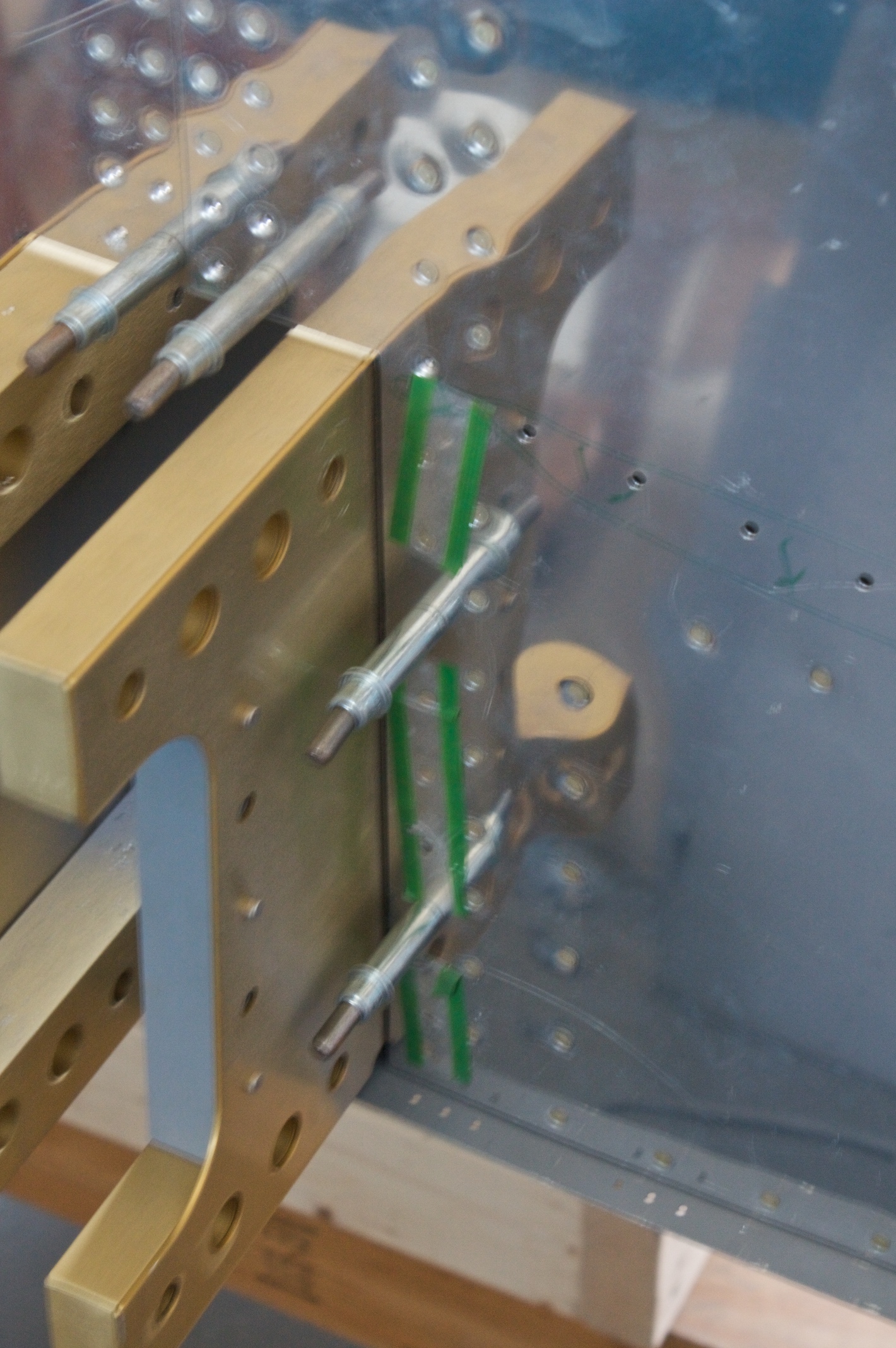

What have others used for a rivet set to get the rivets on the fuse
skins next to the spar carry through in the attached pic? I don't have
a swivel flush set, but maybe that would work?
-Sean #40303

PostPosted: Mon Nov 15, 2010 8:54 am    Post subject: Rivet Set Recommendation? Reply with quote
I believe I'd back-shoot those...
neal

The shop side of these are inside the side channel, so they can't be
back shot. The forward ones can, but not the aft side.

I used http://www.yardstore.com/browse.cfm/4,3673.html
The face is curved enough to give you room for the rivet gun and still
keep it flat on the rivet.
PJ Seipel

Thanks for the link. For some reason the Yard Store slipped my mind.
I'm wondering if I'd get additional use out of a flush "C" set which
also seems like it would do the job.
http://www.yardstore.com/browse.cfm/4,3664.html
-Sean #40303

I worried about those rivets and put them off for a while, as well as the rivets around the rear spar attach. Turned out though that my Avery swivel flush set worked fine. I pushed the rubber guard up against the spar, and there was just enough room to get good meat on the rivet, if that makes sense.

Just an update for those not to the fuse side skins yet. I actually
went with the 7 1/2 inch version of what PJ linked below just to make
sure I cleared the spar with the rivet gun.
http://www.yardstore.com/browse.cfm/4,3741.html
This worked great for the fuse side skins next to the spar. I wish I
had this set when doing the bottom wing skins next to the flap attach
also. One note, that is similar for other longer rivet sets. It takes
quite a bit more pressure with the added length. This is one of those
places that I wished I had gotten a 3x gun instead of a 2x.
-Sean #40303 (long and nasty section 29 almost complete)

on the rivets near flap hinges and these. Already had this tool and did not want to buy another tool for just a few places. Just put masking tape over rivets to help keep it from sliding, have a helper on the other side and keep your set straight.
