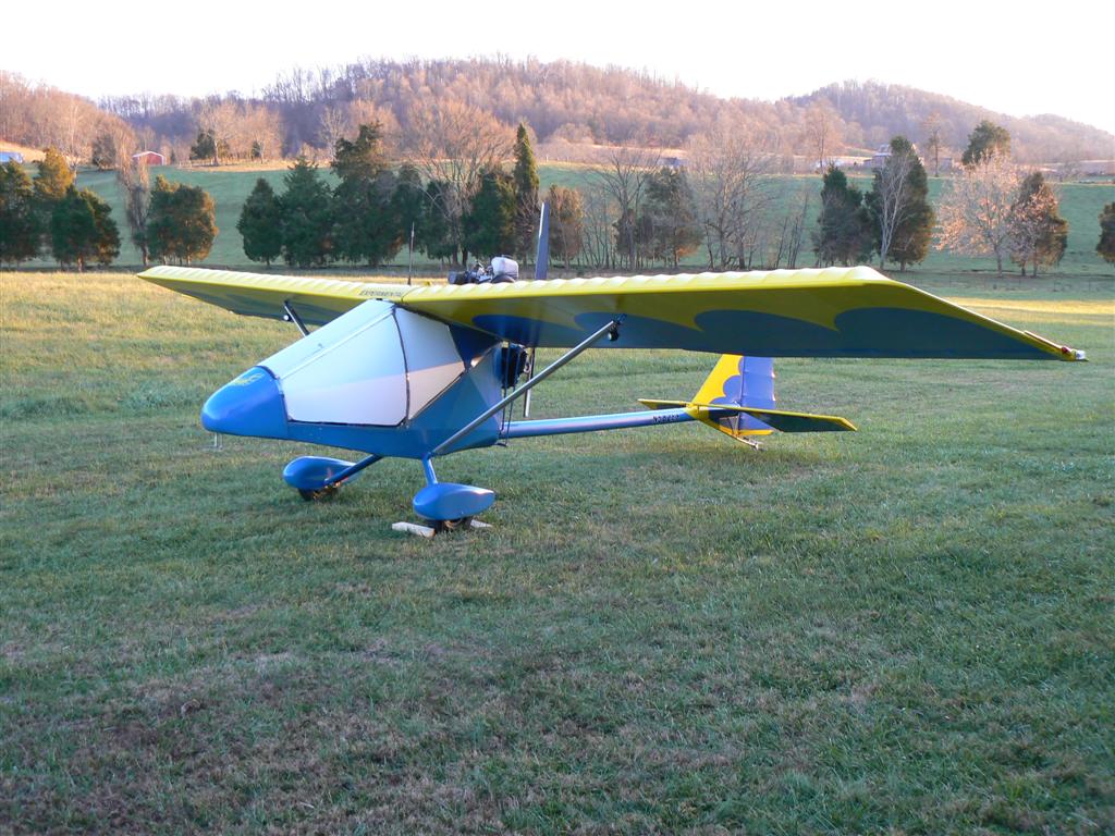

And for a bonus - was planning to wait a few days until the final touches were done, but today we had it all together getting ready for the inspector and a couple more details, so took a few pictures and here she is. Before and after pictures. Haven't even pulled the plastic sheet off the Lexan yet...
