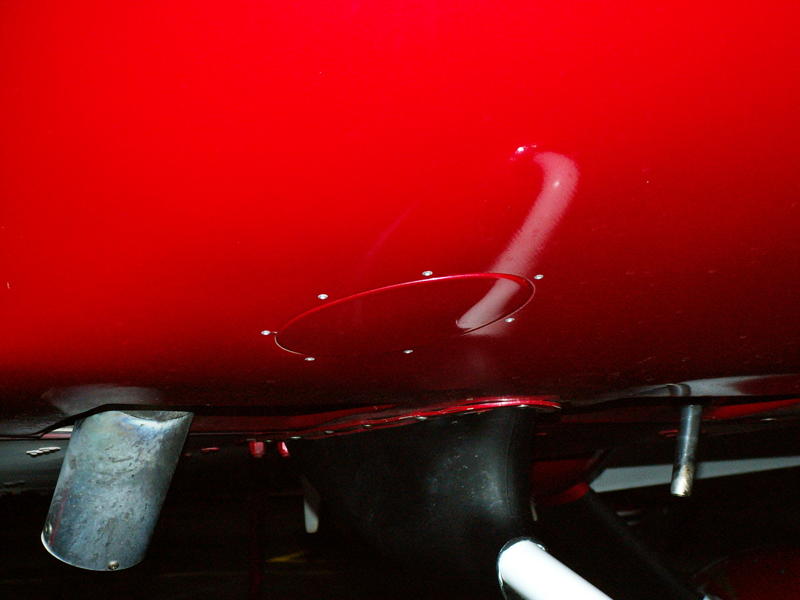

You'll need to notch out the right cooling exit ramp. I've about 20 templates that I use. For one reason or another, not one seems to fit all applications. I make a fillet for the hole left when removing the stock exhaust pipe. It's fiberglass, contoured to fit. Painted, you can't tell it's there.
