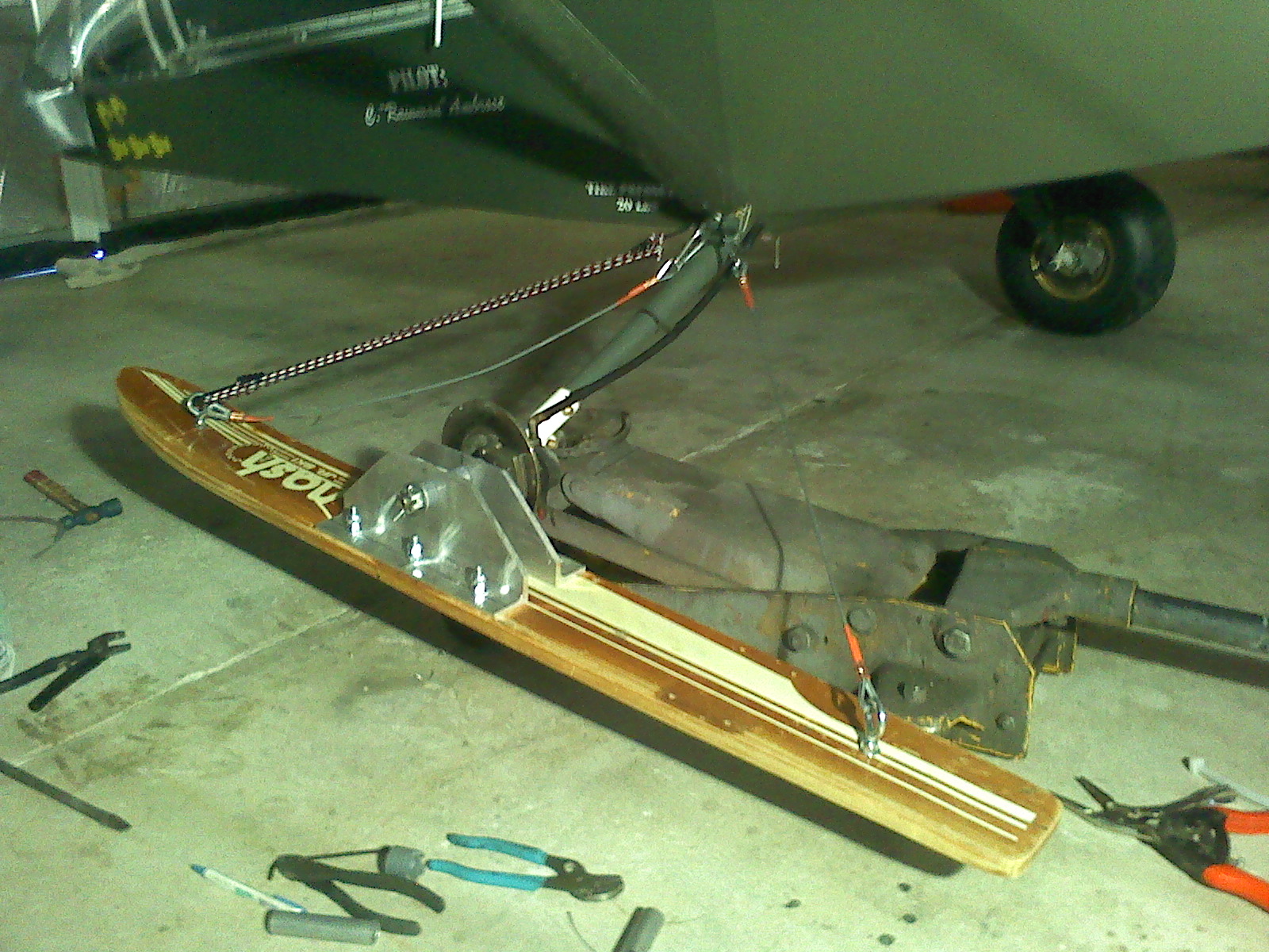

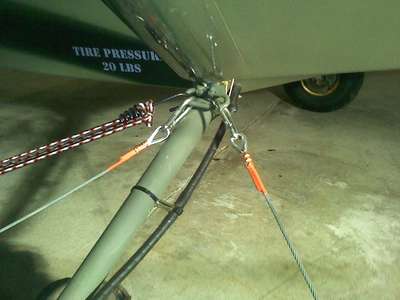

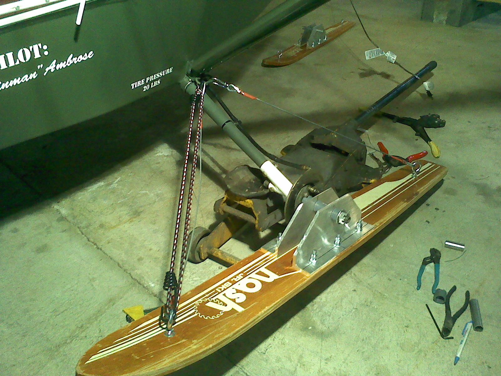

Well guys,
the shooting gallery is open ! What do you think of the new skis ? The Right ski will go much better now that I know what I have the left one done....Can't wait for snow ! These are made for going on snowmobile packed snow on Houghton Lake,,,no glacier hopping...lol

Chris, it looks like you did it right with the skis.

Chris,
I did the same thing with my Firestar about 5 years ago, but only flew it a couple of times before removal.
The first thing I found out was the plane felt a like flying tank in the air, scary to bank at any angle, so be prepared. I also found out the importance of putting some runners on the bottom of the ski's to keep the plane going the way you want it and not being blown sideways in any light crosswind. My only suggestion would be to install maybe (3) boogie wheels on top of the ski's that go thru the ski, so that pavement landing or taxi is possible. I ended up making wheeled carts like whats found at HF, just to push it from the hanger to the snow.
My conclusion was to just land on the beat down snowmobile trails with my wheels, hoping for no engine outs over the large farmland areas we have here.
If anyone wants to try my ski's, they are available. Pick up in For Atkinson, WI.
