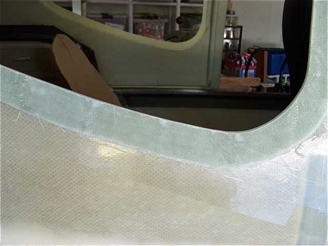

[img]cid:ii_12d1a1f39b2644ec[/img]
A 1/4" thick moulding is formed with fiberglass over the outside of window cutout.

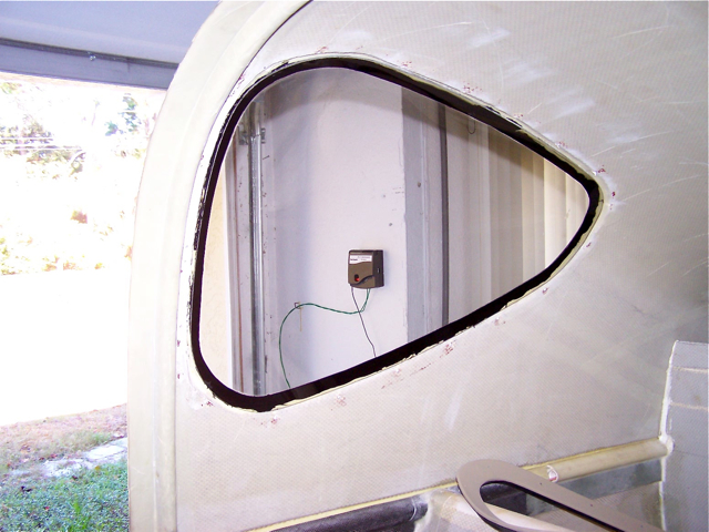

[img]cid:ii_12d1a22352d74782[/img]
I used packaging tape as mould release.

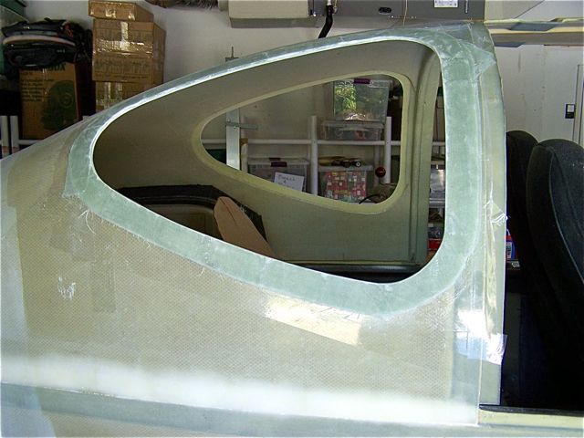

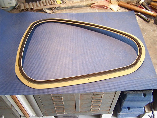

[img]cid:ii_12d1a24ccf552b29[/img]
Rubber gasket applied to the back of the moulding.

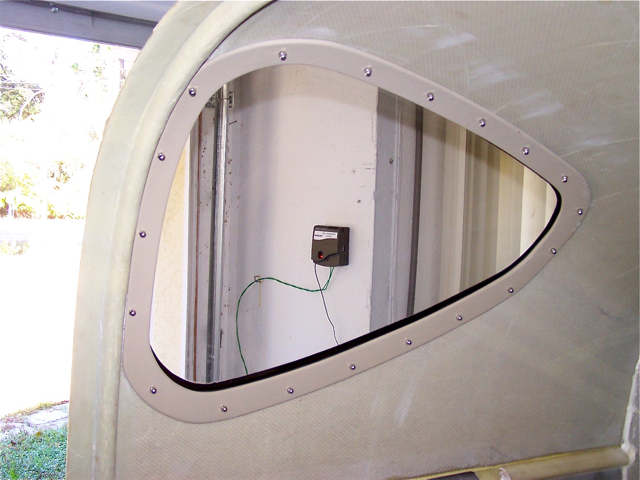

[img]cid:ii_12d1a27f4e7da4e9[/img]
Moulding is attached with 8/32 ss screws and ss acorn nuts.

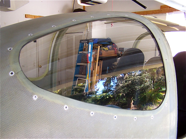

[img]cid:ii_12d1a2aa9a11c923[/img]
Outside view.

I did basically the same thing, except I bonded the inner frame in. I can peel it out with a heat gun if I ever need to replace the window and then make a new frame pretty quickly.  I think the most time consuming part for both of us would be getting the old window out and cleaning off the 3M window adhesive.
I put some silver trim tape around the windows. I think it looks great and it saves the time of cleaning up the intersection of the window and fuselage skin.
