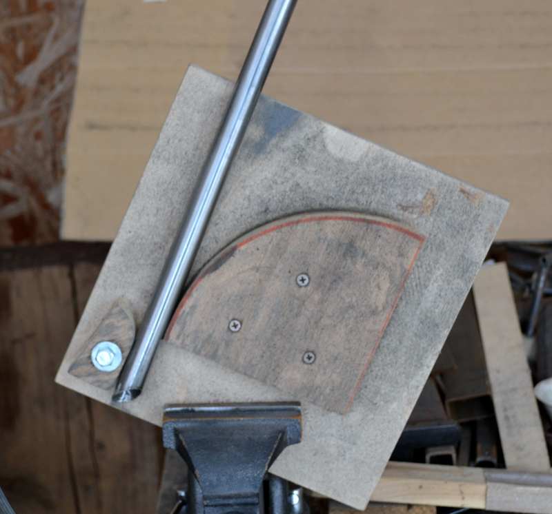

I finally got out to my shop and took some pictures of a tube bending jig. It is made mostly from 3/4 inch plywood held together with screws.
It really is easier to bend tubes with this jig than to describe the process. Just fill the tubes with sand, cap them with wood plugs, and bend a little bit at a time. After bending at one point just move the tube a few inches and bend that point. If it is bent too far spin it 180 degrees and un-bend a little.

PostPosted: Tue Jan 04, 2011 2:04 pm    Post subject: Tube Bender. Reply with quote
Very nice, Paul - this one's a keeper!

PostPosted: Tue Jan 04, 2011 3:23 pm    Post subject: Tube Bender. Reply with quote
Paul:
LQQKing at your gig it does not look like it has a grove on the radius part - Good and bad, but really not needed.  To prevent the tube from twisting or rolling off the gig clamp another piece of ply to make a sandwich.  Works great and if there is too much friction with the tube just add a shim.
Barry

psm(at)att.net
PostPosted: Tue Jan 04, 2011 3:31 pm    Post subject: Tube Bender. Reply with quote
Hi Barry,
Yes, you are right. There is no groove on my jig.
I have not had any problem with tubes wanting to twist while bending. I also haven't noticed any large amount of flattening of the tube. I guess it is all about bending a little bit at a time.

Scotsman
Joined: 27 Aug 2007
Posts: 89
Location: Johannesburg, South Africa
PostPosted: Wed Jan 12, 2011 8:51 pm    Post subject: Re: Tube Bender. Reply with quote
Paul you are a star..I set up your jig a la the photo earlier on the thread and it worked really well. Like you mentioned earlier it is an iterative process (slowly slowly) but the result on the front hoop is that it is a pretty exact match to the shape of the canopy.
On the subject of the groove mentioned earlier it is not necessary. I also found that the 19mm shutter ply dented in after several bends to form a small gentle bend that maybe helped.
If I had to repeat this exercise I would probably bolt both elements to the jog instead of using screws as the screws seemed to provide a little "give" which does really help the process.
PS. I didn't notice any flattening of the hoop and I did not fill the hoop with sand (which I probably should have done).
