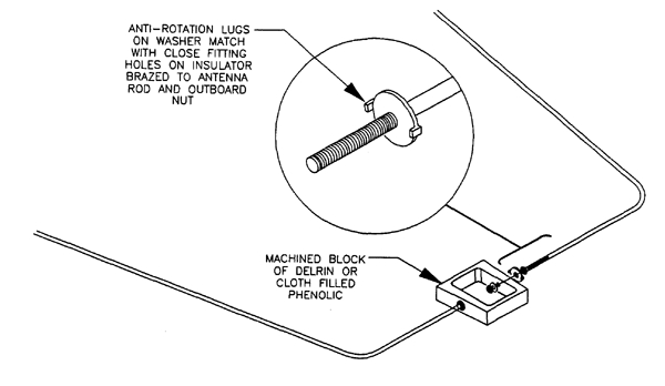

I recently aquired a Narco NAV 11 in perfect working condition (just had it tested). i have checked out vor antenna prices and they are extorsionate. i was wondering if it is possible to DIY a vor ariel and if there are any web based resources/plan for making one.
Sure. Make your own 'cat whiskers' from suitable
steel rod. CB antennas can be salvaged for their
corrosion resistant parts. Fabricate a BALUN as
described
http://www.aeroelectric.com/articles/BALUN/Balun_Fabrication.html
Make an insulating configured to fit to your
airplane . . . usually the top cap of a
vertical fin. Fabricate fittings (silver
soldered to your 26" 'whiskers') to mount
the antenna elements to your fin cap with
about 45 degree sweep-back.
[img]cid:7.1.0.9.0.20110125133852.01f8cc88(at)aeroelectric.com.0[/img]
Attach BALUN to interior ends and route coax to your
VOR receiver. The anti-rotation scheme shown above
is perhaps not sufficiently robust. I think I'd silver
solder the whiskers into a 5/16 or 3/8" threaded stud.
