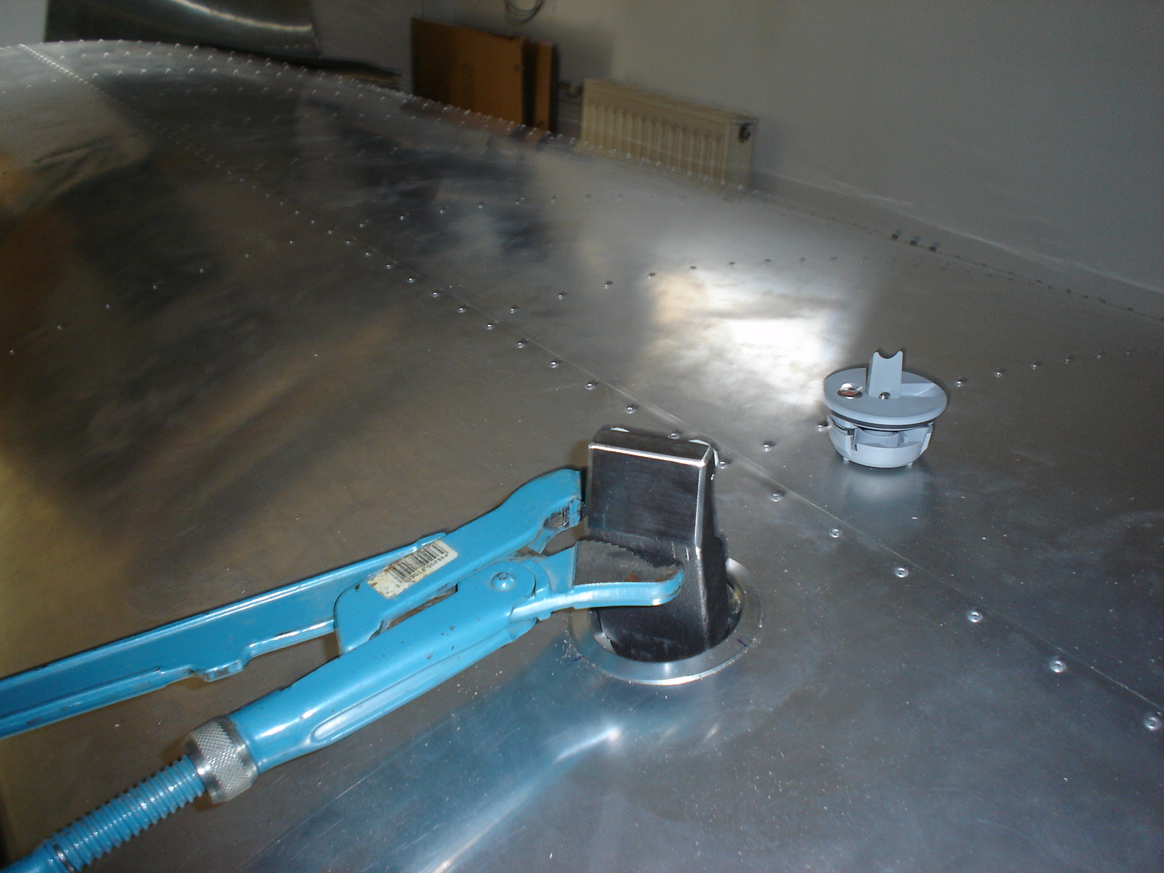

Hi Don,
I used a modified bucking bar and a lot of power.

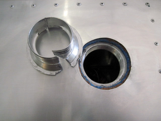

Boy! Did I speak too soon. I finished the right wing and hauled the left into my shop to begin the modification process yesterday. I used my trusty piece of shaped oak to remove the fuel filler neck but could only get it to budge a little. I tried everything I could think of to get it out with no avail. All I succeeded in doing was breaking my tool and practicing some words I haven't used in awhile. In the end, I used a hacksaw blade and cut it out (see pix). Fortunately the threads in the fuel tank are salvageable so I asked Zenith to send me the "Big Tap" when they sent me a new filler neck.
The other tank came apart without any trouble so I have no clue as to what caused the problem with this one. Those darn aluminum to aluminum threads are a real pain. I hope I never have to open the leading edge again!

Ablebob - I checked the threads in the tank. They are not steel - appears that the problem is still aluminum / aluminum galling.
Tim
