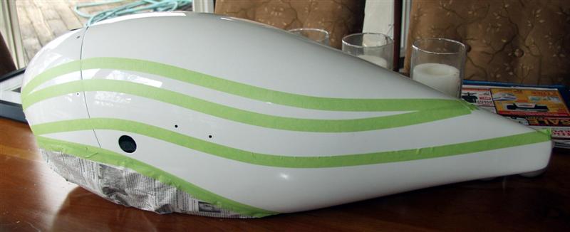

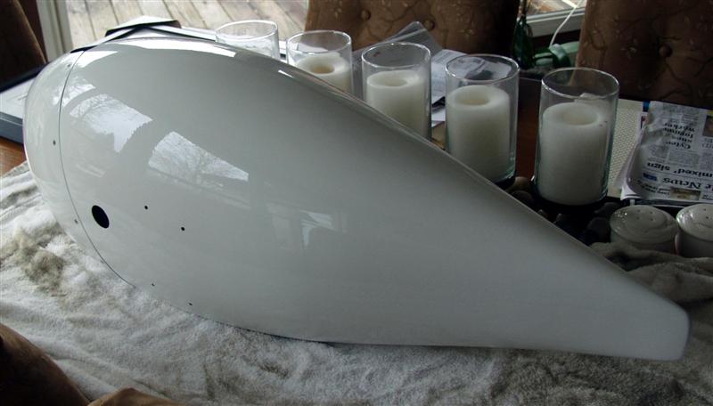

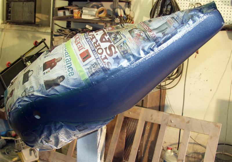

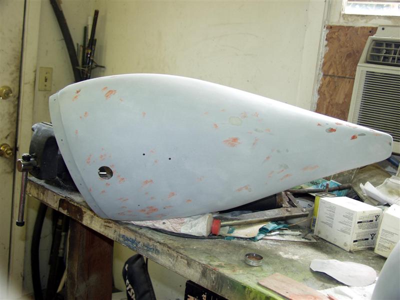

From the replies you've received and your response, I think you'll do just fine -- just don't blow yourself up trying to heat your paint both with open flame in cool weather!!
Your original query was about Imron vs. PPG. When Imron first came out many years ago, it was the rage cuz it was so tough. Then urethane base/clear came out, and for some reason the car painters (around here at least) never used Imron again. I started painting after Imron was no longer in vogue, and I used PPG with great results for years. Then my supplier got tired of PPG's high expense and now only deals in Dupont -- so Dupont is what I've been using lately.
As I'm writing this, I'm waiting the 30 minutes between the second and third blue stripe coat -- Wes trashed his nosewheel pants in a hard landing, so I'm finishing up a new one. I'll include a couple pics of these steps. I've taken pictures of the process from patching the fiberglass (he landed with a low air nosewheel in a trial fit and the tire caught just enough of the back of the glass to break it out) to present -- so if anyone is interested I can send or post all of them.
This is Dupont's Centari Acrylic Enamel with gloss hardener added. I like it (or urethane enalmel) better than base/clear for the plane due to the weight of clear, and the ease of touching up the one step paints.
One more comment: As you can see, I also paint in pieces in my backyard shop, and I still use lots of newspaper for these small pieces, covering windows, etc. But for covering the fuse and wings for doing stripe work, I agree that plastic or roll paper is the way to go.
Later, - Lew
