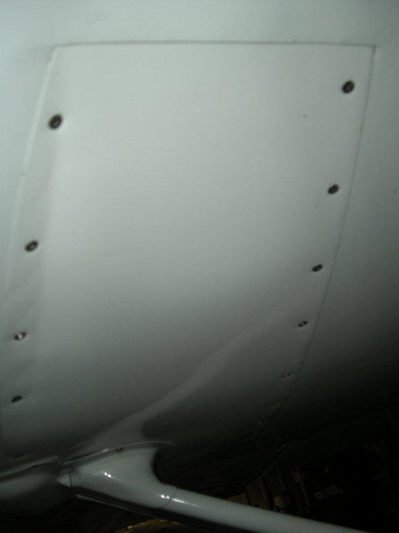

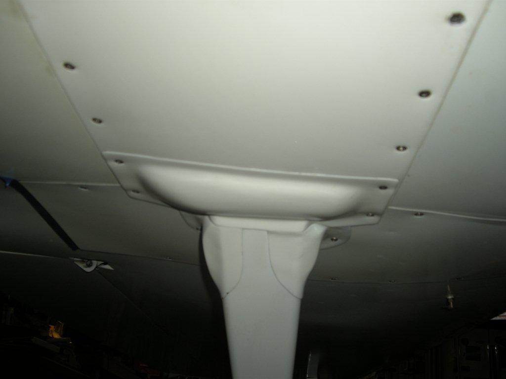

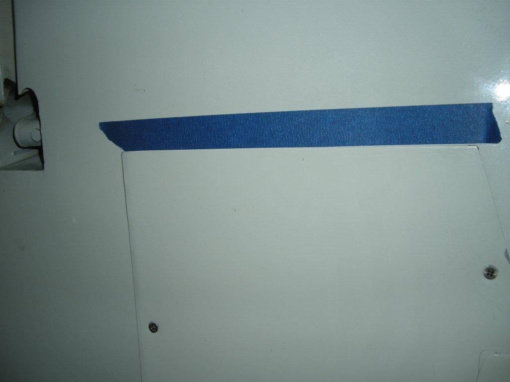

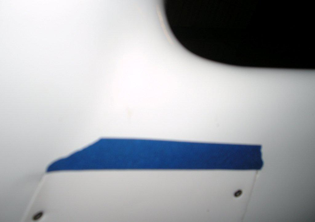

These photos are of the bottom of the left wing.
002) From the front to rear.
003) Leading edge to fuselage fairing, the blue tape is at the back edge of the fairing. The plate is about 3/8" into the underside of the fairing. That makes a smooth ,secure joint.
004) Trailing edge, the blue tape is at the end of the plate. You can see the hole for the flap attach horn.
005) Bottom spar box cover toward the left wingtip.
I am happy with this system and they have held up well, since 1998. When they are removed, every thing is exposed for inspection.
Rich is correct, of course, you can make them from glass off the top of the wing. I wasn't smart enough to figure that out.
Good luck on the repair,
Tim

Thank you for the photos Tim. Appears to me that any paintable flexible material will do the job.
The port rear wing root cover (Part # KL10) also needs quite a bit of mending, but that is fortunately not structural.
