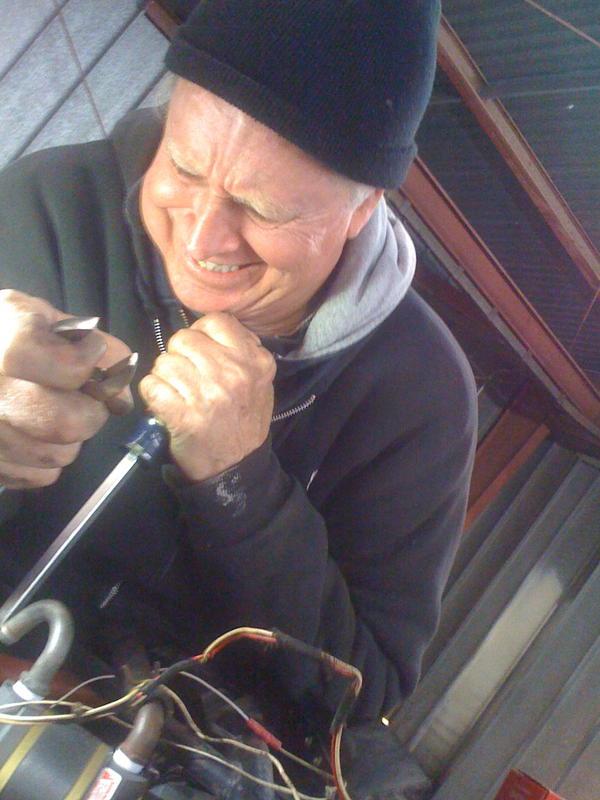

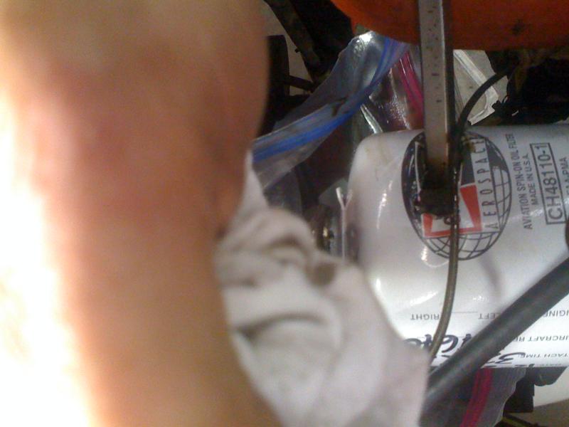

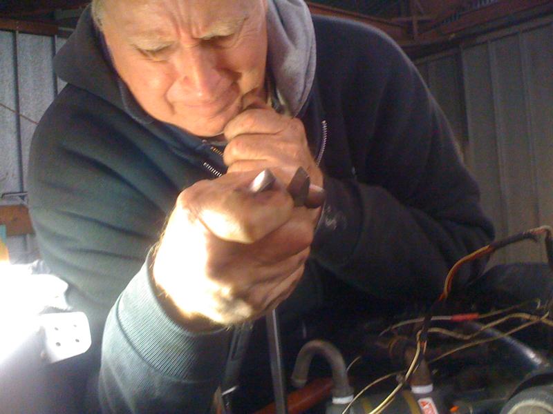

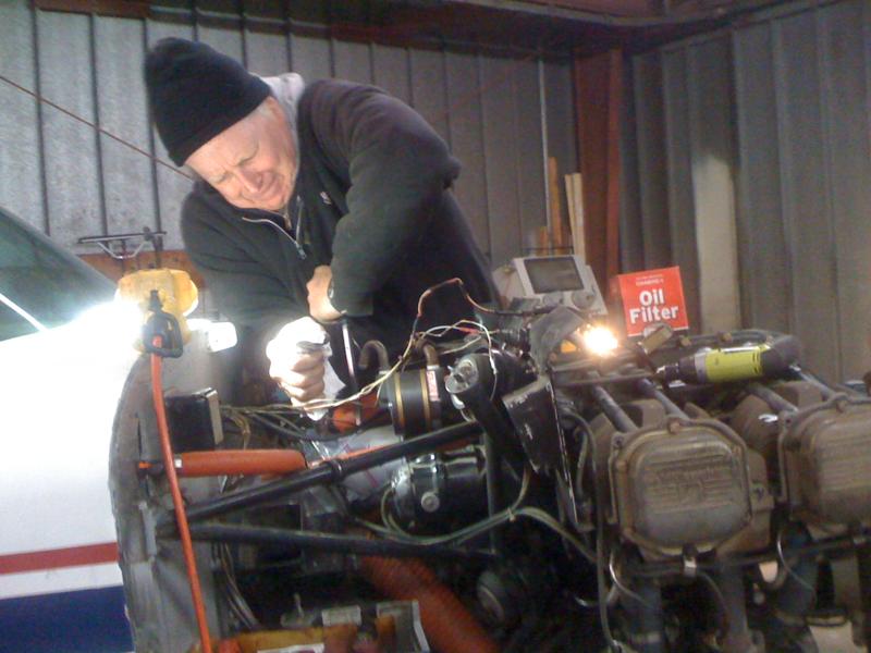

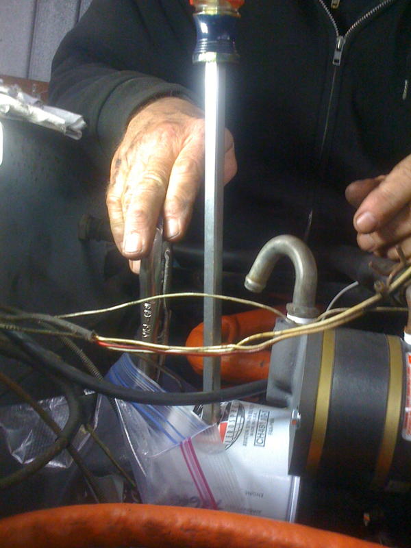

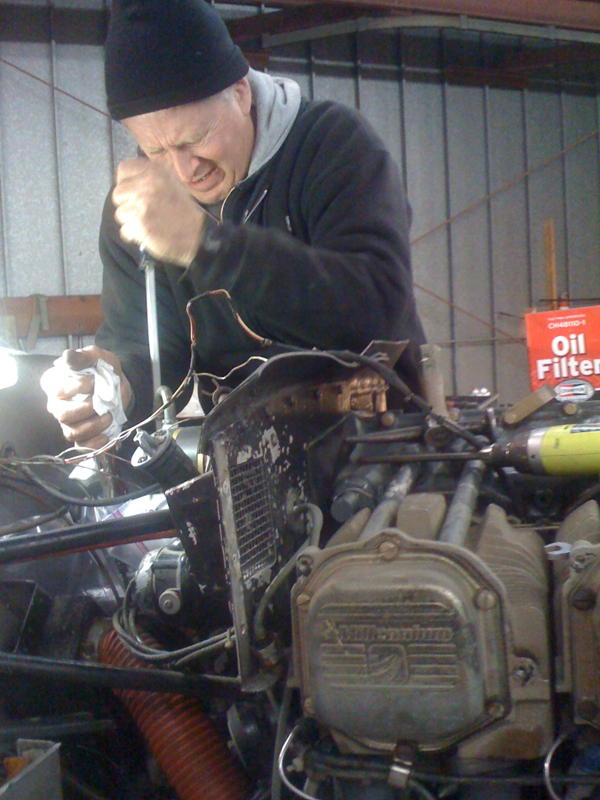

I just spent an hour REMOVING an oil filter.
About the only thing that would have helped would have been the old style strap type oil filter remover. I didn't have one.
I started out using vise grips with a 7/8 inch wrench as a breaker bar extension. I got the nut on the filter pretty much rounded off. Then, I got a 24 inch screw driver and punched through the oil filter. With both working at the same time, I was able to turn the filter about 1/4 turn. Then, it stuck again and all I did was end up tearing the oil filter. I then punched all the way through and was able to turn it about another 1/8 turn. Then I punched a new hole an inch from the other but this time all the way through. I was able to turn the filter another 1/4 turn. So, now I used the holes on the bottom and pushed the screw driver through. With the vise grip and the 7/8 inch wrench, I was able to get it another 1/2 turn. From there, I used the vise grip and was able to turn the filter. The filter did not come off the gasket for another turn. This filter was so seriously over tightened that there is no describing it.
PEOPLE, YOU DO NOT NEED TO TIGHTEN THE FILTER PAST GASKET CONTACT PLUS 1/2 TURN. IT WILL NOT LEAK. IT WILL NOT COME OFF.
See pics.
This isn't the first filter I've had to resort to extreme measures to remove. This is the tightest one though.
