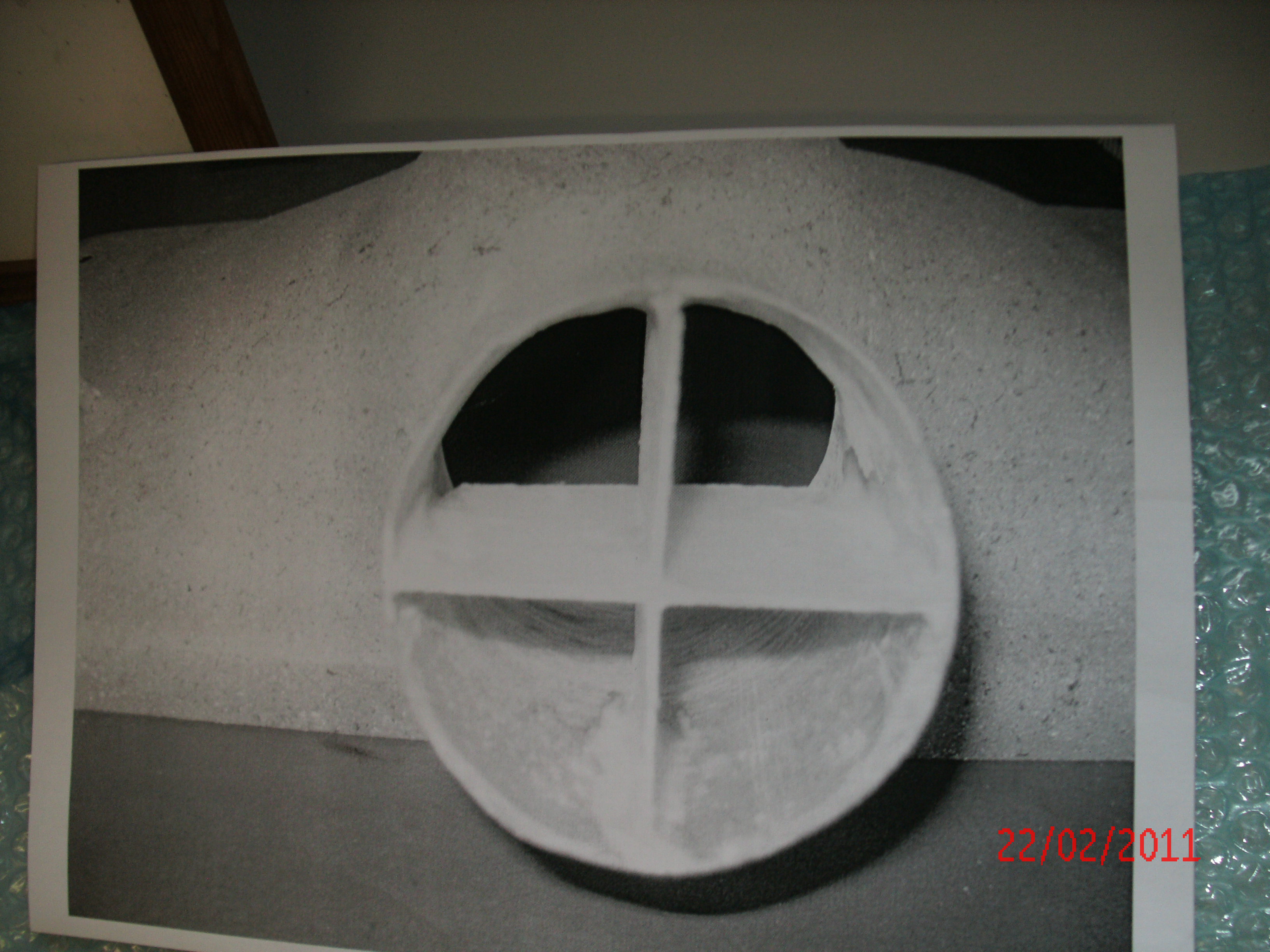

Have you tried a cross insert in the airbox outlet pipe, this has helped a lot of people even out their EGT's. Just epoxy in some .5mm Al or use thin glass
 Filesize:  1 MB
 Viewed:  11640 Time(s)

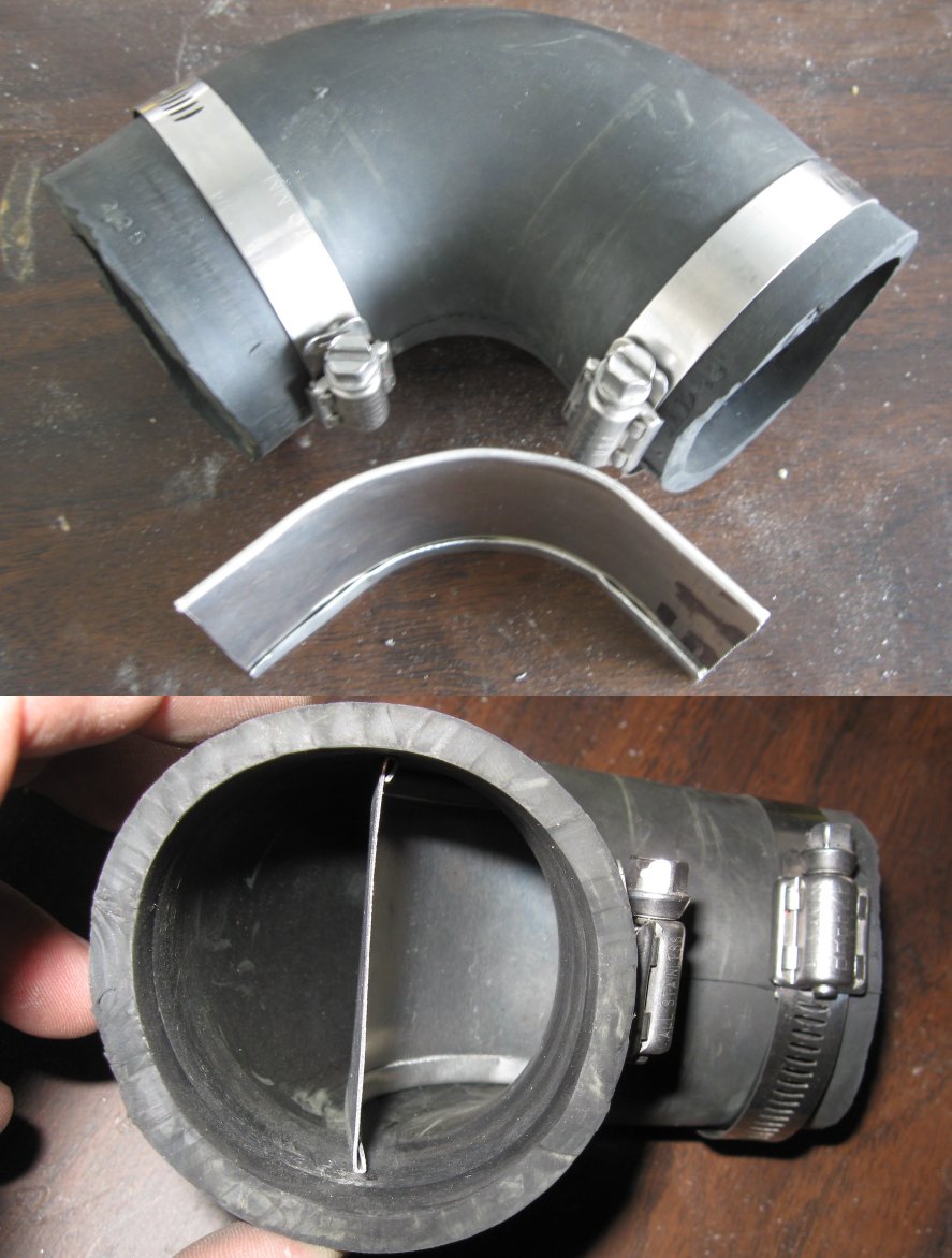

PostPosted: Tue Mar 15, 2011 6:44 pm    Post subject: Re: Radiator Hose for Intake and 1,3,5 lean Reply with quote
The flow divider I put inside the Intakehoses.com rubber hose was the best improvement I found for getting left/right bank mixtures and temperatures closer together. This is an old picture showing an early divider. Instead of using .025 and folding the sides, I am now using a .050 piece of aluminum with beveled sides as to not cut into the hose. Been going strong for almost 170 hours and three years now.
Good luck,
 Filesize:  148.44 KB
 Viewed:  11570 Time(s)
David Gallagher
