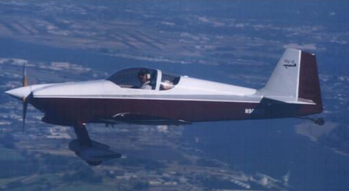

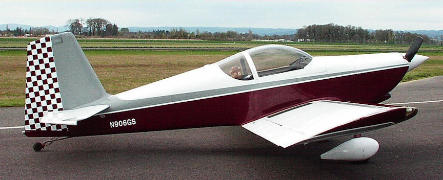

PostPosted: Mon Mar 14, 2011 7:22 pm    Post subject: -6,-7,-8 Empennages interchangeable? Reply with quote
Some of you might remember when a few years ago I retro fit a RV-8 emp
to my RV-6. Was pretty simple to do just had to back mark new verticle
spar to
match the hole in fuselage bulkhead. Also had to redo the tail fairing
to make it fit.
Jerry

PostPosted: Mon Mar 14, 2011 8:42 pm    Post subject: -6,-7,-8 Empennages interchangeable? Reply with quote
Need to make correction, I only retro the rudder and vertical stab, not
horizontal.
Jerry
