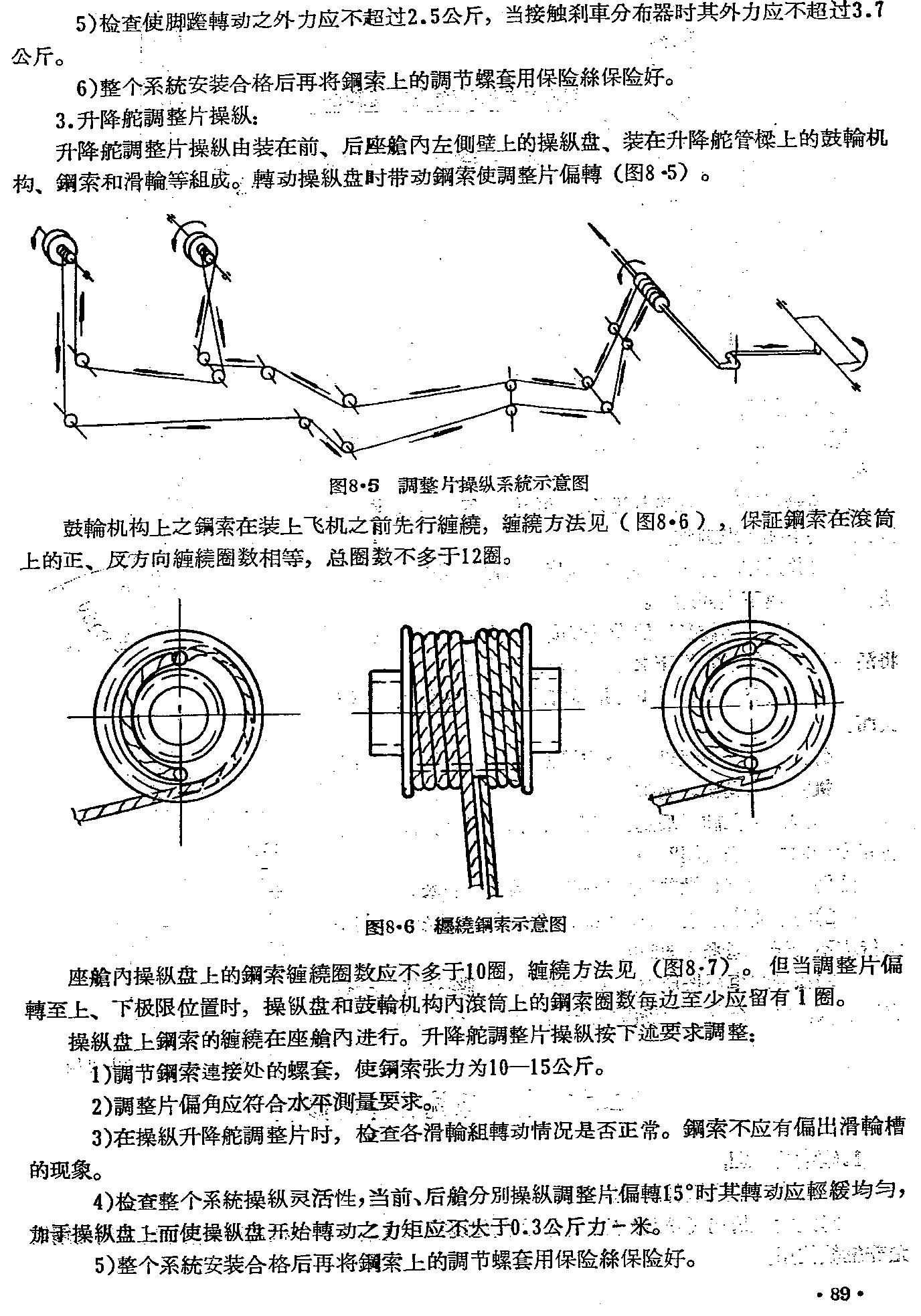

Hi
I have to fit a new trim cable to my CJ6 but the problem is that its all unwound from the trim handles and the barrell down on the elevators.
Does some one know how many times its wraped around each one?
And the best way to do the job or someone mite have a diagram?
Thanks Daniel

Daniel
Trim cable routing from Chinese manual
