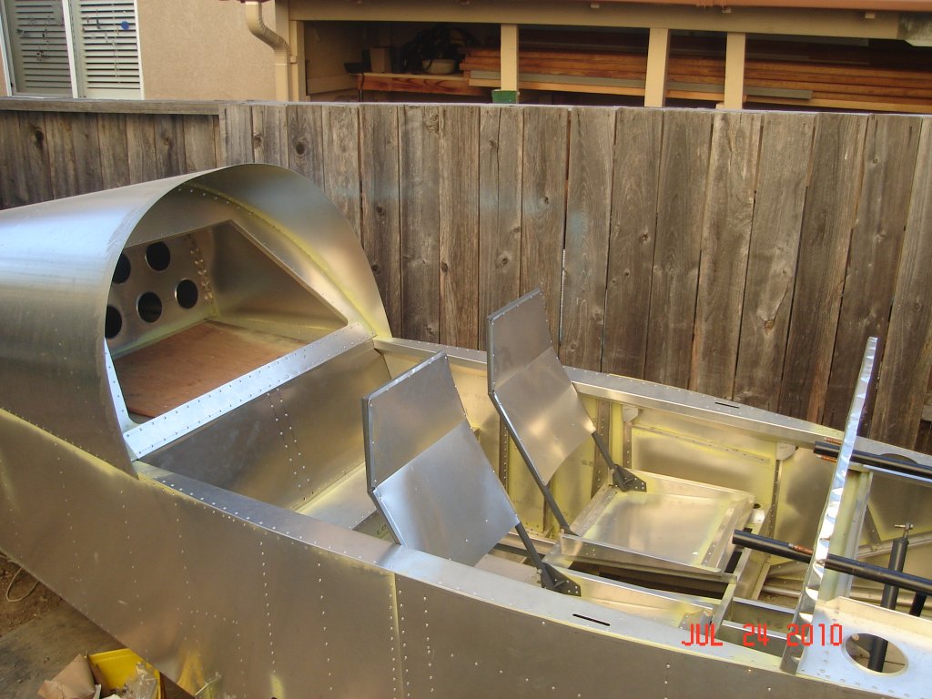

Good luck with your build. The attached picture shows the status of my fuselage last year. Please let me know if you have any questions, and I'll be happy to answer.

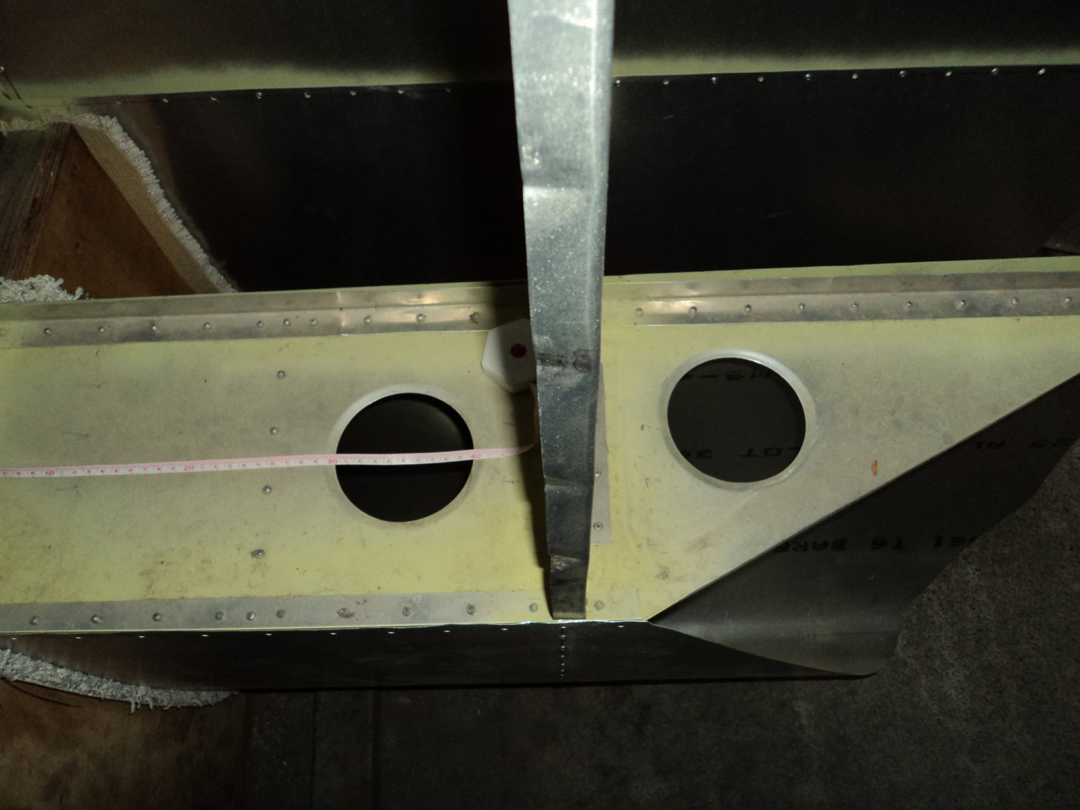

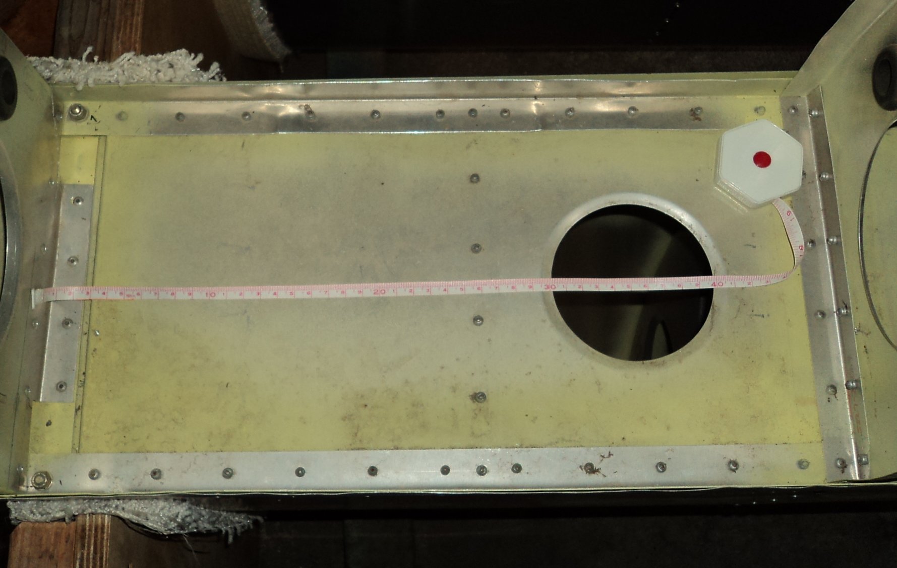

PostPosted: Fri Apr 15, 2011 3:18 pm    Post subject: Re: A Newbie from Malaysia Reply with quote
Hi Mark,
I went out to the hangar where my wings are stored to measure and photograph the lightening hole. I used a crude measuring tape in the photograph just to demonstrate the distances. (And please forgive the dirt collected in the wing while in storage.)
You can see the rivet line versus the position of the lightening hole. I suggest the 350mm dimension, but you can change this +/- 30 mm without affecting anything. Moving it 45 mm is too much. Notice how the hole would overlap the vertical "L" positioned at 250 mm from the edge of the wing spar extension.

PostPosted: Sat Apr 16, 2011 5:40 am    Post subject: Re: A Newbie from Malaysia Reply with quote
Scott,
Looks like you are right. Zenair must have updated the plans and switched the numbers around. The pieces come pre-fabricated for me, but I imagine it would tick me off if I scratch built the spar extension only to find out later that the hole was in the wrong place!
