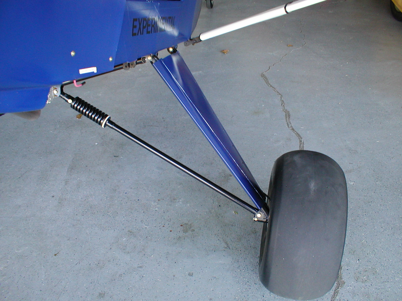

I have the same gear/tires that you do and having been running 10 lbs of air pressure in them for well over a year. That appears to be a good pressure. Get it too low and you might have a possibility of tire movement on the rim thus shearing the inflation stem.
      Dick Maddux
      Milton,Fl

On Tue, April 12, 2011 5:11 pm, Patrick Reilly wrote:
Paul, I bet I can do it with the tire on the rim. I won't drill all the way
thru the rim. I'll stop short of hitting the tire and run a sheet metal
screw thru whats left of the aluminum rim. It would be nice to see how thick
the bead is to choose what length of screw to use. I would guess 1/2" # 10
sheet metal screw would do it. I just remembered I did this on a dirt bile
years ago. But, I had drilled and measured the bead before mounting the
tire.
I'm a bit more patient in my old age having been beat up so many times by short cut
decisions. I would want the best hole location and to know exactly how thick the rim
is and the thickness of the bead at the point where the screw penetrates. Of course,
you may already know that information from working with the tires and wheels.
