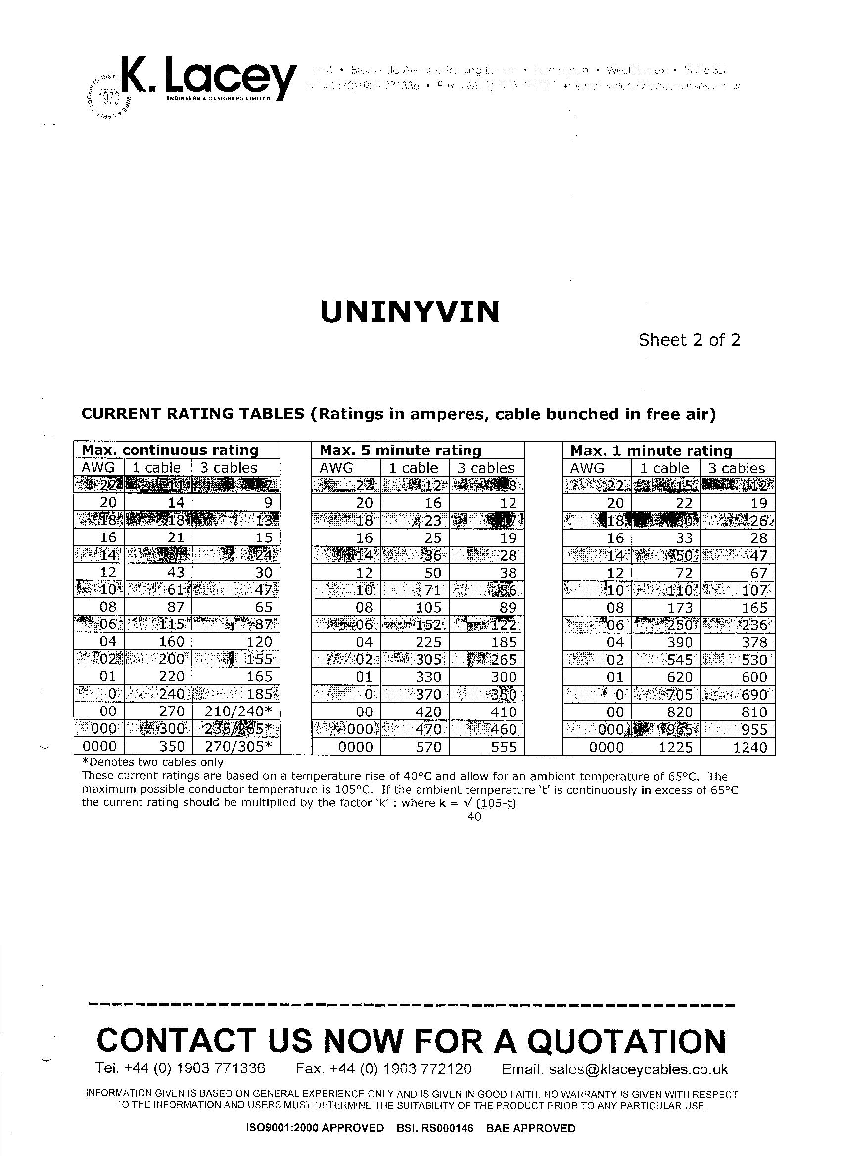

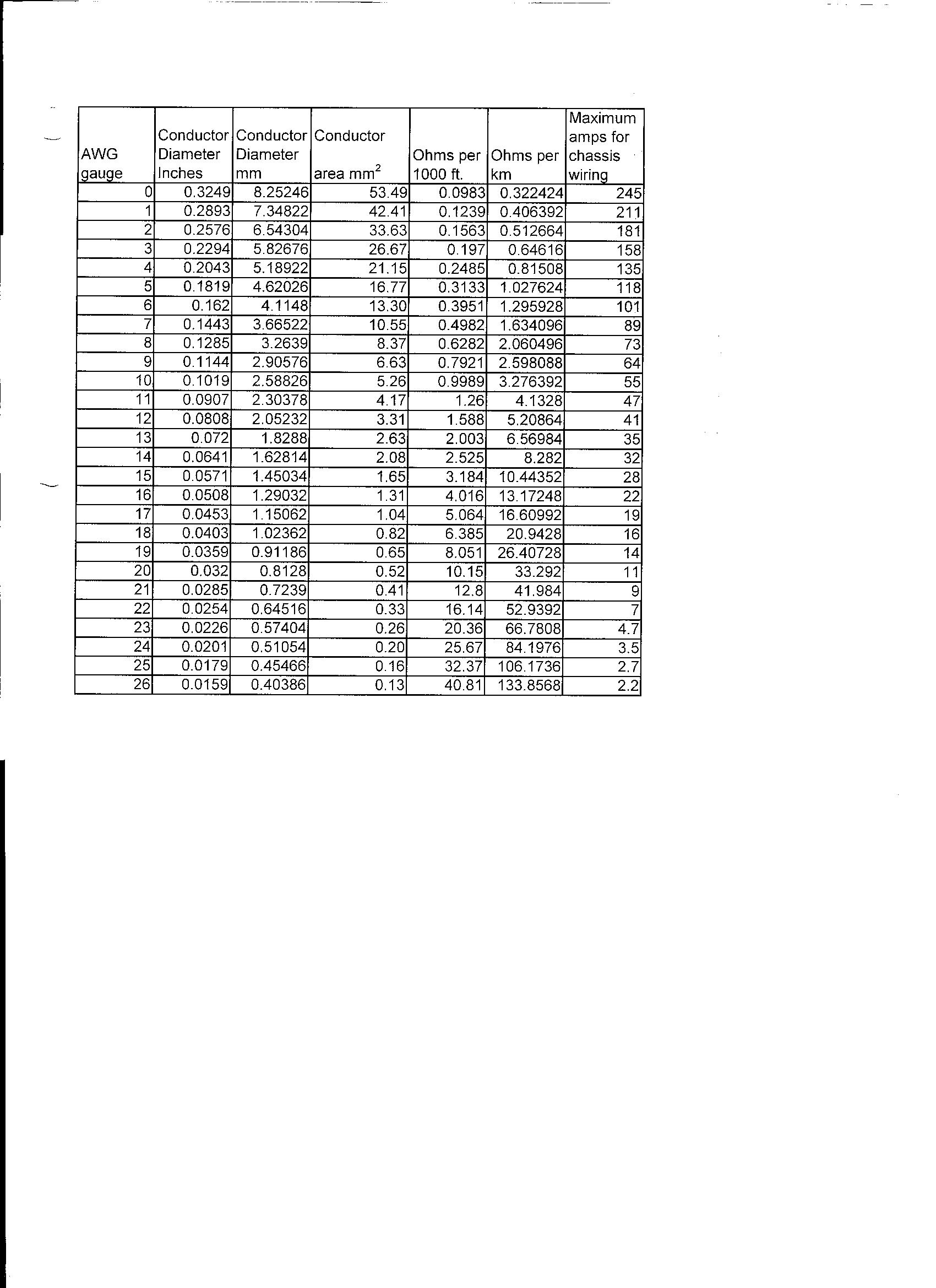

PostPosted: Tue Apr 12, 2011 12:07 am    Post subject: Wiring size ? Reply with quote
Peter
I got these two documents regarding wire capacity off the web.
David Steade
