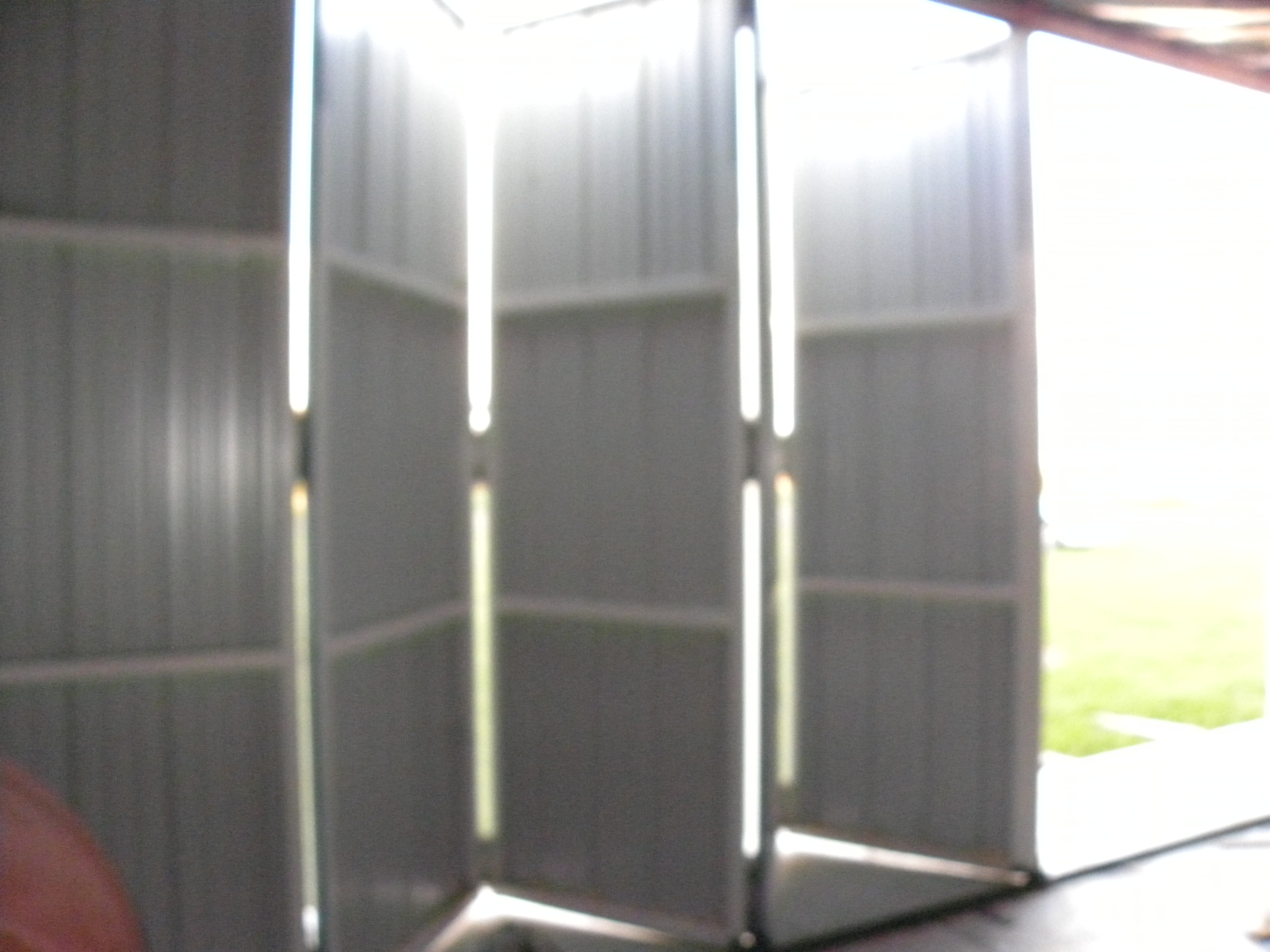

Dennis , build a folding door with equal width vertical section .Top runs in
a channel guided with nylon rollers. Bottom carries the weight on bearings
[called trucks] which ride on a 1/4 inch angle iron affixed to the concrete
slab. No electric, no ice, no maintenance.Can be opened partially. Folds
back and is hinged at the door jam , out of the way and entirely safe. Andy
in Mesa, WASH.. WN31

andysheila(at)eltopia.com
PostPosted: Mon May 02, 2011 9:00 pm    Post subject: Aircraft door preference Reply with quote
Here are some pictures. I had the steel company cut the 2" X 2" tubing to
desired lengths from banded 20 ft stock on their band saw. Welded one frame
up and used it as a pattern for the rest with C clamps. Trucks are easily
made with 6 sealed bearings each.
They run on 2, with 4 to guide. Short pieces of angle iron and short axles
easily made with a drill press and a hack saw. Hinges are steel pipe and
accommodating steel pin. If you want to be fancy you could make brass
bushings. Top hinge corresponds to the other two except it has a nylon
roller which runs inside the full length channel under the weather flashing.
Belting on the bottom keeps mice out.
3rd of series showing door frame inside. Sorry it is out of focus.

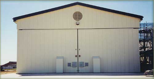

Hydro Swing requires no reinforcing of the structure,and are built to your dimensions. Only installed one,but it was quick .

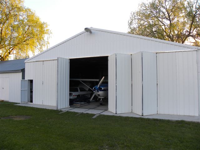

http://www.dhc-2.com/Monthan_Memories.html
Thanks Mike,
I'd call that an accordion door, much like my closet door in my house. Has some nice advantages !

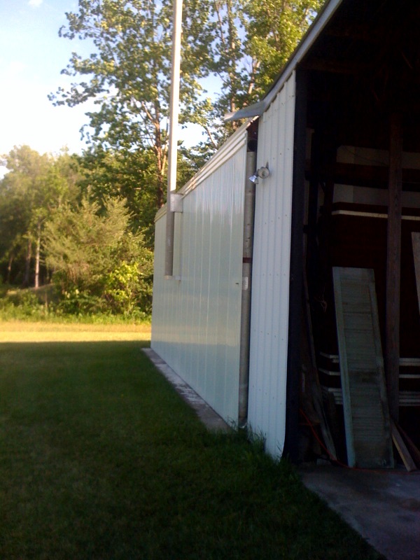

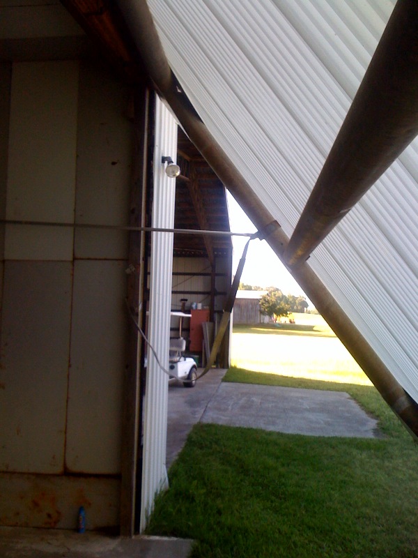

Here's what I did for a 30 foot opening, with intent to do something
similar on the 42 foot opening next to it. The tall tube is a
counterweight. It's offset in front of the door due to structural
constraints of the building. If you can put the door on the face of your
building, the counterweight(s) can be an extension of the two end
vertical members of the door itself. The hinge would be at the top edge
of the door. With a round-top building, it's much simpler to get the
counterweight arms to clear the roof. This door is constructed of 6"
aluminum irrigation tubing (kinda Kolb related, I guess...), with
aluminum gussets made from old highway signs & assembled with both
bucked rivets & pulled rivets. Skin is 'SunTuff' from Home Depot; lots
of natural light in the day time. The door weighs around 500-600 lbs, &
the bare frame was light enough for 2 people to tilt it up in place for
hinge attachment.
It takes about a 20-30 lb push to start it opening. If you build one
with the weights as extended verticals, it would take much less to get
it moving. The horizontal bar is manually pinned when the door is fully
open to keep it from acting like a kite in the wind.
Charlie

I PUT A 40 FOOT HYDROSWING DOOR ON MY 45 FOOT QUANSET HUT , IT WAS SELF SUPPORTING AND THE MOST PLEASURABLE PART OF THE HANGER THE DOOR IS BEAUTIFUL EVERYTHING RIGHT DOWN TO THE HYDRAULICS WAS PERFECT IT WORKS GREAT ---NOT CHEAP BUT PERFECT---- IHOPE THE RUMER ABOUT THEM GOING UNDER IS NOT TRUE THEY ARE A GREAT BUNCH OF PROPLE.
