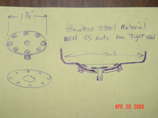

Hey Guys,
I'm going to make a couple fittings for the bottom of my fuel tanks...
( see "rough" sketch below )
The two pieces of Stainless steel will be concaved to make a low point
in the tanks... this way I can put a gasolator and drain and fuel pick-up at the lowest point of the tanks ( I might add a "site gauge" too )
My question is...
What are some good Gasket materials....Both Hard & soft ?
Gotta Fly...
Mike in MN

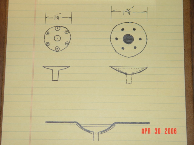

Posted: Sun Apr 30, 2006 5:30 am Post subject: Re: Fuel Tank Gasket Material ? |
I've revised my sketch...I'm thinking of making the "inside piece" slightly
smaller to force the curve a little better....
I'm thinking of going with "thicker" material and just tapping the holes
instead of welding nuts on (TIG)
Gasket seal ????? Hard , soft , silicone stuff ???
Gotta Fly...
Mike in MN

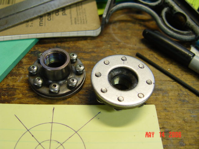

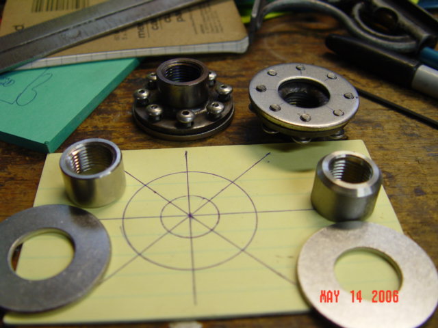

Posted: Sun May 14, 2006 11:29 am Post subject: Re: Fuel Tank Gasket Material ? |
Hey Guys,
Here's a few pictures of what I've got so far....
I didn't like the way the concave seal was turning out...
So I went for flat Washers.... I'm gonna "groove" them later to get the
Fuel pick-up as low as possible....
I also went with 8 screws instead of 6....
BUT.... I "STILL" am looking for some kind of gasket material that can be
used with gasoline.....The Silicones that I've read say "NO Gasoline"
I'm wondering about cork....?
Well,
Here's a few pictures...
Gotta Fly...
Mike in MN

planecrazzzy Guest
Posted: Sun May 14, 2006 3:00 pm Post subject: Re: Fuel Tank Gasket Material ? |
| John Hauck wrote: | |
It is a very simple metal elbow and a neoprene washer that pushes into
a hole drilled into the bottom of the plastic tank. They work very
well, last for years.
mkIII |
Hi John,
Those fittings were talked about before....what we didn't like about them is they don't drain "all" the fuel / water / debris ...
They stick up from the bottom of the tank aprox 3/8"
I'd rather just put a gasotator on to filter and Drain/Check the fuel/water....without anything accumulating in the tanks....
Gotta Fly...
Mike
