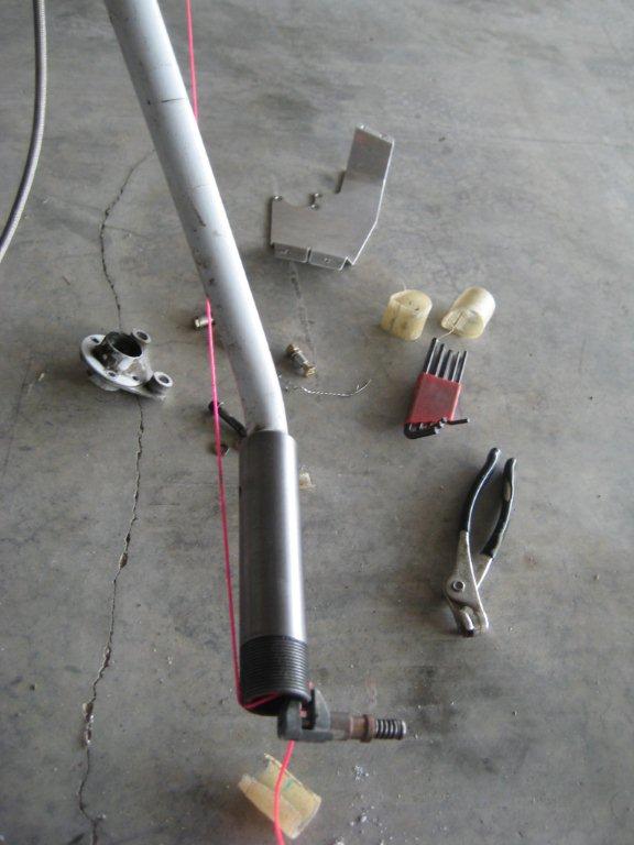

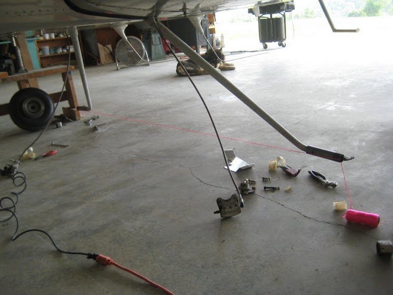

Upon further investigation and inquiry our toe in situation is profound. We pulled off all the items hung on the gear to take accurate measurements. It turns out there is a 1" over 14" toe in angle/measurement equating to a 4 degree toe in position. Vans calls for no more than 1/2 degree toe in angle/measurement. As we purchased the 8A kit partially built (on it's legs) we then assumed the legs were transposed. Upon pulling off one leg to visualize how it would be reversed we realized that swapping the legs would place the wheels at extreme angles so that was not a possibility. After speaking to Vans (prior to pulling the gear leg) they told us the 7A, 8A & 9A legs are definitely different in geometry. The only thing I can think of at this point is that we have the wrong gear legs for our model. I do not like the idea of re-drilling the gear legs because of how difficult they are to drill and because the offset to the current hole would only be 4 degrees making for an even more challenging machining exercise. We will be calling Vans again later today to discuss.
Photos attached...
Robin

I built an 8 before and am working on a 7 now.  I noticed the same thing when I put the 7 on it's gear a couple months ago.  I concluded it was just the nature of the wittman style gear.  As they take loads from 0 to 2000+ pounds, they sweep out and back.  Staying aligned during this range of operation is impossible.  The bar-type gear on the 8 only flexes out -- making alignment more reasonable.

I've concluded its the nature of the design and there is no practical way to adjust it. I have not measured toe-in on my 8A (quick build), but I do know it is there.
My plane tracks well, but I do see much more tire wear than I would expect. I watch tire wear closely, rotate tires as needed, and just figure on buying more tires than other aircraft I've owned in the past.
