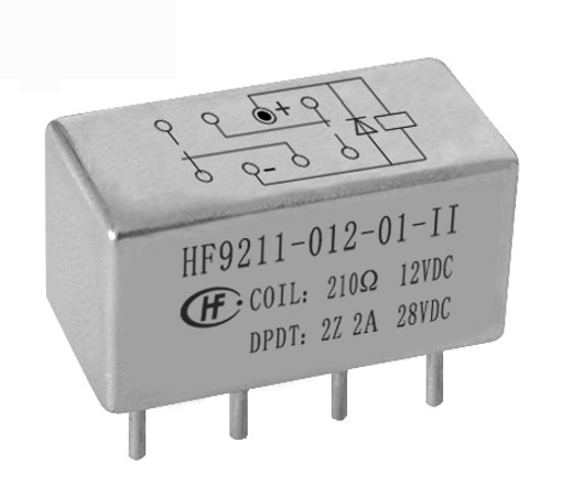

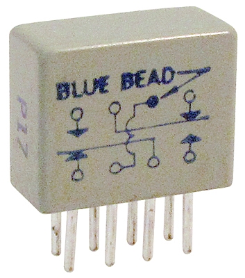

At 08:57 PM 6/26/2011, you wrote:
| Quote: | Bevan;
MOST small relays are NOT polarity sensitive. For the most part, the only ones that are, are the ones containing spike suppression diodes or LED indicators. The relay coil itself doesn’t care about polarity.
The B&C relays are most likely generic basic relays without any sort of diodes such as the ones linked to by John at the start of this thread.
Correct. The only relay I used to sell that did
have the built in diode was a starter contactor . . .
and it was available either way. There was some
notation like 'coil suppression' stamped on the
bottom of the one with a diode.
I'm aware of no relays other than mil-spec devices
and a few 'upper crust' industrial relays that
commonly sport the built in suppression.
[img]cid:.0[/img]
This one clearly does not . . .
[img]cid:.1[/img]
While the schematic on the enclosure for this one shows
a diode and clear (+) mark for the coil polarity.
If the relay you have in hand DOES include coil
suppression, then it will be clearly marked as such
in some manner on the outside. Otherwise, relay
coils are not polarity sensitive.
