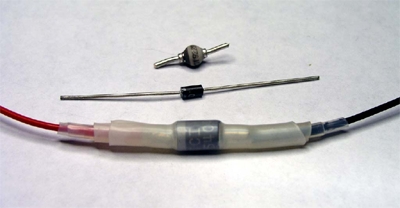

Like this?
[img]cid:7.1.0.9.0.20110627093341.02040838(at)aeroelectric.com.0[/img]
See: http://www.aeroelectric.com/articles/Homeless/Homeless_Components.htm
I began to wonder how much heat would be generated and if I need to protect this from other wires. I wouldn't think there would be much heat since there is little current in a sensor.
Correct. If there's a reason for selecting larger
than necessary for electrical performance, it's for
mechanical robustness. Consider 1/2 watt resistors
for this task.

Just finished a similar install on a Dynon D180 and Rotax with multiple resistors for current loop sensors.   Choose a point in-line for the resistors that you can mechanically support the wire bundle.  Trim the resistor leads to about 1/2" slip multiple layers of heat shrink tubing onto the wires before assembly if unable to add heatshrink post assembly.   I soldered all connections.  Heatshrink tubing over each resistor, then bundle and larger heatshrink tubing.  Be sure to extend the heatshrink tubing 1" or further  beyond the connection for mechanical support.   The current the resistors is limiting is in the 10s of milliamps range and thus almost no power (heat) is dissapated.
