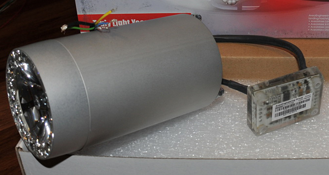

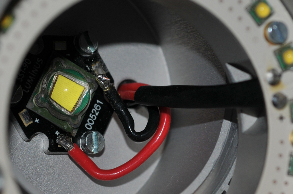

I have a tiny soldering job to do because the return wire shown in the photo has separated from the LED solder tab. The LED OEM (Luminus) data sheet says that the used and spare cathode (just visible at the top of the LED base) are interconnected, but there would be more strain on the main wire to reach the spare solder tab. Perhaps a small jumper between the first and second cathode (and same for the anodes) would be smart too, but I need to re-attach the wire without damaging the LED. I have some ideas about how to provide strain relief and protection for the wires Bob, but what do you think is the best way to prepare and re-solder to this tiny solder tab, which is only about 1/16 x 1/8" in size? For reference, the screws are M3.

What AWG are these wires? How much current does
the LED draw?
The first idea that comes to mind is replacing the
wires with smaller gage still sufficient to the
current. I'd bet you can go down to 24 or perhaps
26AWG. Remove all the existing 'fat' wires and
bring smaller leads to the outside of the enclosure.
Use some form of adhesive/sealant to secure the wires
as they pass through the housing.
Once in the more robust, outside world, figure out
some form of connector . . . or perhaps splice to
more robust leads and secure the joint mechanically
under a band-clamp.
You need a soldering iron with a small tip and some
63/37 solder. I'd clean off the pads with a piece
of solder-wick, re-tin the pads with small dots of
solder. Tin the ends of wires to be attached. Then
'tack' the wires onto the pads.

If that's a MCPCB (metal core printed circuit bard, typically aluminum) you will need to preheat the board (and LED) on a hot plate to properly solder to the pad.  Without heating the board you will never get the solder to flow on the pad.  At work we build hundreds of these type of LED assemblies.  We set our hotplate to 150° C and use 63/37 Pb/Sn solder.  Place the MCPCB on the hotplate.  Place a small piece of solder on the pad.  Bring the tinned wire and soldering iron tip in contact with the pad.  The solder should flow freely.  Remove the solder iron and the solder should re-solidify on the pad with the wire embedded. Remove the assembly from the hotplate.

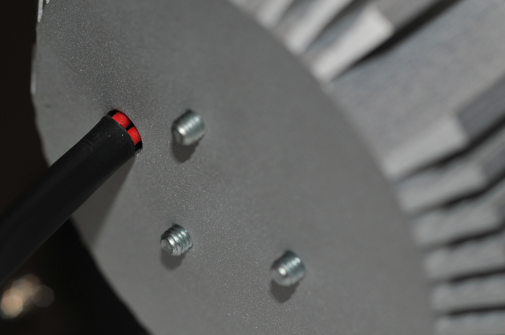

Yes, I reckon the wires are about 16 AWG and the current draw is said to be about 3.15A for the landing light part of the new AveoMaxx 6-in-1. I would return it for repair under warranty, but Aveo voided that because I removed three screws holding the front lens in place. I was trying to look for an obvious fault and also see how the 'beam angle adjustment' works, but there is none. After exiting the body, the wires are soldered to the control circuit board, which is embedded in epoxy. I'll put some thought into how to heat the board as Chris suggested and give it a go. Mouser Electronics sell the LEDS for about $50 each if I screw it up.
Cheers, Stu

Okay, you can drop the wire to 22AWG and make the job
MUCH easier. To have come from the factory with such
fat wire is mystifying . . .
Okay, you've not bounded your risks. $50 + time to
do the experiment is not the upper limit . . .
if you 'screw it up' it may be because you don't
have the tools and techniques which the factory does
have. An out-of-warranty repair might be cheaper
than a new LED assy and the risks for lack of
tools and process go to zero.
I'd sure talk to the factory first . . . and ask
them, "why 16AWG lead wires?" in a 5A or less
circuit.
