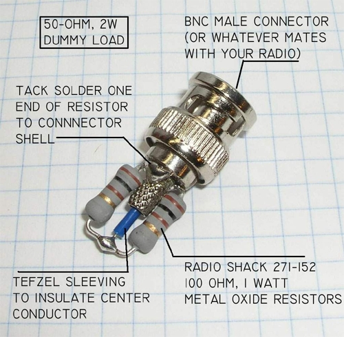

Build one of these from RadioShack parts:
[img]cid:.0[/img]
Stick it on the back of your comm transceiver in place
of the antenna coax. See if the 'buzz' goes away. Keep
the test transmissions short . . . a few seconds. This
load is only good for 2W continuous so your transceiver's
output represents an potential 'overload' condition but
short test transmissions wont hurt it.
If the noise goes away, then quality of the feedline
and antenna system is suspect. It could be a poorly
installed connector at the transceiver end, at some
intermediate joint, or the antenna end. The fact that
you have a DIY antenna is not an automatic recipe for
failure but it does put some extra-ordinary requirements
on the fabricator for quality of the made-up joints.

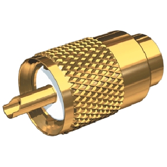

You could fabricate an antenna using one of these
coax-connector-to-rod adapters that are common to
the CB radio accessories market. One such article is
Radio Shack 219-0961
[img]cid:.1[/img]
This product is designed to accept the PL-259
"UHF" style connector and an antenna rod fitted
with a 3/8-24 threaded end. Note that this product
comes with an internal tooth star washer to
effect good electrical connection between coax
shield and the aircraft skin. This washer needs
to be exactly centered in the final make up of
the joint.

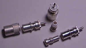

You'll also need a step-down adapter
[img]cid:.3[/img]
to mate the smaller RG-400 style coax with the
larger connector.

PostPosted: Thu Jul 07, 2011 6:08 pm    Post subject: PTT buzz Reply with quote
At 08:16 PM 7/7/2011, you wrote:
<dan(at)azshowersolutions.com>
ok...the saga continues. AFter getting home today I disconnected the
coax from behind the SL40 and attached the rubber anntenna off of my
HT. The sound is different...it is no longer a buzz but it sounds as
if it is turning itself on and off when the PTT is depressed...a
pulse of sorts approx two cycles per second. Some have e-mailed and
said to try turning the squelch down...check. I was also told to
turn the side tone to zero...check. no luck so far. So it seems to
possibly be either in the radio or a mis-guided wire going to the
intercom. Double checking wires tomorrow. Throw out the ideas if you get one.
Thanks, Dan
This is not a meaningful test. A rubber duck is a RADIATING
device that floods the wiring behind the panel with RF
energy. If the feedline is radiating due to bad termination,
then the symptoms you're seeing may well be indiciative of
a cockpit flooded with RF. Changing the radiator from a bad
coax to an antenna mounted right to the back of the radio
is not likely to yield useful information.
You need to do the dummy load thing first.
PostPosted: Sat Jul 09, 2011 6:01 am    Post subject: PTT buzz Reply with quote
I built the dummy load as per Bob's direction, removed the coax from the back of the radio and installed the dummy BNC...turned things on, hit PTT...no joy. I still get the buzz. Now, that means this primary culpret is within my system. Either between my radio (SL40), my intercom
(PM 1000 II), or the Approach Fast Stack (http://approachfaststack.com/) hub that interfaces the two. Another potential goober could be with my wire runs to the headset jacks. Approach did a nice job of these using shielded wires, however, they were too short (my bad guestimate)as my termination point is behind the co-pilot. I ended up splicing these wires using a Cat-5 wire bundle to the termination point.
I was quite careful when doing this splice, however, I wonder if the lack of shielded wires could be hurting me. Any thoughts of where to start would be welcome.
Dan B

dalamphere(at)comcast.net
PostPosted: Sat Jul 09, 2011 6:47 am    Post subject: PTT buzz Reply with quote
Dan,
This may be totally unuseful, but if you have the aux jacks installed
between the PS1000 (per PS's instructions) and radio, have you tried
disconnecting the intercom and plugging your headset and mike jacks into
those and tried the same experiment (with the dummy load)??
FWIW
Dave
PostPosted: Sat Jul 09, 2011 9:08 am    Post subject: PTT buzz Reply with quote
Okay, good data.
Describe the "buzz" . . . what does it sound like?
Dan B
